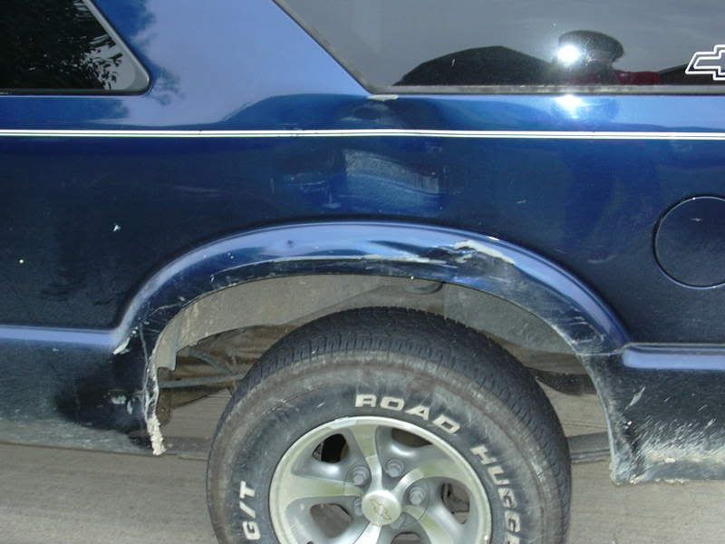

I was backed into and didn't get money out of it. I'm trying to find a good price range to get this fixed at. Apparently the whole panel needs to be replaced and whatnot. Everyone/everywhere I go to is saying it'll be at least probably 1500$ to get it fixed...
What do you all think?

i could save that ****er in less time and work than replacing it.....
now if you WANT to pay for OR you demand a new panel then fine.....
BUT if a bodyshop says it can't be repaired,then take your business elsewhere....
i can look up a quick number for replacing it....give me a few
drunk and bored
31,626 Posts
outer 1/4---$500
rear pillar extension----$13
16.5 hrs labor x $50(of which does not include r&r glass or tail light
refinish(no blending) no jambs-both of which need done---4 hrs x$76
$513
$825
$304
$1642 + tax is your baseline estimate......you should be looking close to $2400 to tear down the door and gate and pull all glass etc. to have it done properly

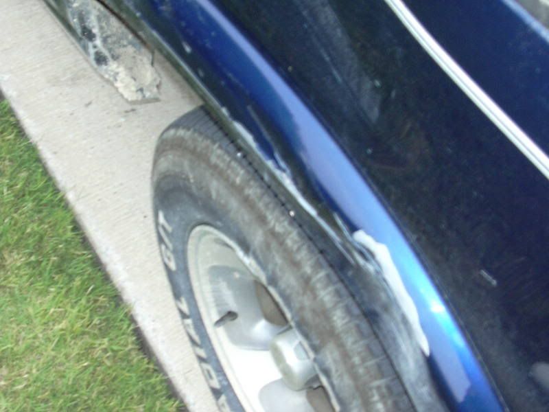

From the pictures it looks like it would be a repair at my shop. Some shops are simply just parts replacers and don't have experienced body techs that could easily handle that repair.

it does look more of a swipe than a 'backed into'
what to do?
find a quality bodyshop that will fix it and guarantee it!
or bring it to me.....:haha:
i'm stuck on indigo projects with more coming up why not add another down the road
drunk and bored
31,626 Posts
i'd ballpark it at $11-1200 to straighten and paint that 1/4.....alot of work,and you have to be good to do it...but that is more than fair
