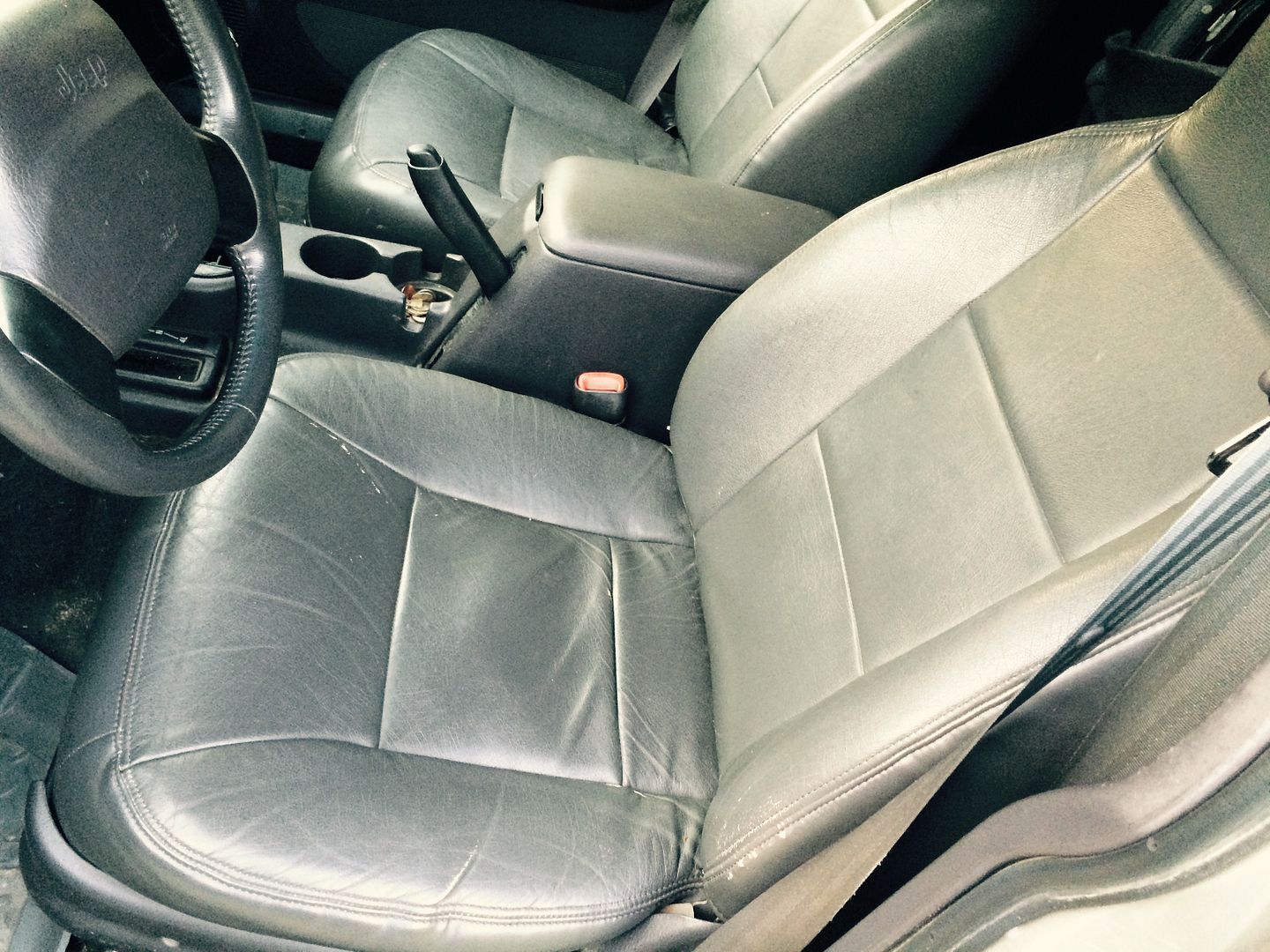

There are no cracks or rips in the leather:

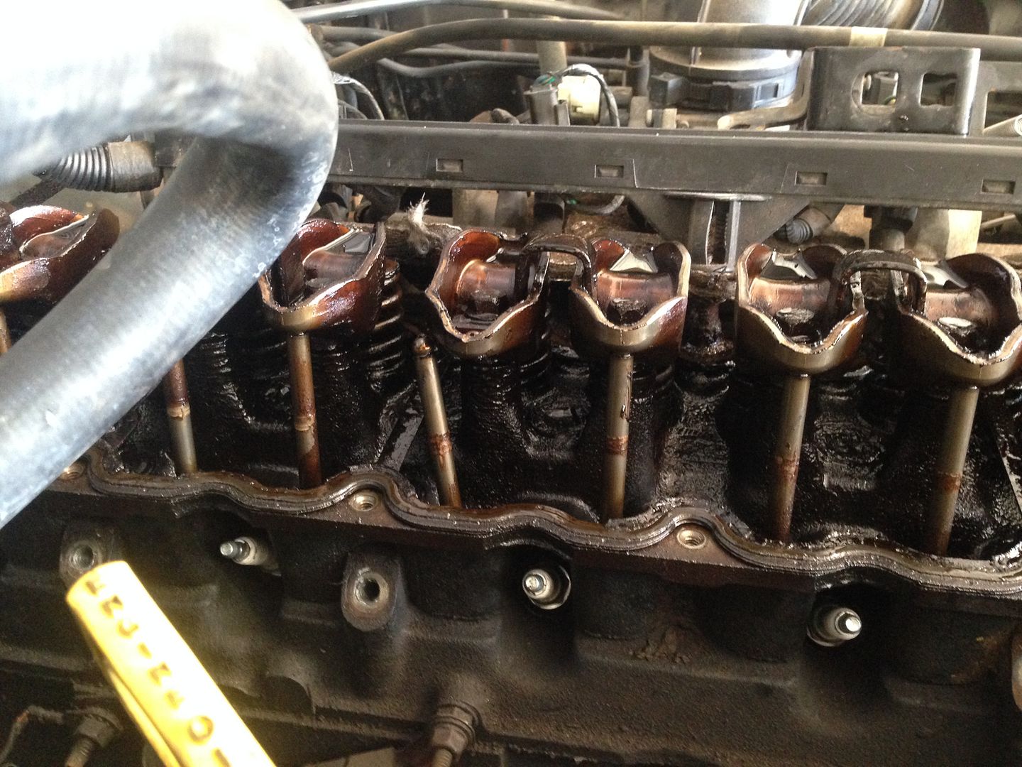

#4 intake pushrod just laying to the side. The rocker bolts were still torqued down and the pushrod wasn't bent. I unbolted the rockers, positioned the pushrod, then reinstalled the rockers. I ran fired it up with the valve cover off to watch it. The engine was now hitting on all 6 and idled so smoothly that I could barely tell it was running. My best guess is that during that time period it just sat, the oil drained from the lifters. When the guy finally started it, that one lifter was too slow to pump up and the rod fell out. Regardless, it's getting a set of new lifters. That's not the main concern, though. After reading up on these 331 heads being so prone to cracking around the #3 and #4 cylinders, I began inspecting it closely. It wasn't hard at all for me to find an expected crack:
(CLICK IMAGE FOR VIDEO)
I apologize if the vid quality is crappy. Photobucket has gotten bad lately. But, near the base of that rocker tower, you can see drops of coolant forming from the crack and running down into the oil flow. I'm hoping this amount isn't enough to have done any damage. The oil is dirty but not milky. I'm hoping that it hasn't been doing this for very long and that most of the coolant is burning off instead of mixing with and diluting the oil. At this point, I'm feeling pretty confident that I can just clean the block of the sludge, replace the lifters, slap on a new aftermarket or rebuilt TUPY head, and continue on for another 100K miles. We shall see...
