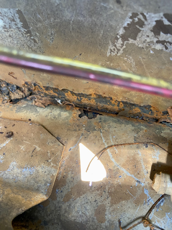

The door isn’t nearly as rotted as I expected, considering the entire bottom 4” is patched over.
Just one small hole that I could see.
