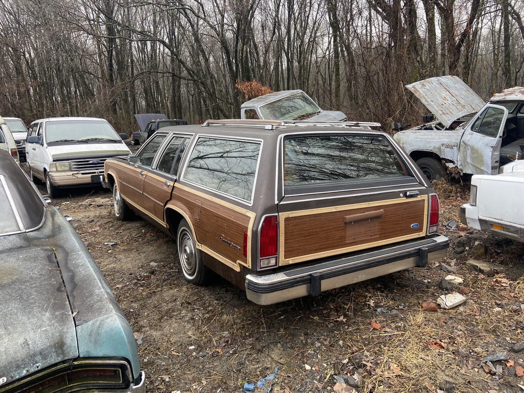

So, I saved another 80’s shitbox from the junkyard. Found this 85 Country Squire a couple days before Christmas at the same local yard I found my Blazer several years ago.

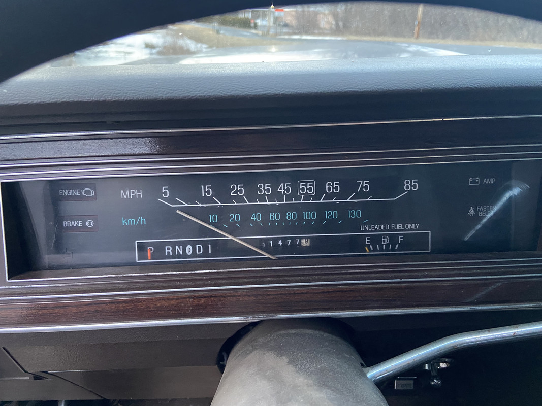

91k miles.

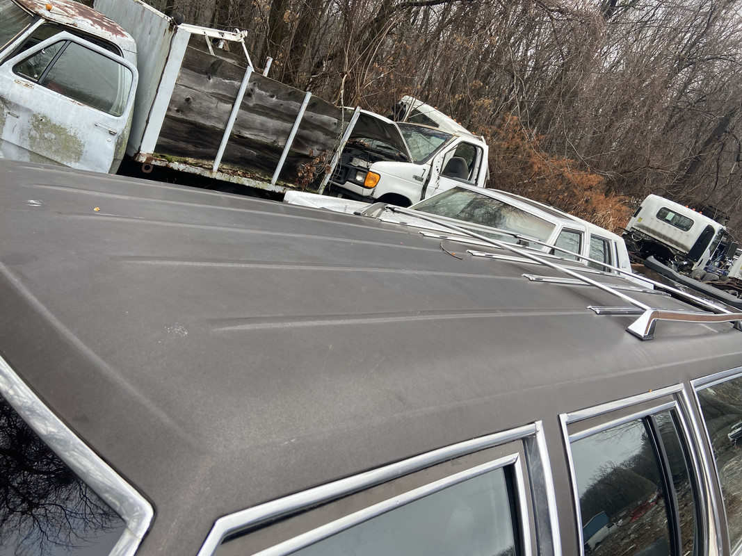

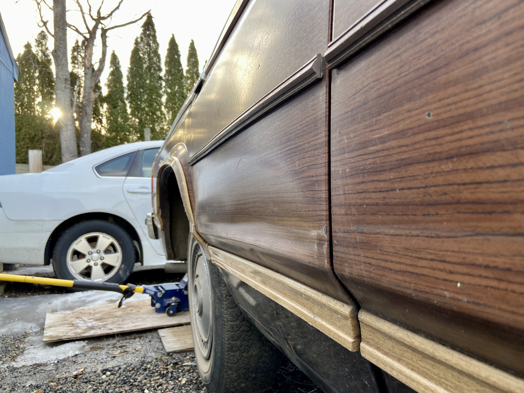

Fenders have some rot, and there’s a couple dents in the rear doors, but otherwise the body and paint are really nice. Just needs a good buffing.

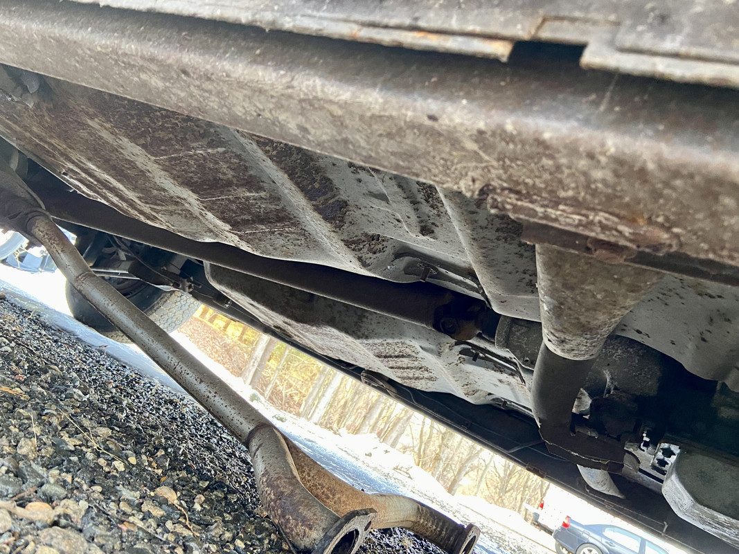

Undercarriage is extremely clean.

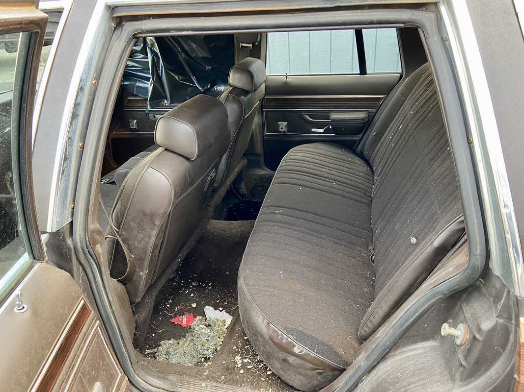

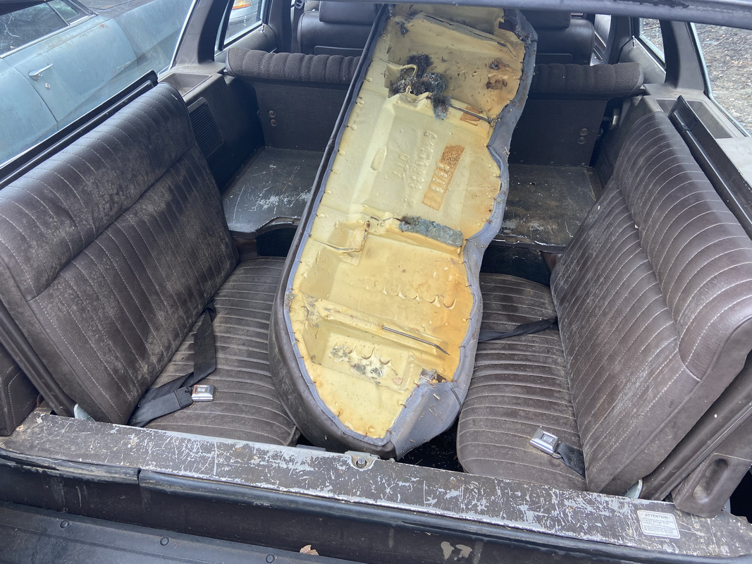

Interior is a mouse sanctuary. But aside from the turds and nesting everywhere, it’s in really nice shape.
Enough room to seat me and 7 of my closest friends. I don’t have 7 friends.

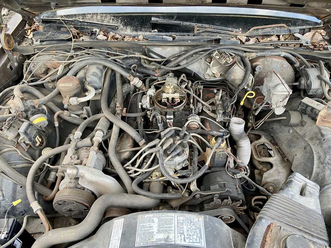

This car is very complete and very, very original. TBI 302, AOD trans, with a 3.08 open diff.
Every sensor, switch and module under the hood has the old Motorcraft logo and/or an original Ford part # on it.
Only missing the spare tire and the converters that the yard cut off for scrap. Needs a fuel pump/pumps to run. Apparently this system uses a low and a high pressure pump. I could only find the one in the tank. With just a new battery, and not touching anything else, it’ll run off starting fluid.

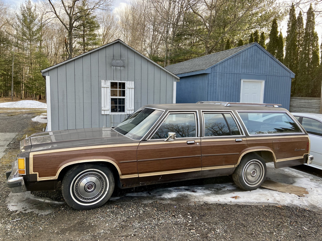

Me too. I’ve wanted a 70’s to 90’s full or midsize wagon for years. A G body would’ve been ideal, but those are starting to go for crazy $$. I just happened to stumble upon this one. The yard is only a couple miles from work, and my boss is cool with me keeping and working on it there. That’s really the only reason I was able to buy it. If I brought it home, I would be sleeping in it. But, unfortunately this does mean once it’s on the road, I’m getting rid of the Blazer.

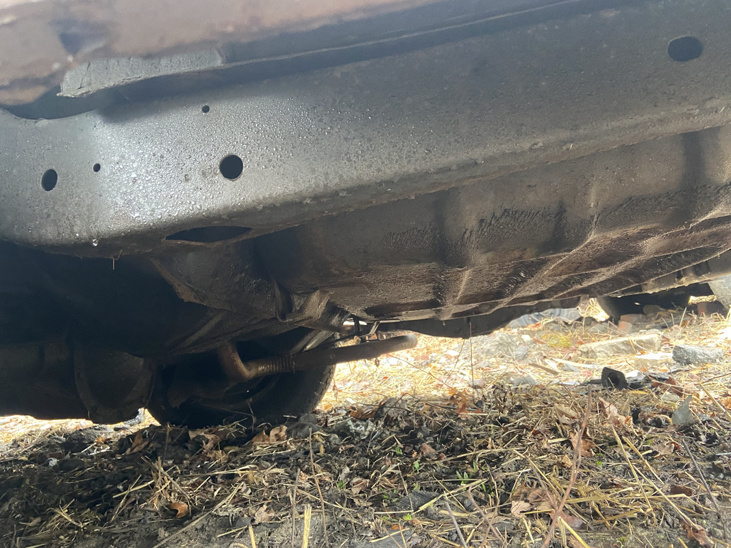

So. Rusty.
Got my friend at NAPA tracking down a new tank. Hopefully early next week. This car doesn’t actually have two fuel pumps, like the interwebs said. But, neither of the ones I ordered is correct. NAPA can get the right one for tomorrow, but I’ll have to clean up and reuse the carrier. The fuel level sender is also garbage, but it basically no longer exists. I haven’t pulled it from the tank yet, but I’ll see if it might clean up and work.

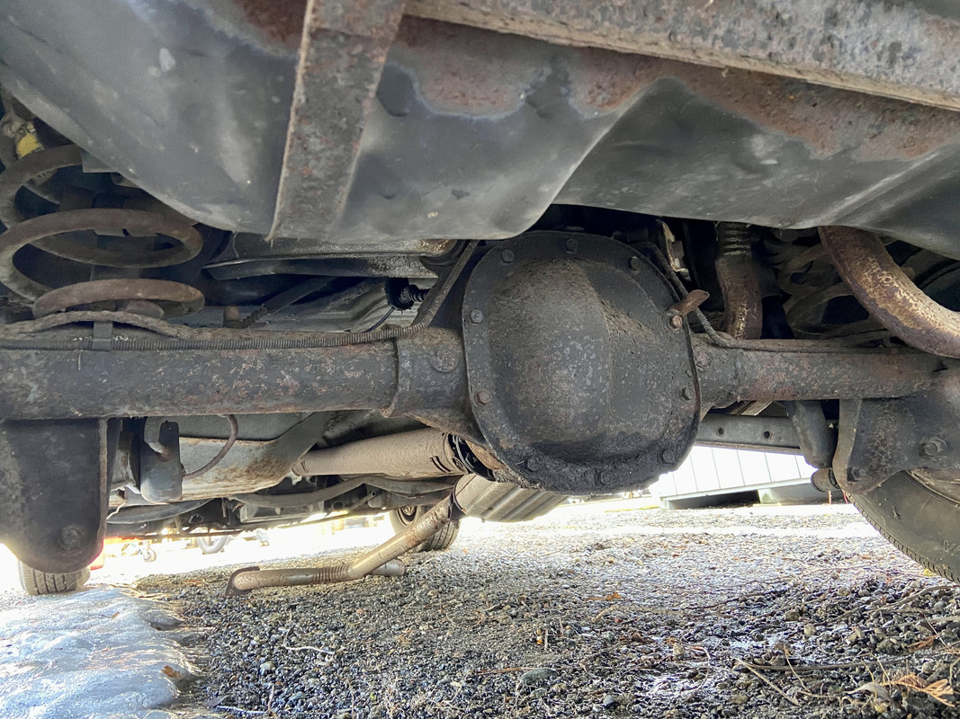

Both front door bottoms are made of riveted on aluminum flashing, slathered in body filler. But look at that frame!
You can see the rear swaybar mounting holes in the lower trailing arm, so obviously that’ll be getting added soon.
