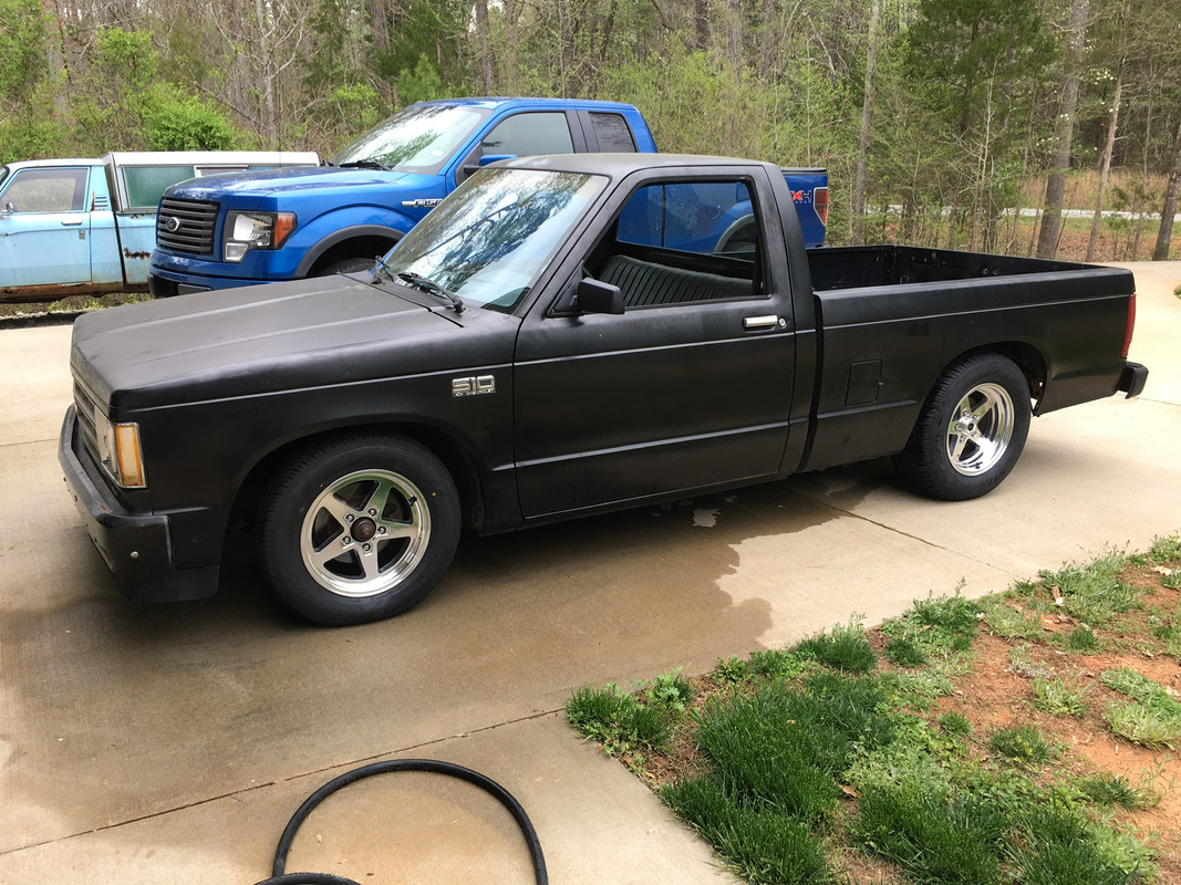

It’s been a while since I posted, been pretty busy lately. In my original post with this truck last year I indicated that I was going to put a twin turbo’d 3.8 Buick in it, but I have since abandoned that idea because I decided that it was just gay, so I went ahead and put a small block Chevrolet in it instead. So glad that I did! The engine is a 317 ci SBC with a nice little cam in it with a TH 350 behind it with a nice shift kit in it. Right now it still has the stock rear end with the 3.08 gear. I have acquired a 3.42 gear set and a posi traction unit that I am going to put in it very soon. This thing is a blast to drive. I lowered the front end by cutting the springs, right now it’s sitting on the bump stops. I do intend to put some drop spindles and some new springs on it, but I just haven’t gotten there yet. In the back I removed two leafs from each spring and then added a 1 inch block and I also fabricated some traction bars that weld directly to the lower spring plates. The traction bars made a tremendous difference in the way this thing drives.

Looks pretty nice from here.
If it makes you happy... nothing else matters Dood.
These trucks can be a blast to drive with a little more bag under the hood.
Looks like you have that cornered pretty well! (y)
Traction bars make a HUGE difference. No more axle hop.
Nice fab work.
Nice wheels too.

Thanks. It does run very well, it’s quite a bit faster than I expected it would be. I have built lots and lots of small block Chevrolet’s over the years and in my best estimate I think this one is probably making somewhere around 250 to 275 hp. It doesn’t have anything down low but it really comes on strong around 3500 rpm or so. It’ll surprise ya.
