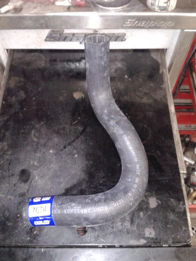

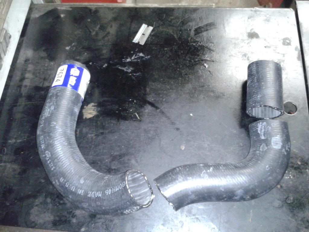

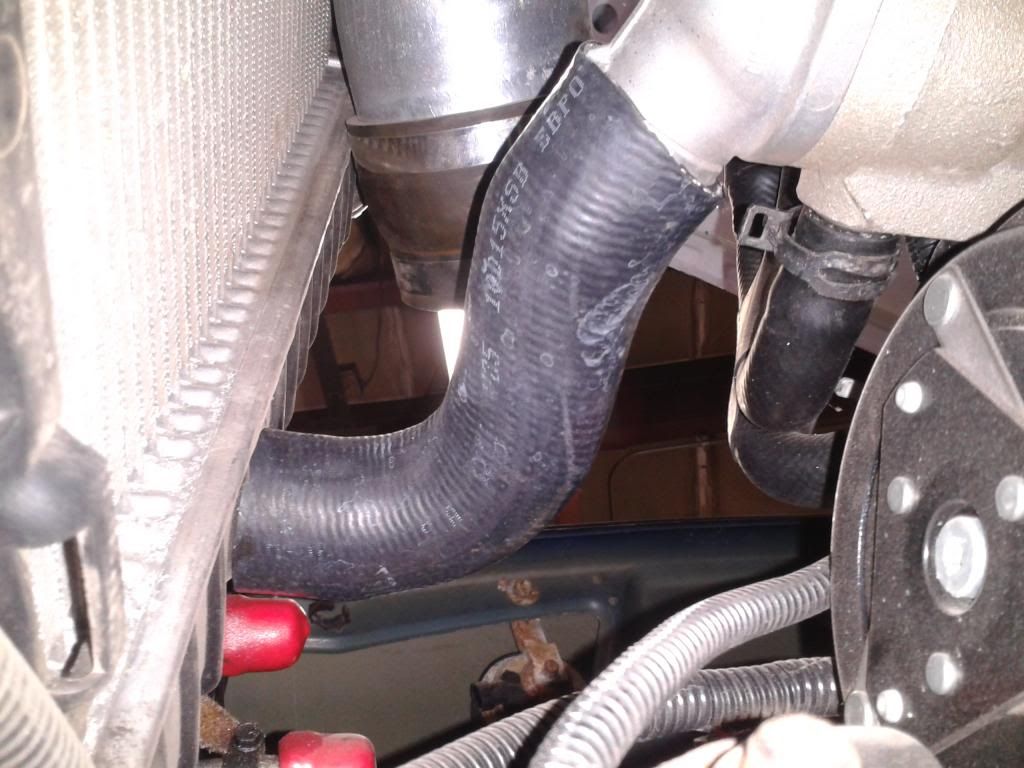

I have wondered alot which lower radiator hose I can use if I used a stock 4.3 radiator. Well, with complete access to Napa and the line of hoses they have, I grabed a few hoses and found ne that works. The Napa part number is 7674. It is a lower hose from a 70's slant six Dodge truck. I cut out what I needed. Worked awsome. Used some stock spring clamps, and everything fits great with the stock 4.3 radiator and stock LS thermostat housing. Ceck out the pics below. Figured thi would help out with some trying to plumb things up.

Thanks for the info. I have a Griffin radiator with the outlet close to where it is on the stock Blazer, and a corvette water pump. Cutting a section from pn 7674 like what you did worked perfect. I tried another mfg part number first that was supposed to be equivalent, but it did not work very well, so the NAPA hose is the one to use. (Suggest starting long and working your way down to the perfect fit. My mock up taped together from other pieces fit but was actually a bit shorter than the piece I ended up with out of the 7674).

Here is a photo to go with the post above ^^^ my radiator is moved forward from stock position, so I used a longer section (with only one cut required) from the Napa 7674 hose than you did with the 4.3 radiator, but the bends were perfect for this application too. So, thanks again you saved me a lot of time with further searching for a hose, just wish I found your post before I wasted 2 hrs at Napa and Autozone with helpful guys but no results.
