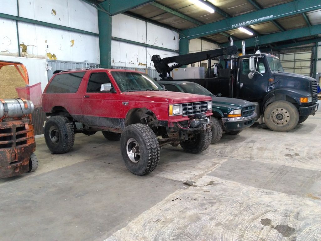

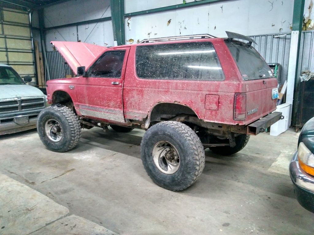

Maybe you can fix it like an off-roader, rather than playing with sheetmetal cut the rust out and get some thick plate and angle iron and weld it as 'armour'
Use something like panel bond in any place where the thick plate meets the thin sheet metal to seal out moisture rather than trying to weld the 2 thicknesses together.
450 Posts
The plan is to ditch the blazer body and swap a reg cab on and build a truggy. I know as soon as I fixed this body I'll drag it along a tree or rock.
