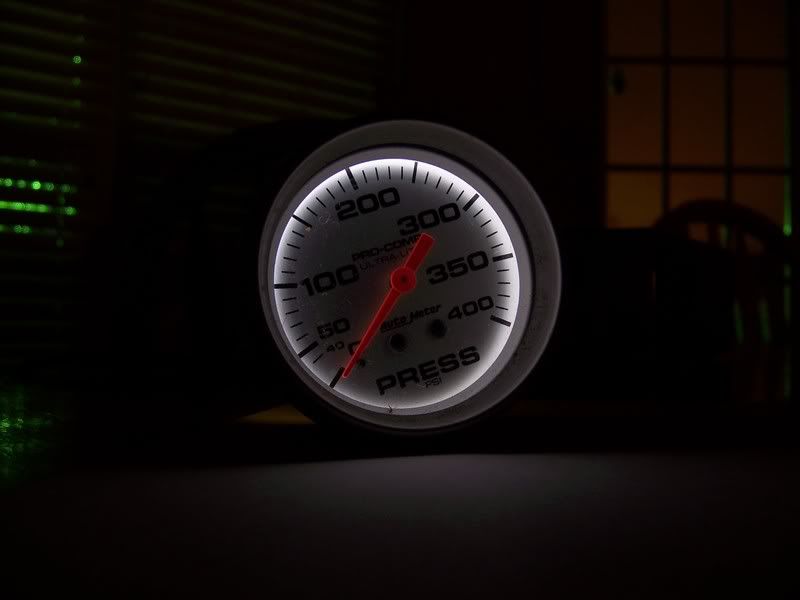

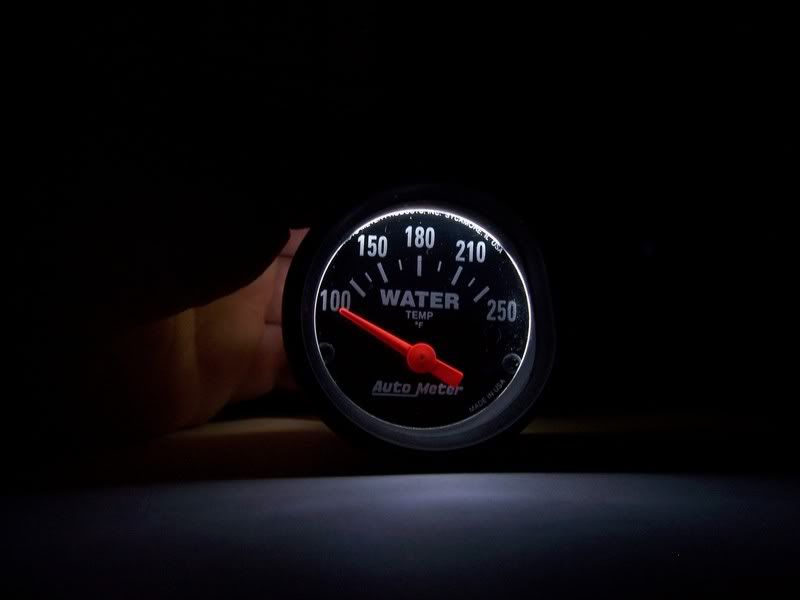

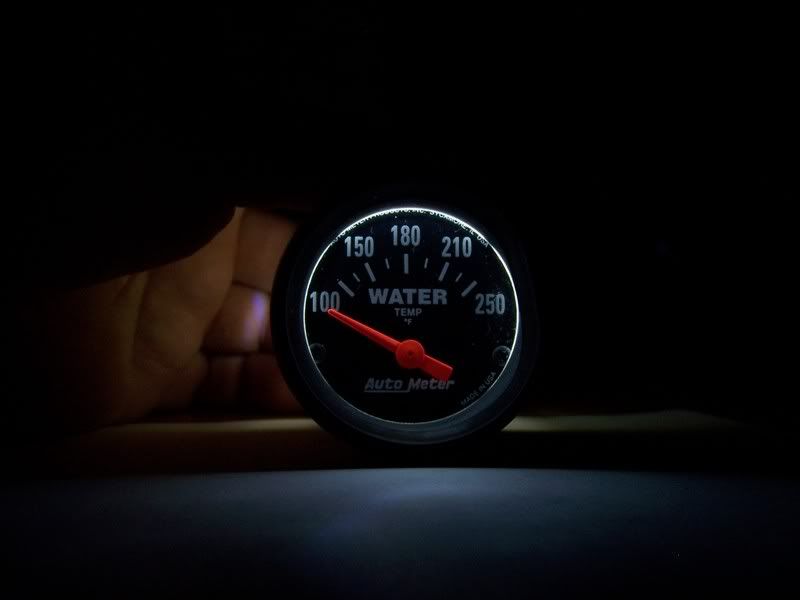

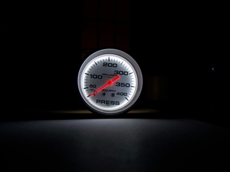

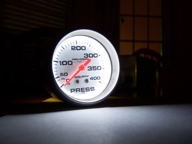

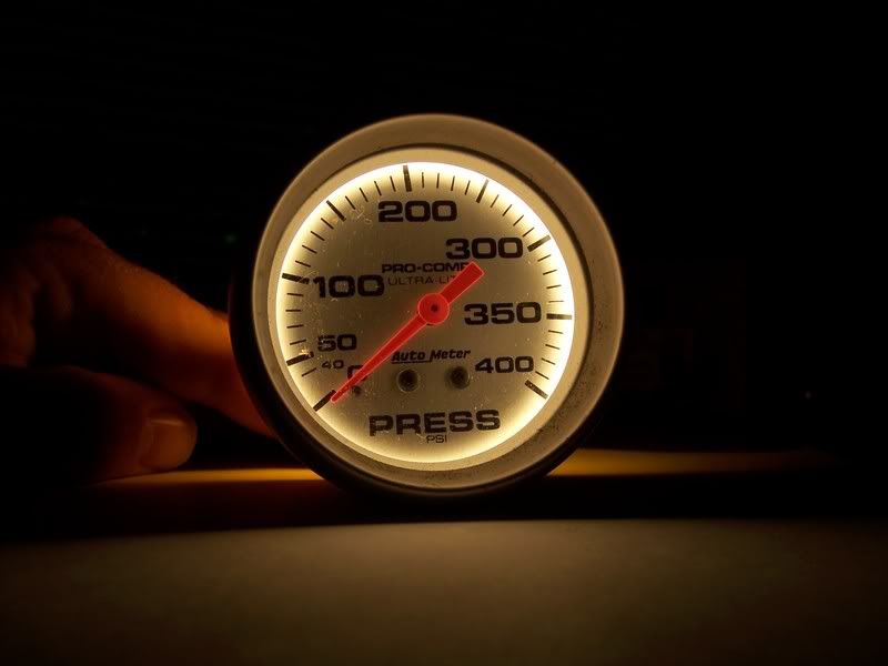

i have a few different led bulbs and i figured i would do some real world testing in gauges...i also am in touch with a company that sells led bulbs and i should be receiving a good amount of bulbs to show you guys what they look like in different lenses and gauges so you can pick the one you like best...instead of guessing what they look like.
so first test is in a auto-meter pressure gauge...
this gauge relies on light to travel around the gauge face to light up the front

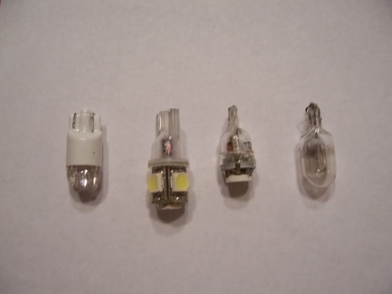

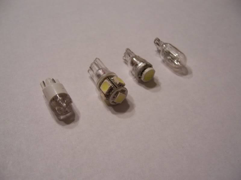

i have right now a

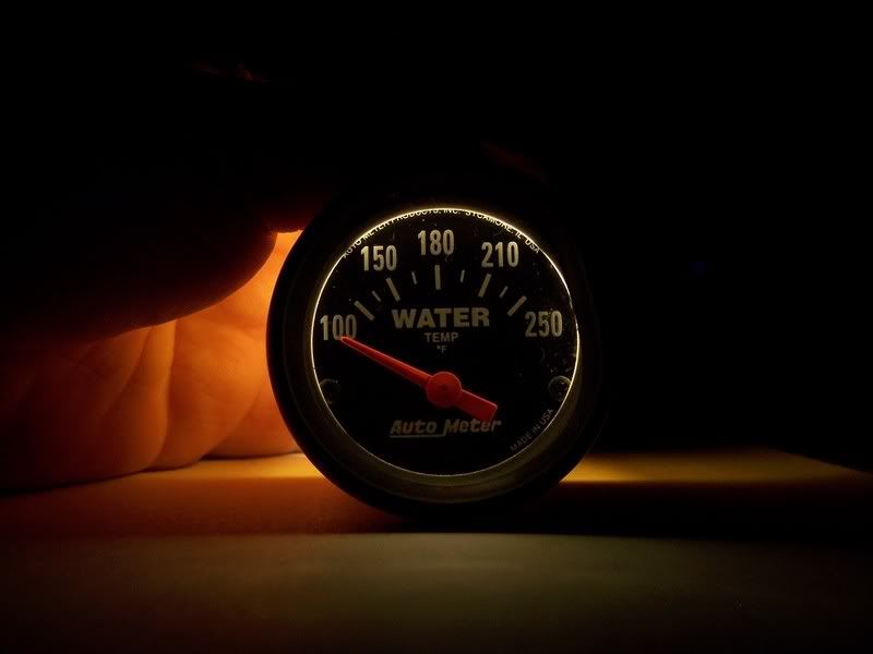

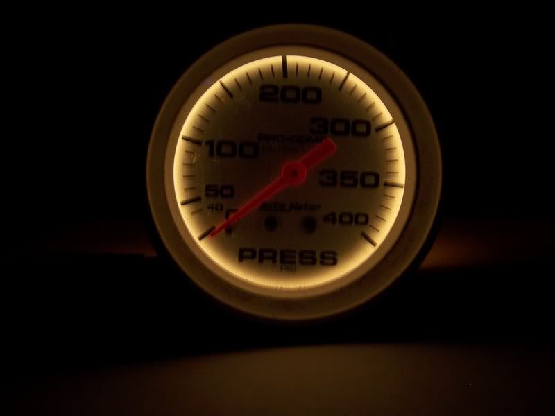

regular bulb
and three led ones
i will start it off with the regular bulb
and with a one second shutter speed

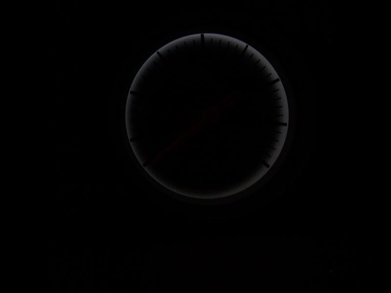

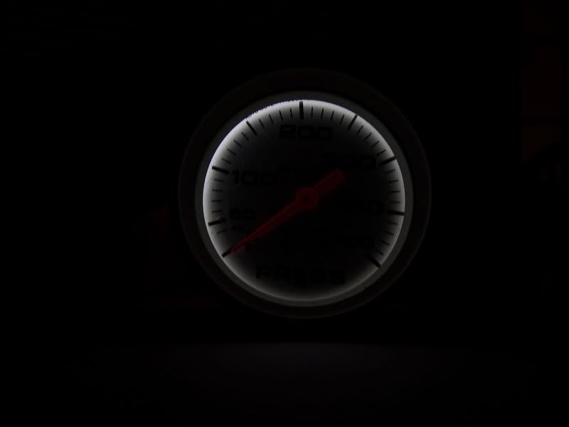

next is a forward facing led with two leds made by piaa
and a one second shutter speed

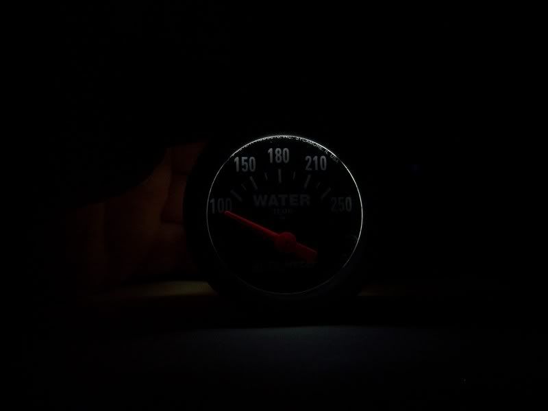

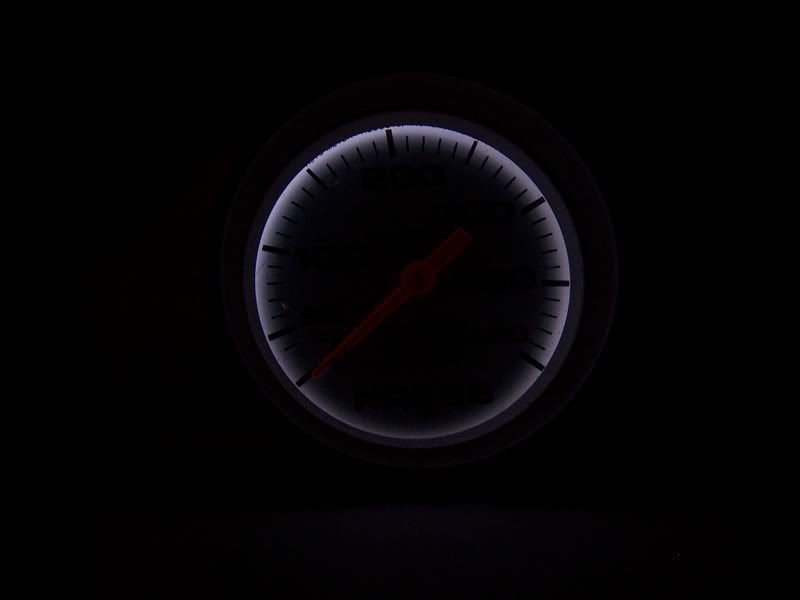

now the flat top led
and with the once second shutter speed

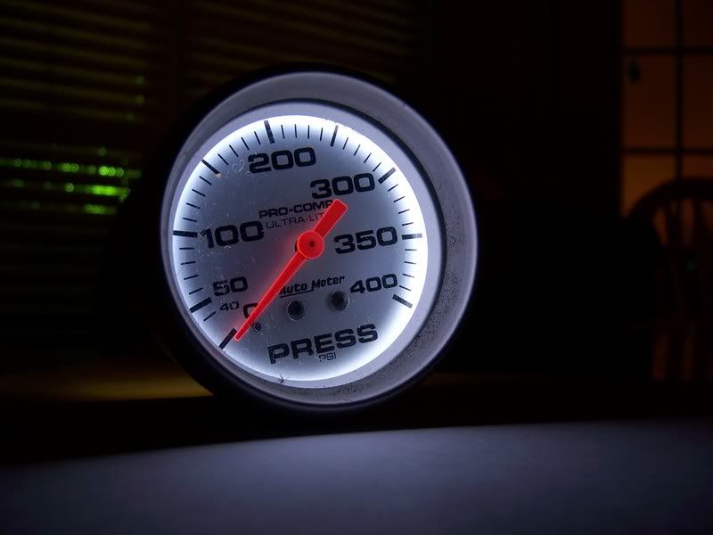

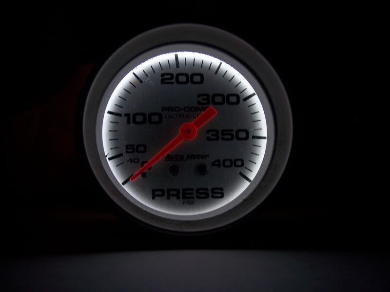

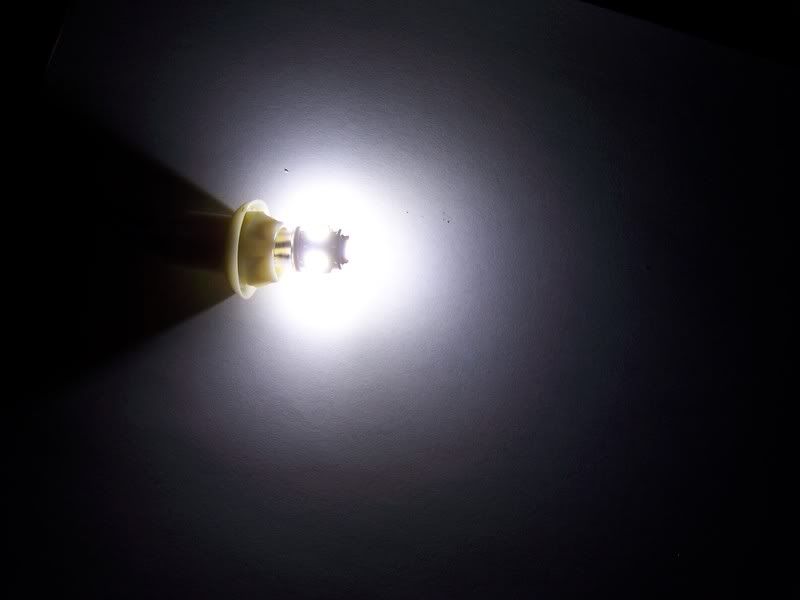

now the five led one with 360 degree lighting
the only led bulb that worked very well was the one with the 360 degree lighting...

i must say i am impressed with the light output..and the pics do not lie..now i could have gotten better results from the dimmer ones by keeping the shutter open but then the results would not be true...
