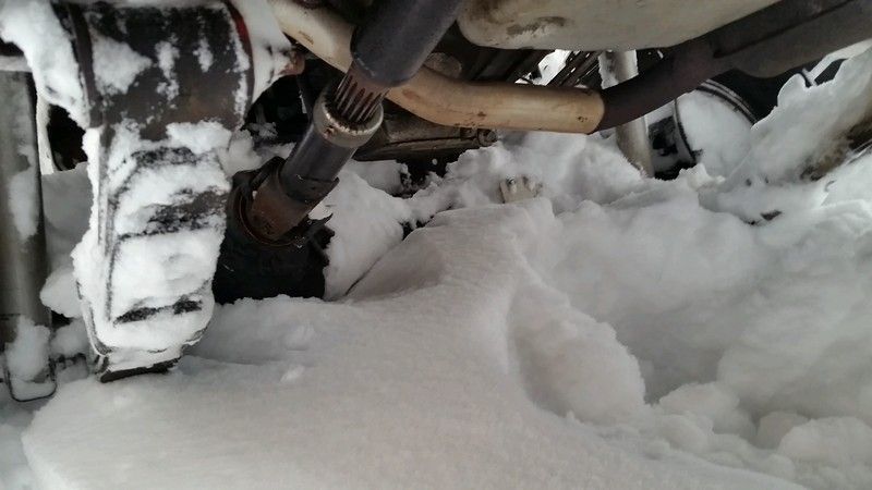

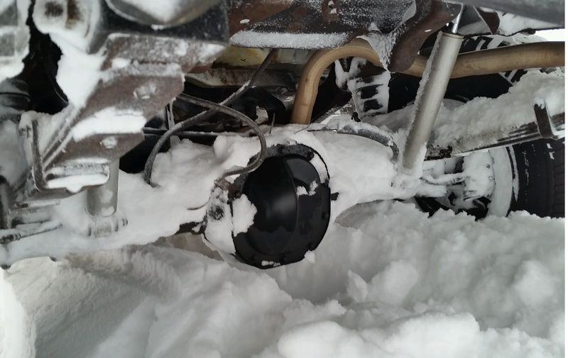

No real update to the truck & the D44's are under about 3 feet of snow right now, so... here's a couple pics from all the fun in the snow this winter.

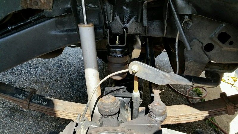

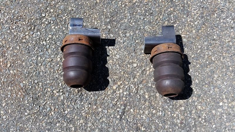

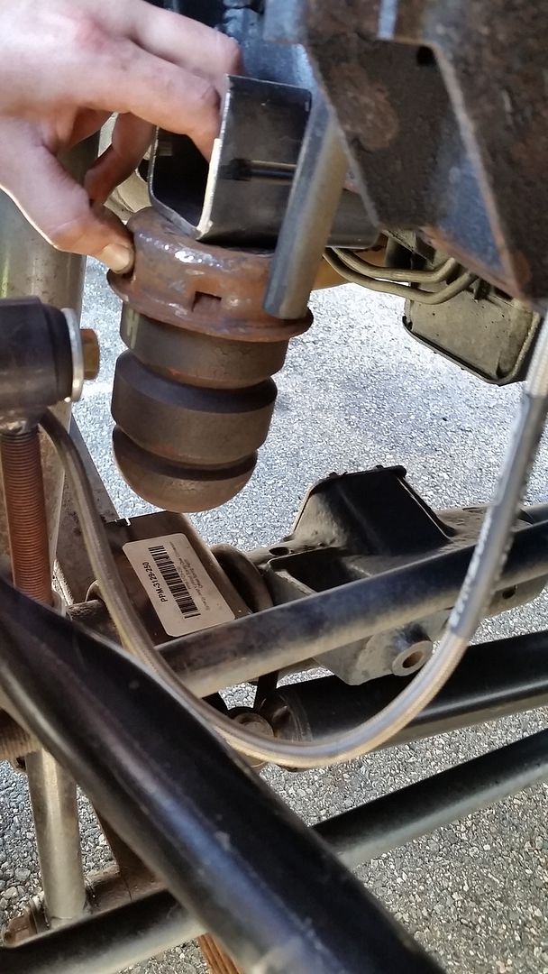

Today I fabbed up some bump stops (finally) using stock blazer bumps, some 2.5" square tubing and a set of spring perches i was gonna use if i ever went SOA. Didn't get a chance to weld but hopefully I'll have them stuck to the frame by the weekend.
Other than that no big updates... I did swap to adjustable end links (read longer) a while back and mounted another mustang bar up front that's unmodified, seems to ride a little better after that. I did a brake job the other day and put some nice Centric rotors and fleet performance pads in it. Stops good. I have over 30K on the swap now:eek:

Here's a finished picture of the bumps....
