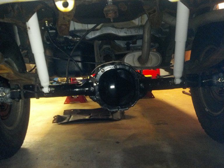

So far i have the 10 bolt out of the truck, and the 8.8 mounted spring over. I used a 1500 silverado center brake hose, along with silverado right and left brake hoses mounted to the ford calipers. The center hose is 22" long and worked perfect mounted just like factory to the diff cover. I had welded on some custom brake hose mounting tabs for the right and left hoses before installation. Also k1500 rear shocks where used with new mounts welded to the tubes.
