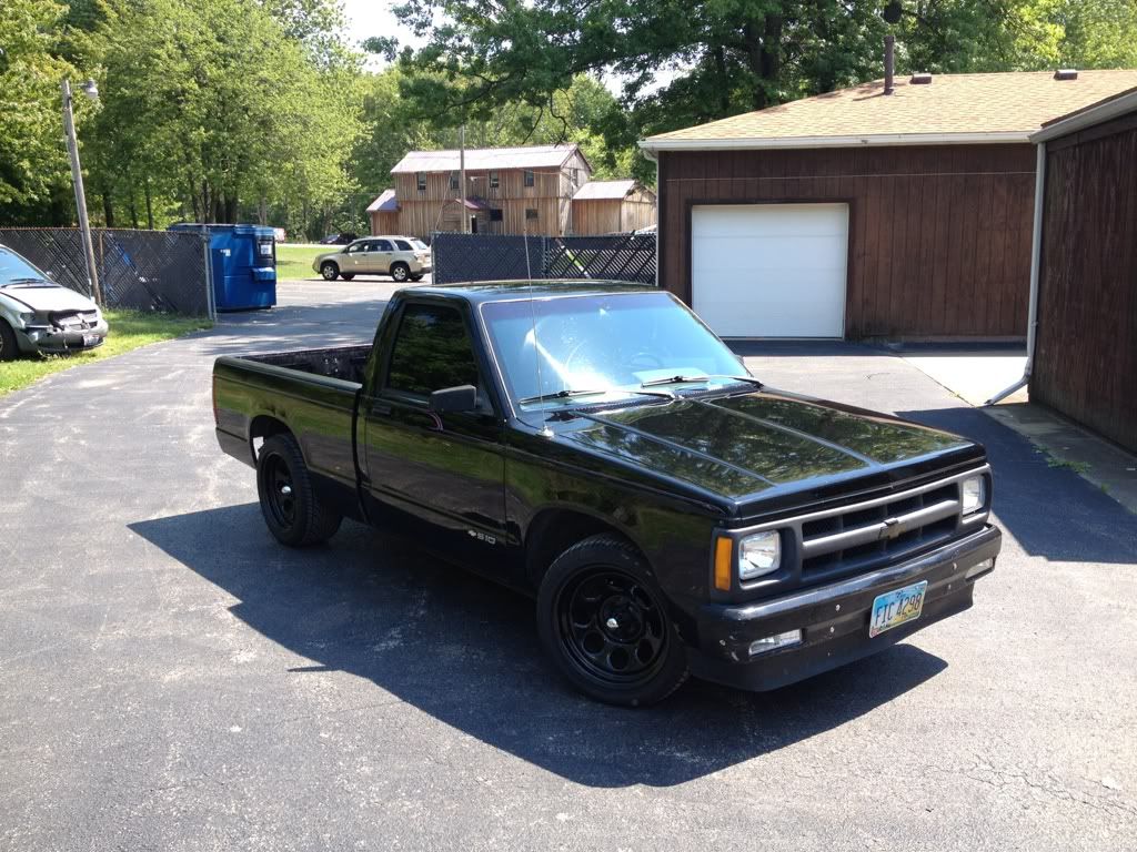

First thing I did was rip off the purple tint and went 5% on the rear glass 20% on the sides. Bought clear H-4 headlights and bumper lights, and bought some 17" Soft 8s.
Here's how it sits now, rims are 17x8 245/40 front, 17x9 275/40 rear with 0 offset.
I've been debating on how low I wanna go, I did some measuring today and a 5/6 seems about right. I bought some 3" blocks this weekend to level it out some for now. But here's a quick chop I did for some motivation.

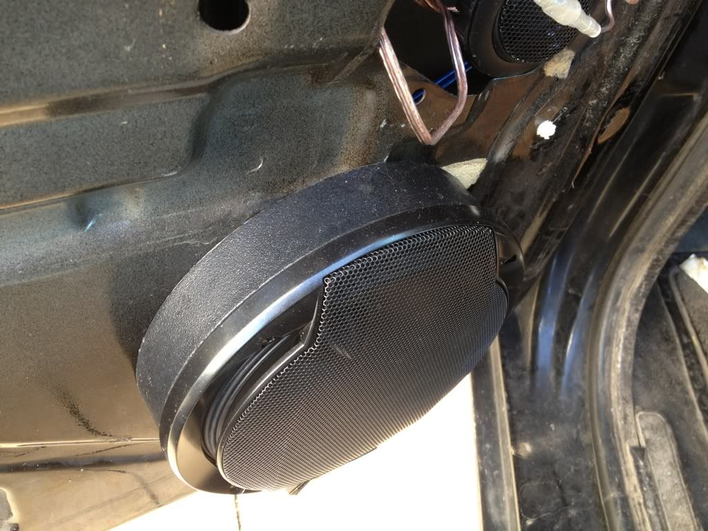

Been playing with tweeter placement, I think they're gonna end up right about where they are in the pic. I need to finish modifying the door panels to fit the speakers, sound deaden the door and figure out something for a moisture barrier. I want some thick mil plastic but I dont want to buy a whole roll of it, so someone suggested I use small pond liner since I can get it in smaller quantities and its thick. I may go that route, unless yous gais has any other ideas???

As for door liner...I'd say that pond lining would work...but I'm also a do it right the first time. I would see if any of the guys here have some...or if nothing else...go check out the junkyard, find the cleanest Dime there and steal the old one there. Or talk to the parts store guys. I don't know how much plastic they sell in a roll. I know I have a roll lying around my parents house but we use it for a lot of things, so I just scrounge as needed. I'll see how much is there and if you give me some measurements, I can probably ship you some.

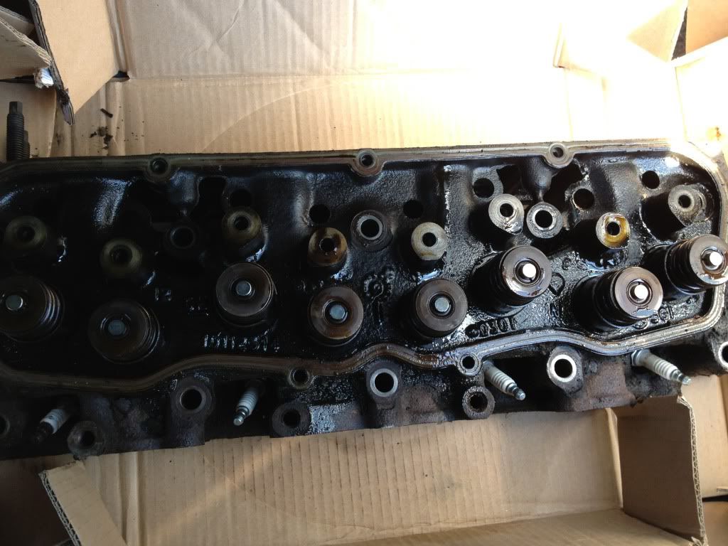

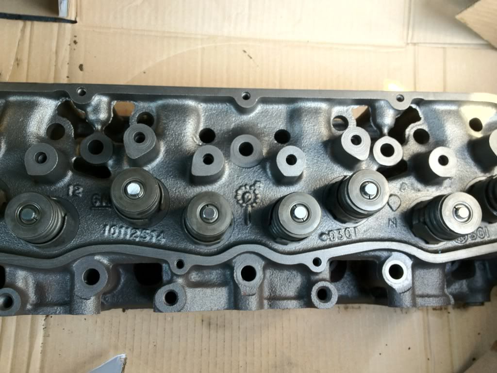

Shitty picless update, Wednesday on my way to work I somehow bent an exhaust valve and its stuck open. So now I get to pull the head and see what the hell happened. If nothing is catastrophically wrong, I'll send the head out for a valve job, and order a new exhaust manifold (been cracked for a while) and whatever parts I need to get it running again. If its worse than I expect, then IDK what i'll do.
oh oh oh I know....V8 THE BASTARD!!
Haha. While I'd love to swap it, if I have to put a new motor in it'll be another Duke. V8 isn't financially possible right now.
Lol It'd be fun! But I don't blame you
5
Everything seems alright, just a bent valve. Gonna drop the head off at the machine shop next week for a full valve job, new guides, seats, and whatever else they find wrong. I'm also getting all new lifters, and a new exhaust manifold (may weld this one up for the time being.) And I'll probably go ahead and change the coil since its alot easier to get at without the intake in the way.
