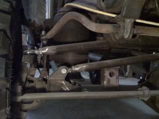

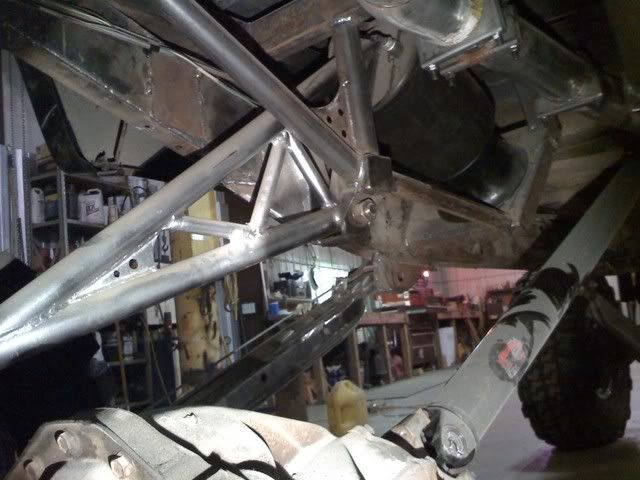

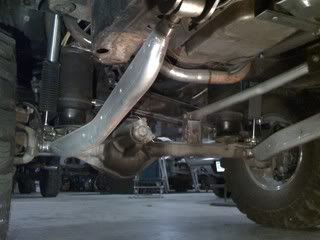

Thanks guys. I haven't done a thread or write up on it since the amount of work I have done to it has taken so long, but this thread seams like a good place to start. My signature sums up most of it. Basically I drove my perfectly good single cab, fuel-injected V8, coil sprung, 4-linked SASed S10 with a D44 front & 9" rear, into my shop simply to put the 6.5 diesel in it because gas was gettin high and it got about 13 mpg. Well, 3 1/2 years and changing everything but the front fenders, seat, and headlights I've got this monster. After I got the 350 pulled, I decided to go ahead and strip it to the frame so I could lengthen it to add the extended cab to the long bed chasis. Then, I decided to go ahead and put the 1 ton axles and air-ride in it so it would better support the added weight and torque (when I get done adding the chip and injectors) of the diesel. I also wanted the air-ride so it could support loads better, ride better, and so I could get my Quad in the bed a little safer by airing it down. As you can probably tell, the whole project kinda snowballed as it progressed, but I think it will be worth it. Here are a few pics I have and I'll take some more since it is finally coming together. You'll have to excuse the paint for now, I'm not going to do the body work and paint it until I get finished with the fabbing and test drive it for a little while to make sure I haven't screwed anything up. The first pic is what it was like when I started, the rest are fairly current.

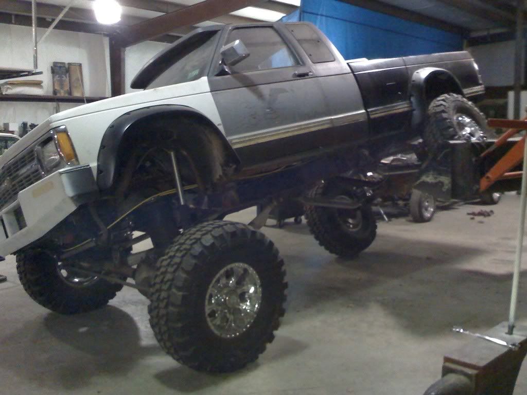

lol i love your axle articulation tester :p

Thanks alot! I didn't use the Kelderman kit, it costs to much to have to revamp it for a small truck. I just did alot of research on bag dimensions, travel, and load ratings and made what I hoped was an educated guess as to what I needed, then I just built the links. The back was a little tougher since I went with a canti-lever set-up to get more down travel so I could get my quad in the bed easier :D. The front bags are 3600 lb with a 14 1/2" stroke and the rear bags are 5600 lb with an 8" stroke, but the back is centi-levered 2 to 1 getting 16" of wheel travel and cutting the load rating in half. All the bags are medium duty truck bags.

so im curious, i havent really seen that style of rear suspension before. where are the upper links? is there something that gives you lateral stability?
523 Posts
I was looking at that too...What is keeping that thing from shifting...And also shouldn't the cantilever arms have some sort of give where it mounts to the axle besides the little bushing that is probably in there? Like a johnny joint or heim because it looks like it would break the mounts or bag if it were to flex twisting the whole arm??? (scratches head)
