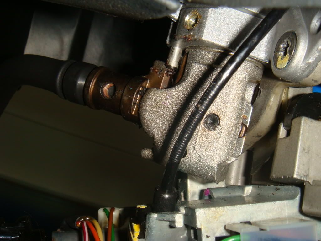

ZQ8, is the white thing with the metal rod (with the black connector on the rear) in this pic the cylinder you were talking about?
you said you removed it right? the other end of it can be seen on the lower left side of the same pic, did you just unplug it from there also?
is this the pin you were talking about for the shifter?
yes
Yes I took it out(don't remember why really.) made sure the cylinder was out all the way and then put the cover that has 3 torx screws holding it on back over it so it would keep the cylinder out like it's suppose to be. Also just be sure to have the shifter bracket(piece that the pin is in) in park so you can get the key out.

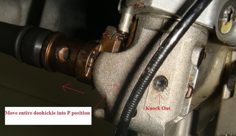

Yes, looks like yours has a little black grease on it, just knock it partially out with a punch and hammer then use something a little smaller than the pin to remove it the rest of the way. Once it's been knocked with a punch it's pretty easy to get out, I think I just used a philips driver
im wondering if anything really needs to be removed but the shifter stalk? it would still be in park technically. that white piece that you say to remove wouldnt know the difference i dont think...maybe ill try it and see, cant hurt right...lol
and for the pin, what part will be coming out exactly...the copper looking base of the shifter (with the spring inside)? sounds like a stupid question, but what keeps the car thinking its in park if thats gone?
I honestly can't remember if I left the copper piece on there or not, I think I had to take it off because the column covers wouldn't go over it. I know the spring stays in there though.
You can probably leave the cylinder like it is, I took mine off because I thought it needed to be and then I had to re-install it. You're probably fine leaving it that way.
I'd test fit the column covers, but before you bolt them on I'd drive it a few miles and make sure it's working right.
ok, update....im 99% done.
got the pin out and i removed the entire copper shift base piece. i removed the cylinder piece from its location, but left it plugged in near the ignition. this is the thing that keeps the key in the ignition; once you remove the stalk and copper base, there is nothing keeping the exisiting shifter assembly from rotating clockwise, which doesnt allow that metal shaft from the white plastic piece to extend - the truck doesnt think its in park, and you dont get your key. as i said i have it loose now, so the shaft can extend and retract...i need to find a permanent fix to this though as id rather get rid of it or wire it appropriately. ZQ8, i wasnt able to remove it from the ignition side...i got the connector loose, but i couldnt get it off. it was still stuck on something, how did you get yours off? also, with it off, are you able to remove your key?

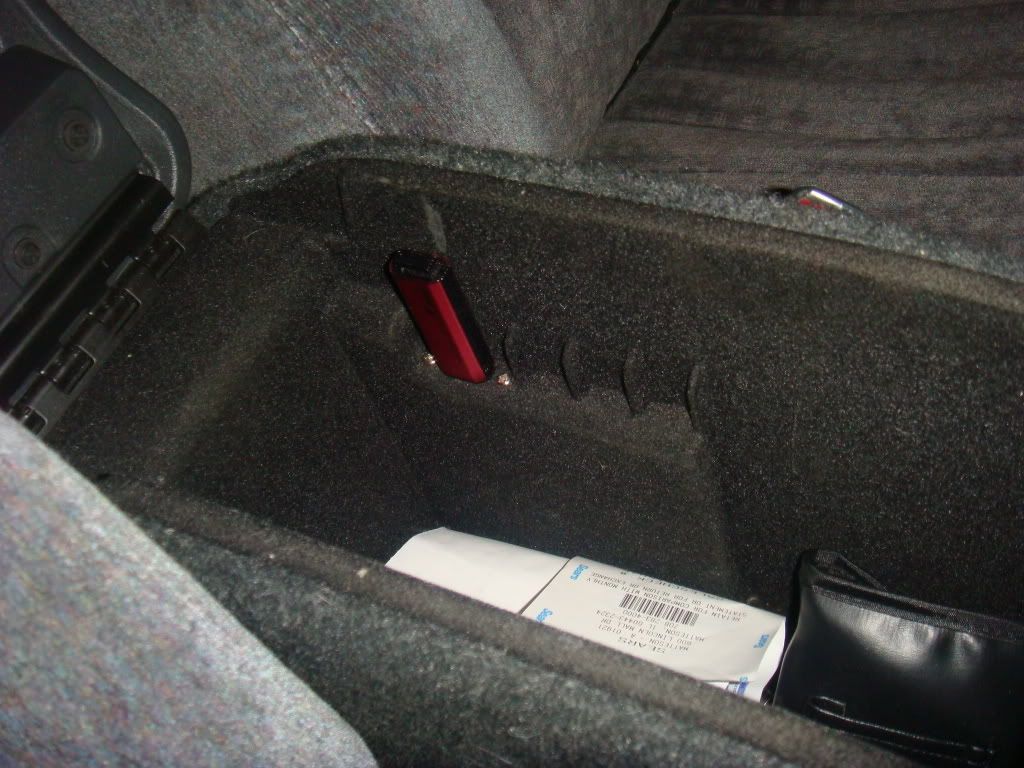

i did find a good spot for my thumb drive:
Well that's neat, does the plug actually go somewhere?
yup, it goes to the usb module for my pioneer head unit...its nice not having to see it.
