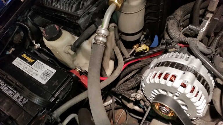

Here are some pictures of my AD244 in action:
Output at idle with just my headlights on:
Output at IDLE with my system cranked to the max:
Output at IDLE with all accessories on (all 4 headlights [quad beam mod], a/c on MAX with fans at #3, fog lights, and my system cranked to the max:
13.96 can be lower than most would like to be.... but a stock CS130D would be gasping for air if I was treating it like that.
So, if I had things my way, every s10/blazer would have an AD244 as their alternator, even if they have a stock electrical system.
