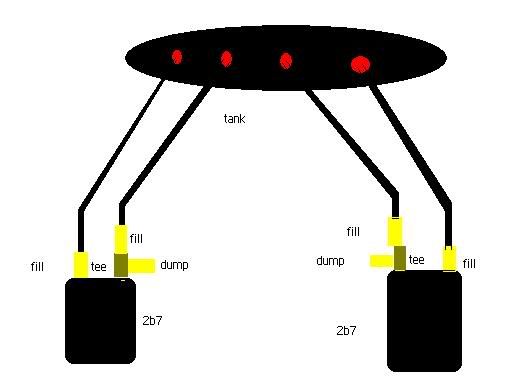

ok so im trying to make a hopper. with that i plan to run 6 1/2" valves up front. dual fills for each bag, with one dump on each. so 3 valves per bag. So how would i plumb it? run 1 line from the tank to each fill, then tee off a dump on one of the fills? kinda like this?
let me know if this is right, or if i should make any changes.

Yeah, here's another visual if it helps. It's just the same thing though.

yeah, thats a cleaner drawing of what i was trying to portray. but instead of running a second fitting for gauges, i found that SD carries a T fitting that also has a guage port on it as well. so ill use that for less pressure loss and keep the valves as close to the bags as i can get.
