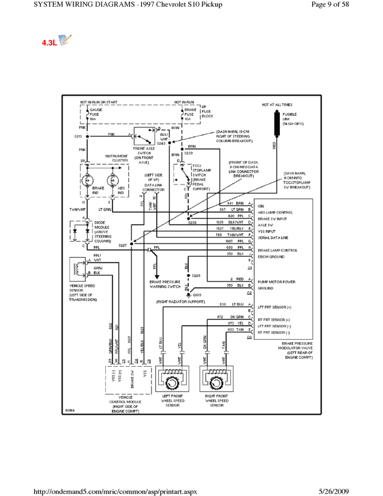

I own 96 S10 which did not come with engine. I installed engine with 97 Engine Harness which is different from 96 Engine Harness. To me only difference is ABS module wiring. By looking at wiring diagram, can someone tell me if I need interior harness with 97 ABS module.
