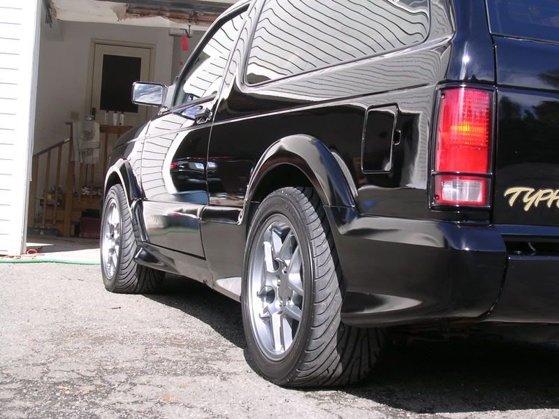

The Z06 wheels on my Typhoon are 17x9.5 I'm not sure on backspacing and offset (46mm rings a bell but not sure). I run a spacer on the back. I can't remember is it's 1 or 1.25in.
The sit flush with the cladding in the back

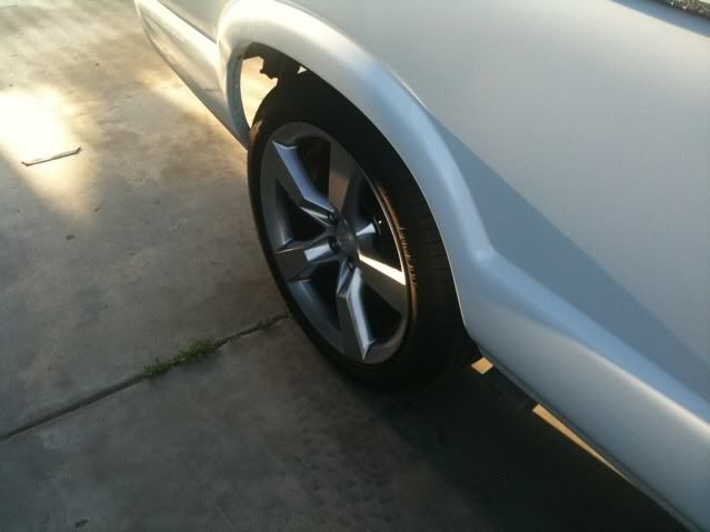

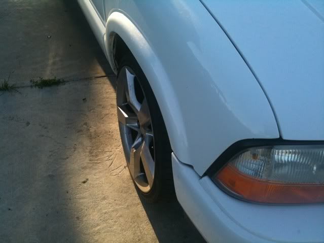

I put the 2010 Camaro Rims on my 2001 Sonoma ran into a couple problems but nothing major. I had to get two front tires Im running the original 275/40ZR20s in back and changed the fronts to 235/35ZR20s not rubber bands you can go smaller to 235/30ZR20s but the 35s are good no rubbing eaither.

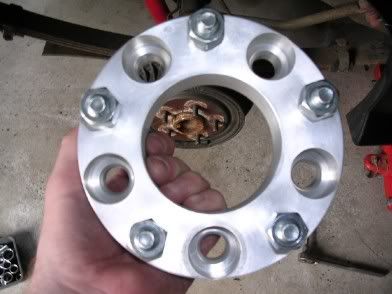

What is needed:
4 1 inch Adapters $50 each
4 spacers $10 each
10 extra reach wheel nuts $1 each
The 4 spacers go in front 2 for each side. Each wheel gets a adapter the back is the easy part just bolt on the adapters with the original bolts. On the front you need to put a spacer first then the adapter. You bolt down the adapter with the extra long nuts, then put another spacer. So it goes spacer adapter spacer. The extra long nuts will fit into the adapter so the spacer fits flush.
10,370 Posts
Why didn't you just get a 1.25 or 1.5" adapters for the front? I wouldn't want an adapter AND two spacers on there.
