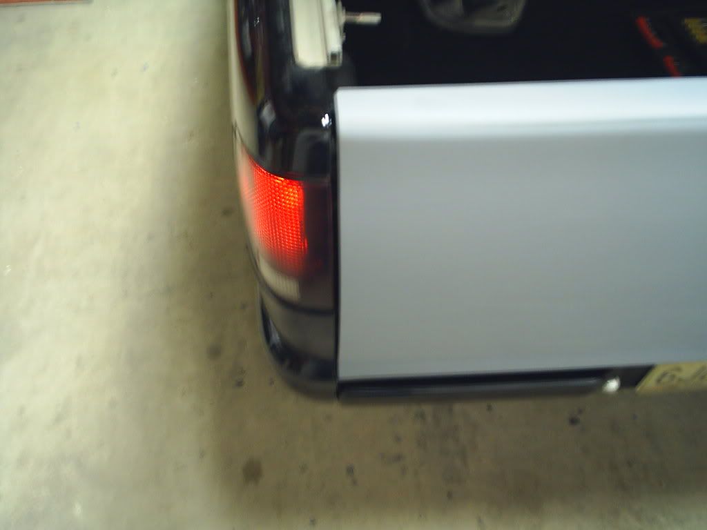

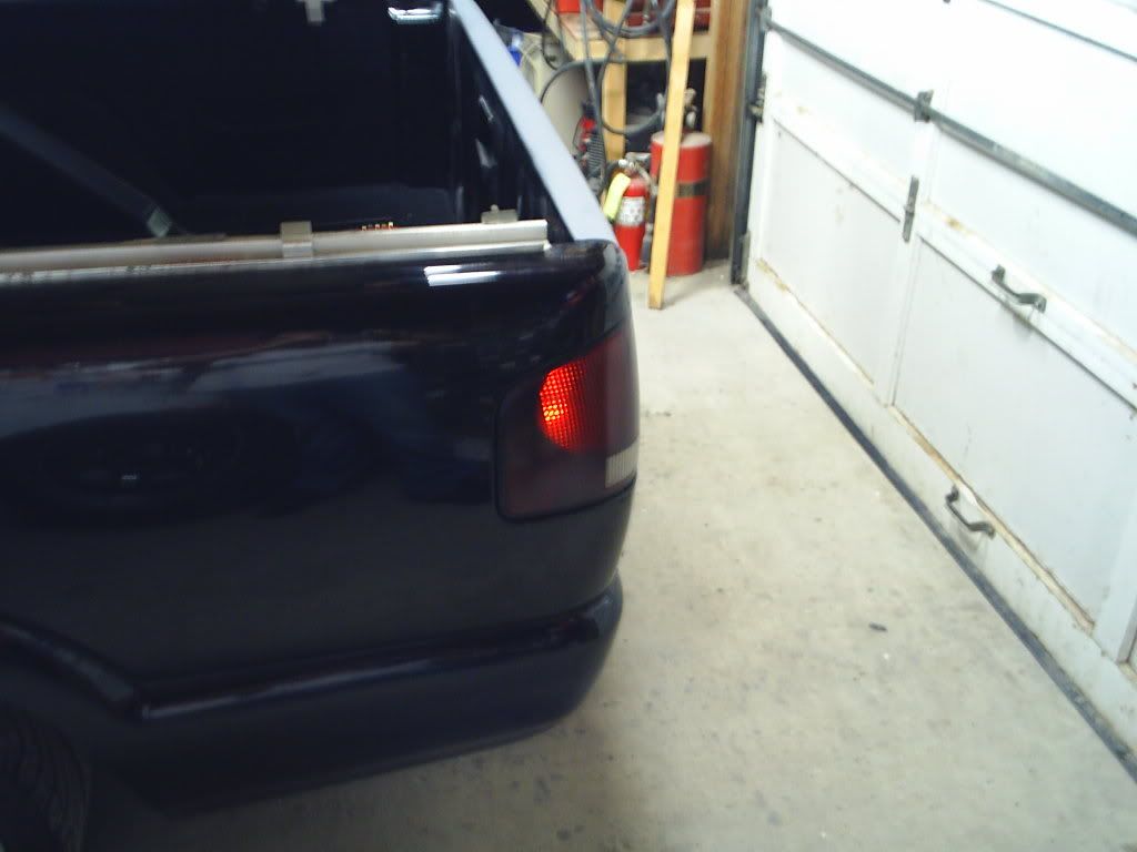

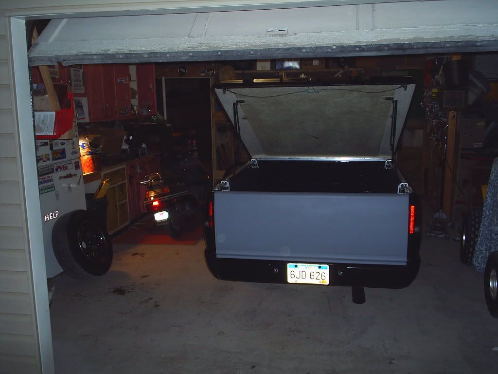

i smoked m tails i have been doing so much stuff to my truck in the past couple of days we finially got my dads 72 ford f100 dropped and out of the garage and know i got it for a feew weeks but here is some pic of today's project i also installed all new 4 toxic shocks and put my 18's back on

something's sticking out of the back of your truck:p
The tails look really good though!
haha yea that my tip not a fart cANNON but when yourn next to the truck it only sticks out about 2inches
459 Posts
That's 2 inches too long :p

looks damn good man. i was thinkin bout doin that to mine. howd you do it?
HALF XTREME
336 Posts
Discussion Starter · #6 ·
i masked off the rear light and roughed it up with 400 sand paper took alochol and wiped it off and i lightyly sprayed black krylon fusion over it till i got it how i wanted it
