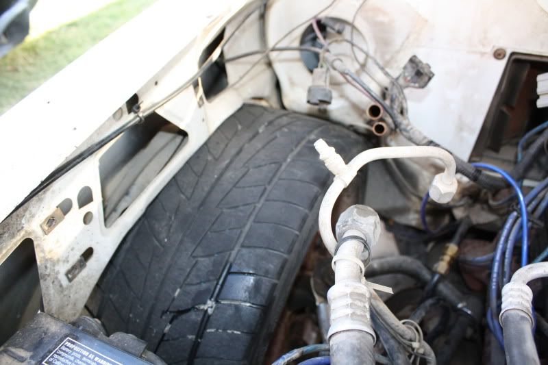

ok i got a 90 noma and i cant get the front wheels to tuck like i want them to
im laying on 20's with custom top arms and my lower arms are stock.
on my top arms i got a number of washers between the nuts!
heres a pic so u guys can see
am i supose to just have one?

Looks like ur fender is hitting. If u have a 20 u need to tub the fire wall and also did u dehump ur lowers
76 Posts
i still need to tub but were am i gonne put the harness when it comes to that cuz i knw my whell will hit it....
i dont think my lowers are dehumped.... im thinking of getting a set of lowering control arms but not wanting to spend to much

im not seeing anything wrong with those pics... other then nothings cut out to clear the tire? The amount of shims will depend on your preffered ride height when you get it aligned.

3,619 Posts
You're gonna need to cut that fender skeleton out, tub the firewall, dehump lowers, and get drop spindles if you don't have them already.
Like Dave said, the amount of shims is all in how you're ride height is set.
unless you have a TON of shims, it will not affect laying out on a 20" wheel, so don't worry about the shims.
Also, the wiring harnesses, and prolly the heater core etc will need to be relocated.
you've got a good bit of work ahead of you, but its worth it.
search on the forum for relocating, tubbing for 20's, etc, you will find some good threads.

you were right, those lowers are not dehumped.

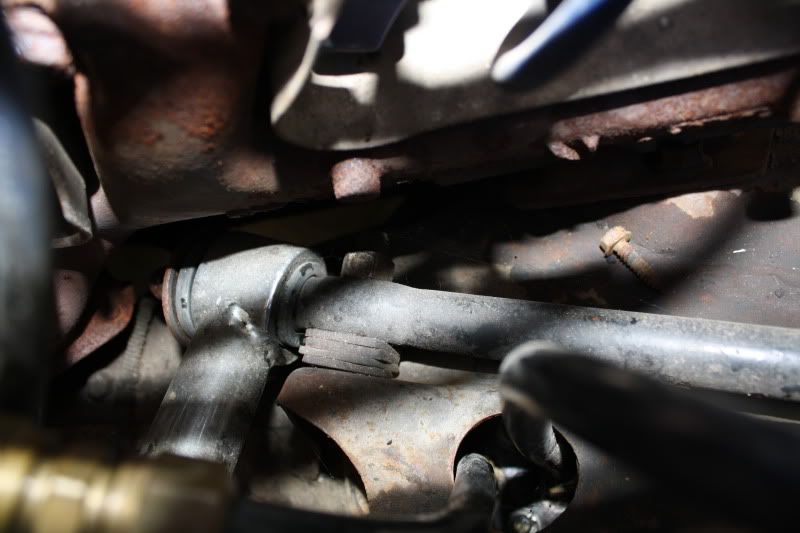

Also ur tie rods r going to hold u up as well

1. Tub firewall
2. Relocate appropriate items
3. De-hump Lower arms / Get tubulars
4. Notch frame for tie-rods
5. Gut the fenders inner skeleton
Are you running drop spindles?

no i do not have drop spindles but will be getting
