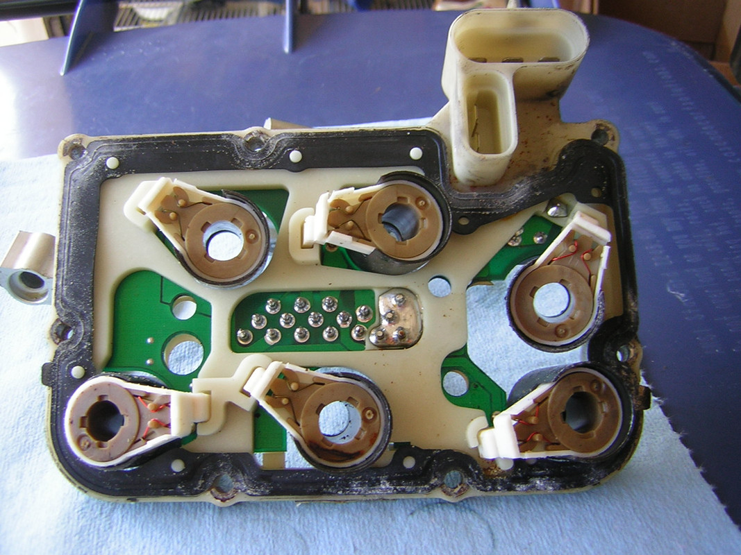

My 94 uses the Kelsey-Hayes EBC4 ABS unit. The ABS light has been on since I bought the truck. I bought another ABS unit off ebay before I knew there was a difference between the Blazer unit and the pickup unit, and of course I bought a Blazer one.
I'm getting codes for the control valves and open/shorted pump motor relay. I've read everywhere that the main problem with these is that the relay sticks and burns everything up.
I took my Blazer ABS unit apart to see if I can swap out parts, and I think it boils down to what you see in the pictures. This part is different of course, so I can't just stick this in - the connector at the top that is visible in the picture is a 3-pin, while mine is a 2-pin.
Has anyone had one of these apart and successfully repaired it? I'd really like to find a newer style unit to put in, but have no idea if anything would even work. I know most people on this forum just remove the ABS altogether, but I'd like to have mine working.

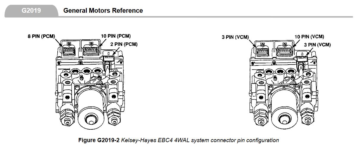

I dug out the wiring diagrams for the Blazer and the pickup and do see that the pickup has one more wire. IIRC on the 94 pickup I had, the ABS was not functional when in 4wd. I think you could get the Blazer pump to work by just leaving out that wire and using the correct plug for the pump with a couple splices. BTW EBC4 is sensitive to a good ground.
Here are the 2 diagrams side by side:
633 Posts
Discussion Starter #9
I think it boils down to two different models. My pickup has the one on the left. I think the Blazers have the one on the right. I tried calling the local yard a couple weeks ago. He said he was too busy to check if he had any, but would call me back. Of course he never did, and I haven't made it out there. There's about 10 of them listed on ebay, but they're all the Blazer style with the different connections. And thanks, but I already found that link long ago and read up on them.
