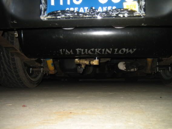

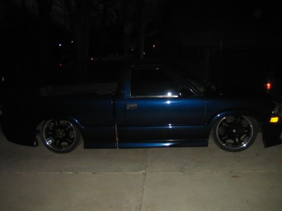

Little runthrough on everything
-Front has s10forum special with 2b6s (eventually to be RE7s)
2 450's on an 8 gallon
Airlift 1/2s and 3/8s for the front
SMC 1/2s and 3/8s for the rear
-Rear is the Airlift Slamair 59104 kit. Its the exact same as the ART airoverleaf but its only $170 and Airlift is located 20 miles from my house. Currently has just the middle leaf removed and a 4" block and it rides waaaaaaaaay better than the zq8+2/3 that was on it before.
