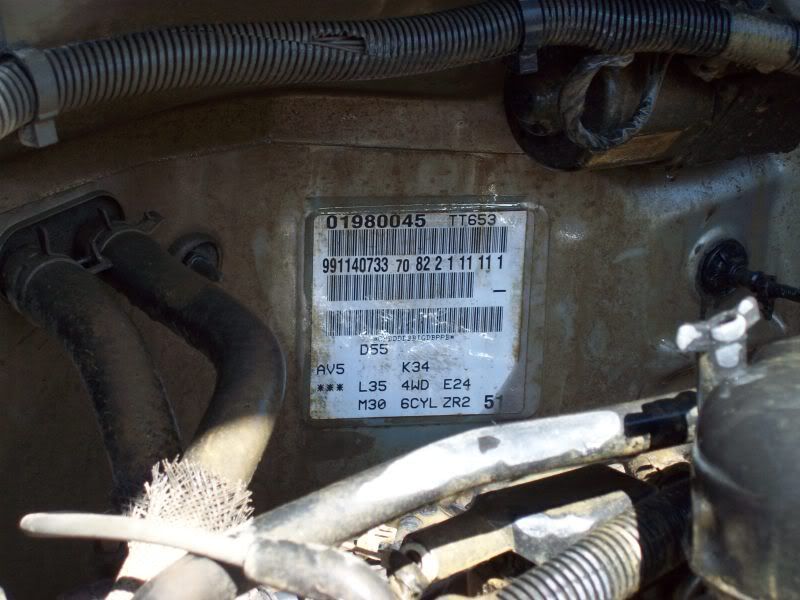

The seond way to tell is to look behind your motor on the firewall. There is a white sticker with several codes at the bottom, My ZR2 has "ZR2" wrote on it, in this pic. (It may be harder to see if you dont have a body lift.)

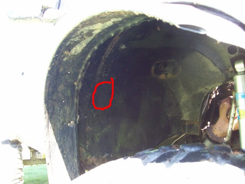

The third way that I know is inside the front fender wells above / behind the tires. My truck has "ZR2" stamped upside down on these as well. You cant really see the pic, so I circled the area that this stamp is located.
Passenger side
Driver side

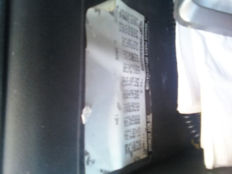

The fifth way to tell is by looking in your glove box at the sticker with all of your RPO codes. There are many 3 digit codes in here, just look for one that says "ZR2"

The fender stamp will not always work. My 01 doesnt have them but everything checks out and the dealer decoded the VIN for me so its definately a ZR2.
Anyone else not have the fender stamps?

and was yours maybe wrecked before? maybe they put reg s10 inners in? and my truck is the only Z ive ever looked that close at, so i dunno how common the stamps are.

yeah i couldnt find the ones inside the fender and mine has the bigger tire size on the door too.

YES!!!! Finally an answer. I was always under the impression my truck was a regular 4x4, but today as I was removing the upper intake manifold I noticed the firewall decal. It was quite dirty but I could clearly make out the "ZR2" in there. An yes the track bar is also in the rear.
