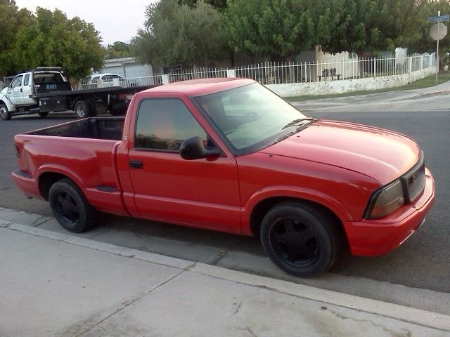

She's a 1998 GMC Sonoma SLS 4.3L Vortec V6 with the NV3500 5-speed, Single cab stepside. It was precisely what I wanted, searched far and wide and the only variable I was willing to negotiate was whether it were a GMC or an S10. I always liked the bigger grill opening on the GMC.
I live in the small beach tourism town of Laguna Beach, California. As you'd imagine these probably aren't the car of choice among the rich and snooty locals out here, unlike myself who owns a house with peeling paint, a garage full of noisy tools, and a corner plot typically surrounded by track cars or obnoxious vehicles alike. We've been marked the black sheep on the block for our motorsports addiction and general lack of f*cks given.
Needless to say, I traveled about 150 miles out to pick this thing up in the middle of meth-city Coachella, CA. It was an interesting ride out there, and the destination was a scene out of Breaking Bad with bagged Cheyennes creeping by, bald mexicans eyeballing us white boys, and the guy selling the thing didn't even speak english. His girlfriend had to do all the translating right down to the haggling. I ended up grabbing it for $2700 which I think is a bit for a fixer, but considering I was about to drop $6200 on an Xtreme and I hated the body kit, I think I can happily invest the extra 3k into making this thing pretty bitchin.

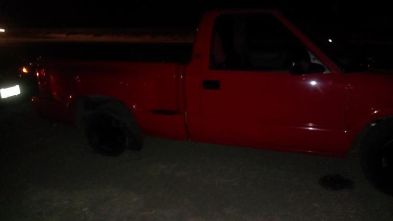

On the way home from the desert, 117 miles from my house and around 10:30 pm this happened:

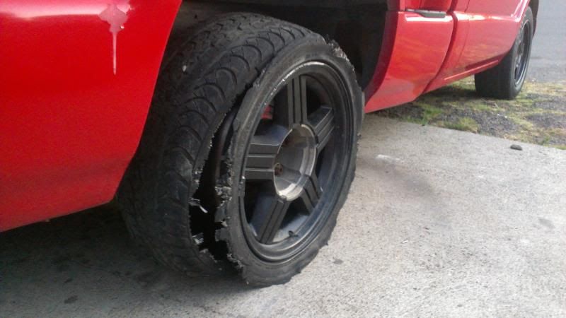

The picture is dark and kind of sucks, but a semi-truck with a flatbed lost some cargo and my rear tire ate it. Rather than driving home on the spare with dry rotted sidewalls, I had AAA get it home for me. Free tank of gas saved and new wheels/tires on the way!

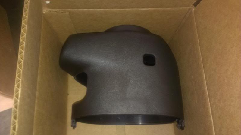

1) Steering column surround (broken held together with tape)

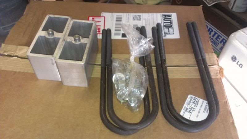

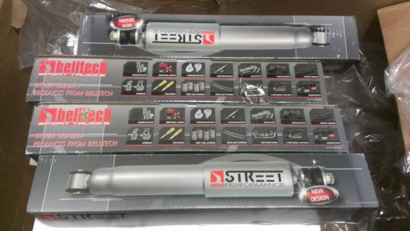

16) Full belltech street/track suspension setup with a 3" drop (shocks, springs, blocks ... explanation needed?)

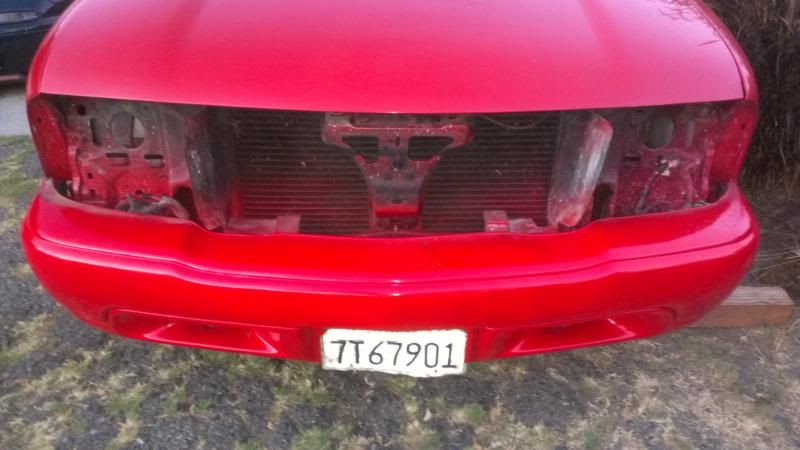

The grill, headlights and front bumper were clearly the result of some sort of front end damage that broke a lot of plastic tabs or caused several to go missing. The headlights had a bunch of what looks to be overspray from the PO's horrible spray painting hobby, where he sprayed the grill and emblems with tons of drips and streaks. The new headlamps just arrived and I've begun restoration of the grill, sanding it down, priming and painting.

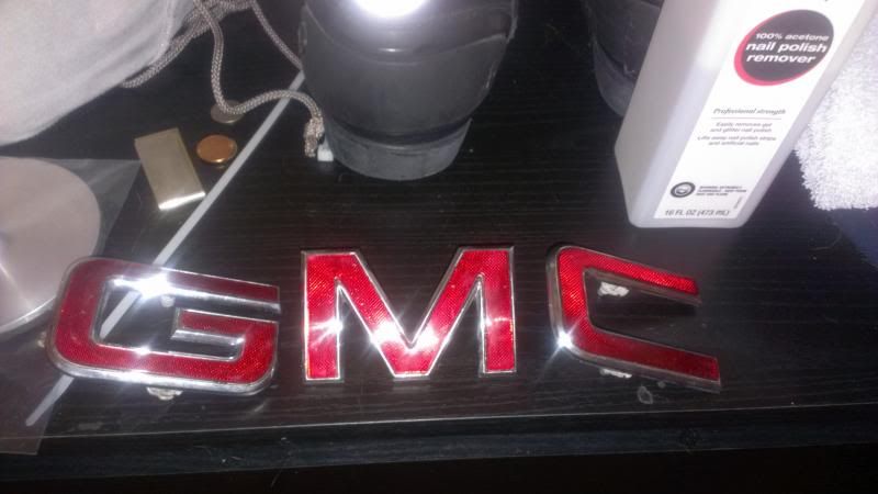

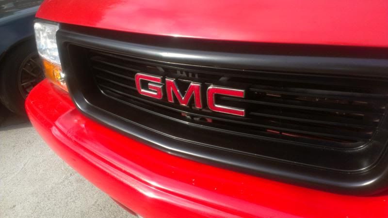

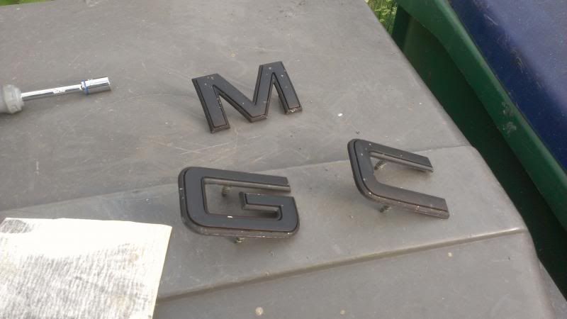

I'll post some after pics of the grill once it's cured and everything. The emblems were something I planned to ebay but it turns out they're like $70.00 new so I'll take some nail polish remover to these little guys until I make a junkyard run and horde some newer looking ones off of other GMC vehicles. I'm really striving for a clean OEM body on this thing with a tasteful lowering job that will also give a decent handling performance. Not into the bagged and shaved thing.

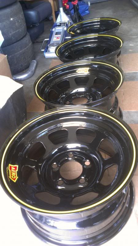

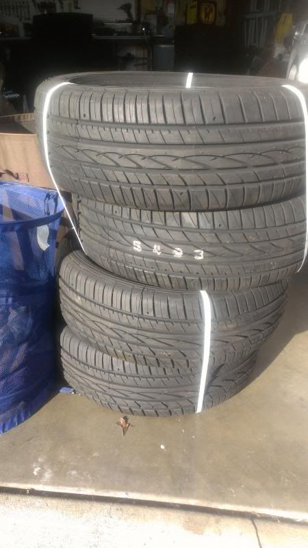

Additionally, the wheels arrived two days early, but my tire supplier was out of stock and they couldn't get them here on time. Fortunately they upgraded my order from Falken Ziex ZE512's to ZE912's which would have been a $25/tire additional cost, but they ate the cost for me. Good fortune, I'll forget about the delay!
These are 15x9 -19 AERO Racing steelies, most of you are familiar with these I'm sure. I went with 4" backspacing to be a little conservative on the fitment.

so here's a better pic of the tire, as you can see nothing structural got destroyed. It rolled right off the freeway on some frayed sidewalls and that's about it.
Here's some damage caused by the previous owner and his trigger happy spray paint addiction:

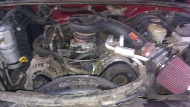

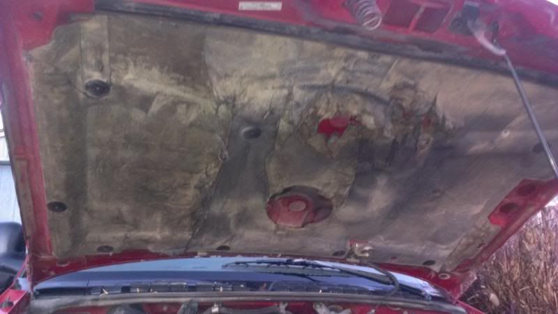

some engine bay shots, I swear the underhood insulation looks like a car fire happened lol. I know it's just rotten and disintegrating so I'll just replace it or remove it:

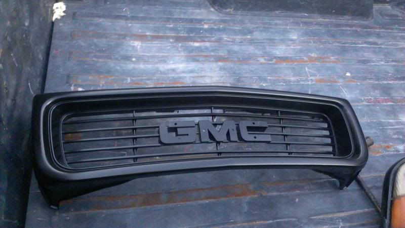

And here's the end result of the grill paint job. The emblem is still in the works (i.e. I haven't really had time to sit on my ass and rub nailpolish remover into the little cracks on the things for hours)

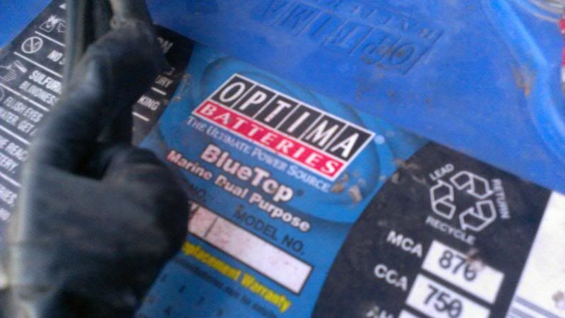

Oh I forgot to post that a new vehicle is never fully reliable without finding a marine grade deep cycle optima battery where a car battery should go. Damn desert people...

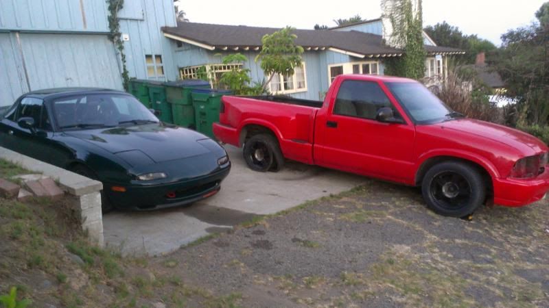

and finally here's a shot of the two two-seaters side by side. I swear this is like the "Miata" of trucks. If it's got more than 2 seats, it isn't worth racing!
I just noticed the width of your wheels- 9". With a 4" BS, you're gonna be REALLY close to the fender lips. I'm quite positive you're gonna have to roll the lips. Probably gonna need the UCA and tall BJ swap to fix the camber curve, too. What all does your drop consist of? I know you said 3", is that spindles and 1" coils or springs only?
I might kick myself in the butt for ordering without more thorough research, but the measurements I've taken shows everything should clear. I'm not going any lower than 3 in the front and the rear looks like it would clear another inch of backspacing if necessary.
15x8
^^^ That makes a world of difference. You said 15x9 with 4" BS in post #3.
8" width with 4" BS is a great fitment with very minimal rubbing issues of the sway bar in front of the wheels and the frame behind the wheels. ZQ8 trucks rub at these spots from the factory. The rubbing is only at full-lock turns, though. Carry on and post pics.
now you've got me looking at control arm options too. You're a bad influence. Possibly pulling the trigger on a set of Spohn UCA/LCAs after judging the ride characteristics.

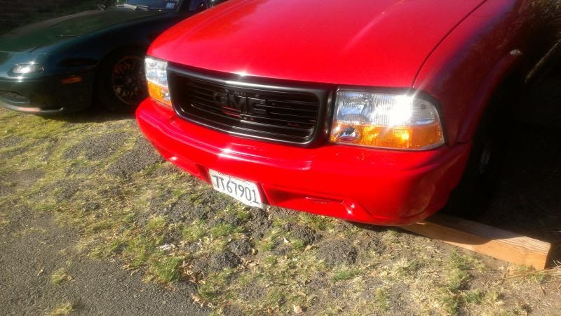

Decided to stick with the fog lights instead of the no fog headlight housings. Here's how well the front end cleaned up with fresh paint on the grill and some brand new headlights:

After looking at your tire size, they're about 10mm narrower and about 1/2" shorter than the stock ZQ8 size. So, you may not have quite the rubbing issues I was talking about. Not that they were anything to be concerned with in the first place. I know it's just a daily driver, and skinnier tires really help with MPG (at least in my experience), but I think 245s would have been worth the cost. I had a standard cab 4.3/5-speed, and it couldn't grip for shit on the stock 205/75-15s. Merging into flowing traffic on a wet road was dangerous. I had to allow enough distance as if I was driving a 2.2. Swapping to 235/60-16 (on my Xtreme wheels) made a world of difference. I also never got 23.xx MPG ever again.
I'll be using a 245 NT01 on the 16s for some cheap track rubber if/when I get to that point. Socal stays nice and dry so I should be okay on 225s with a light truck

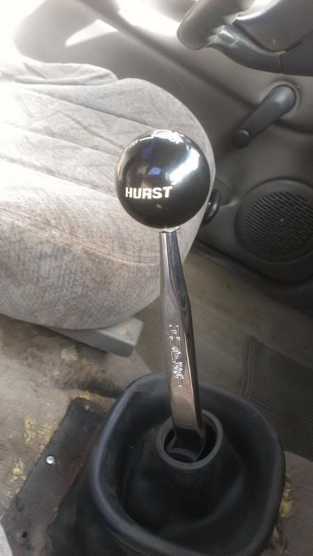

So I dropped off the tires to a shop downtown and had an hour to kill so I went and installed this:
I freaking love it. The throw is perfect and it feels so damn solid compared to that foam-filled tube and crappy chevy rubber knob that was on there before. Shifts more like a car than a truck now and that's what I was going for. The entire swap took maybe 10 minutes because I had to looke for some RTV for the gasket surface.

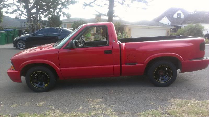

Soon after, got the wheels and tires back, mounted up and here's how she sits:
There isn't as much rake as it looks, I just have it parked on a hill. This is pre-drop too so It'll be a little lower than this when I'm finished. The old tires were 3 different sizes and to my surprise the alignment was straight as an arrow once the new wheels and tires were slapped on there. I had a good feeling it owuld need an alignment anyway but since it drives straight I'll wait until I finish the suspension work to align it.

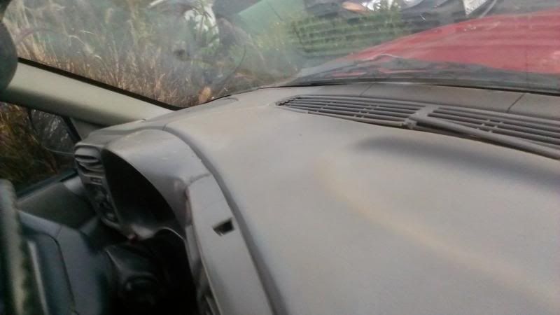

did some junkyarding this weekend. I'm having some issues with the parking brake pedal. First it was missing the release cable and handle assembly which I yanked from another S10/Sonoma in the yard, but then the pedal wouldn't raise up when disengaged with the cable. A spring somewhere isn't under tension or the cable has some serious internal resistance. Replaced the spring under the driver's door and that didn't help at all. I decided to pull a handbrake from a similar-colored interior from a 1990 accord and I'll be retrofitting that with some new cables in between the seats for some JDM car goodness lol. I prefer a handbrake to a pedal any day for simplicity and accessibility. I plan to use buckets anyway so this will work fine.
