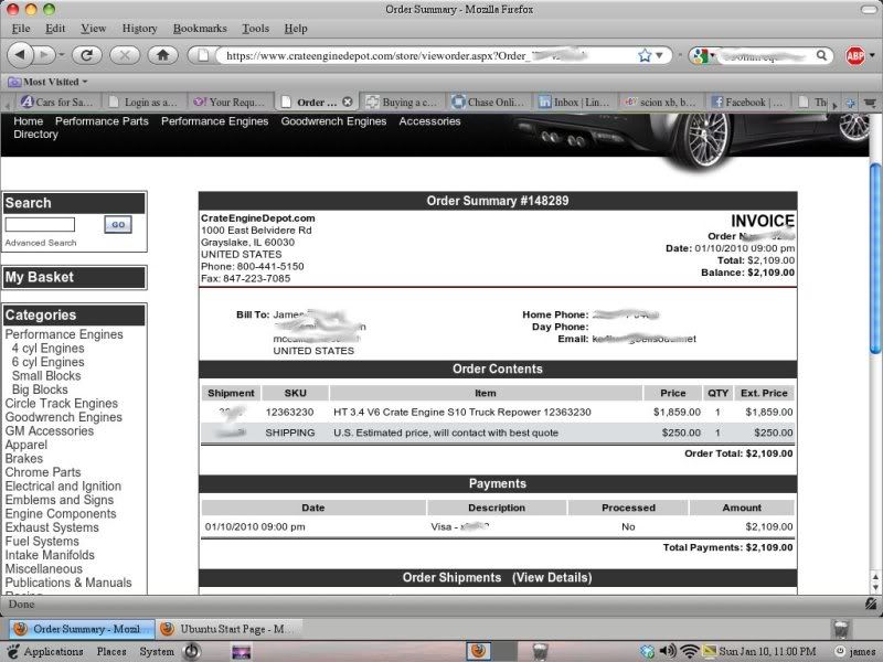

After seeing the price I'm glad I got the deal I got!
