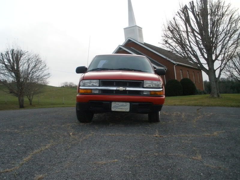

if you installed them wrong they may look like this...
or this...(drivers is in wrong)
this is how it should look...
