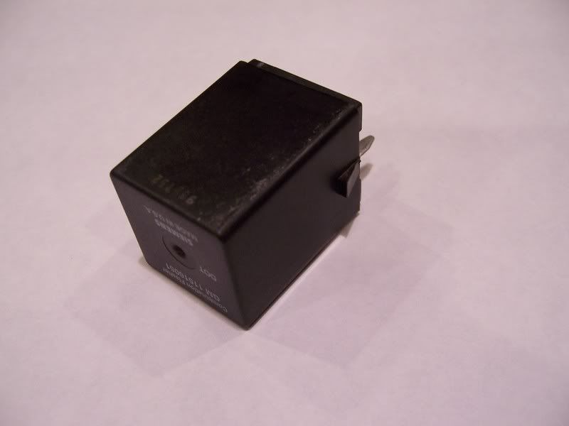

here is the unit

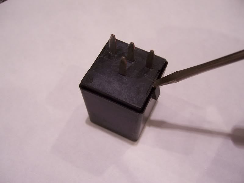

use a small screw driver to pry open the case..there are spots on both sides to pry

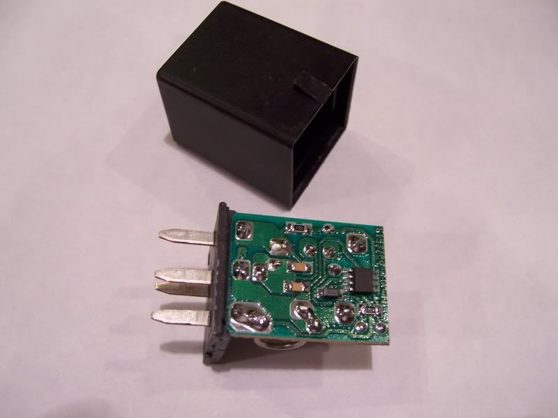

once you get it open it will look like this

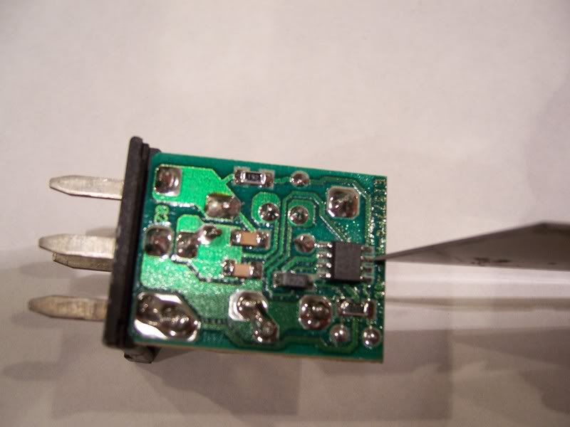

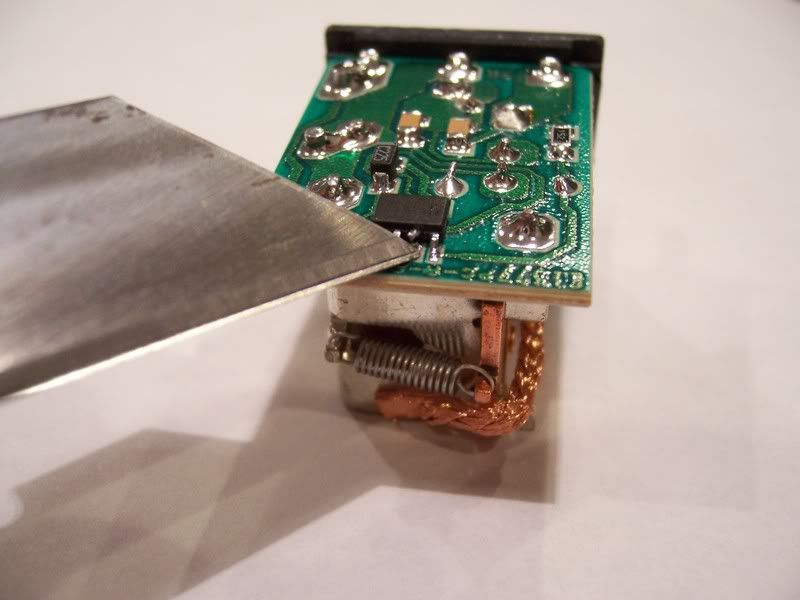

i am pointing to the leg on the ic chip that has to be removed
with the edge of the razor put the end under the leg of the resistor...and apply light pressure to pop the leg up...you can also use a fine tip solder iron to heat up the solder and then pry it up...but i did this with a razor
