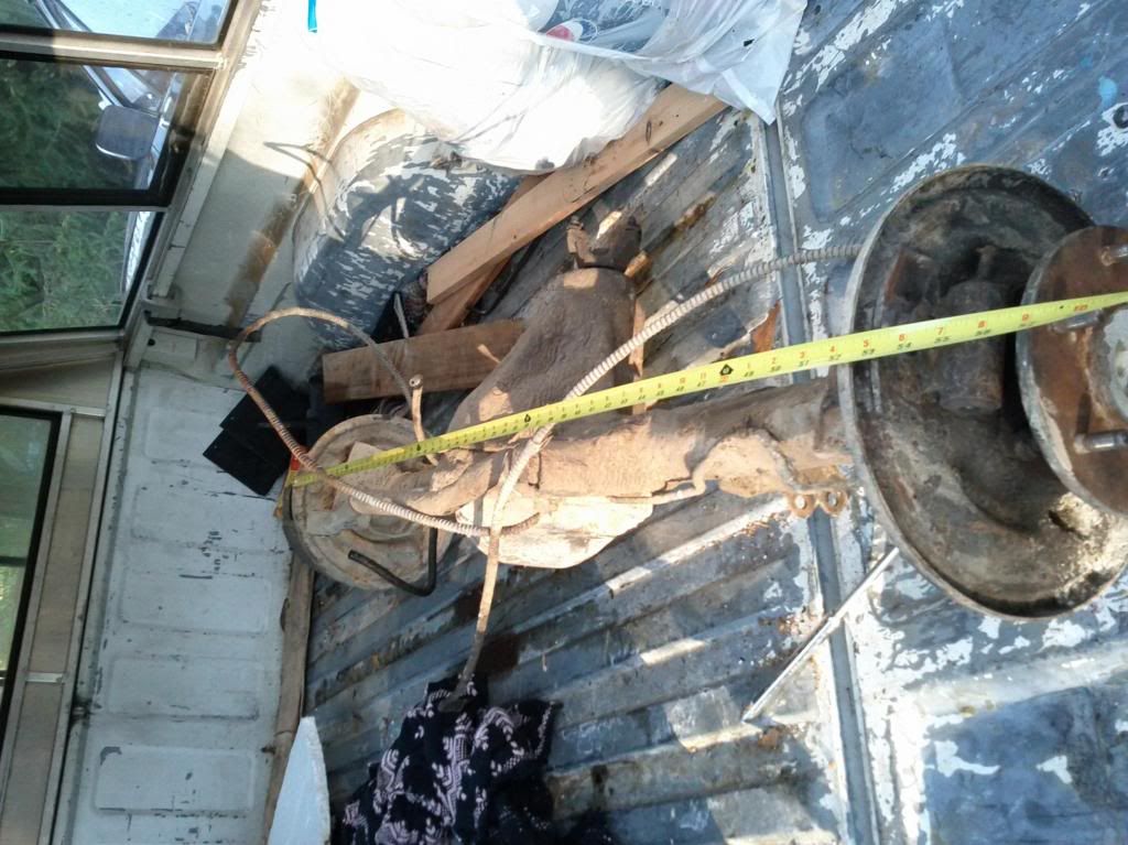

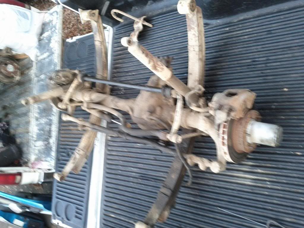

The Axles: 1988 D44s with 2.72 gearing :/.

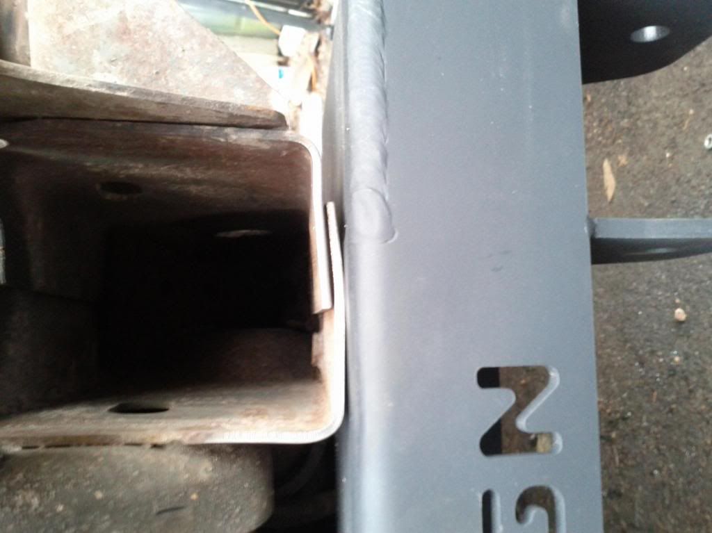

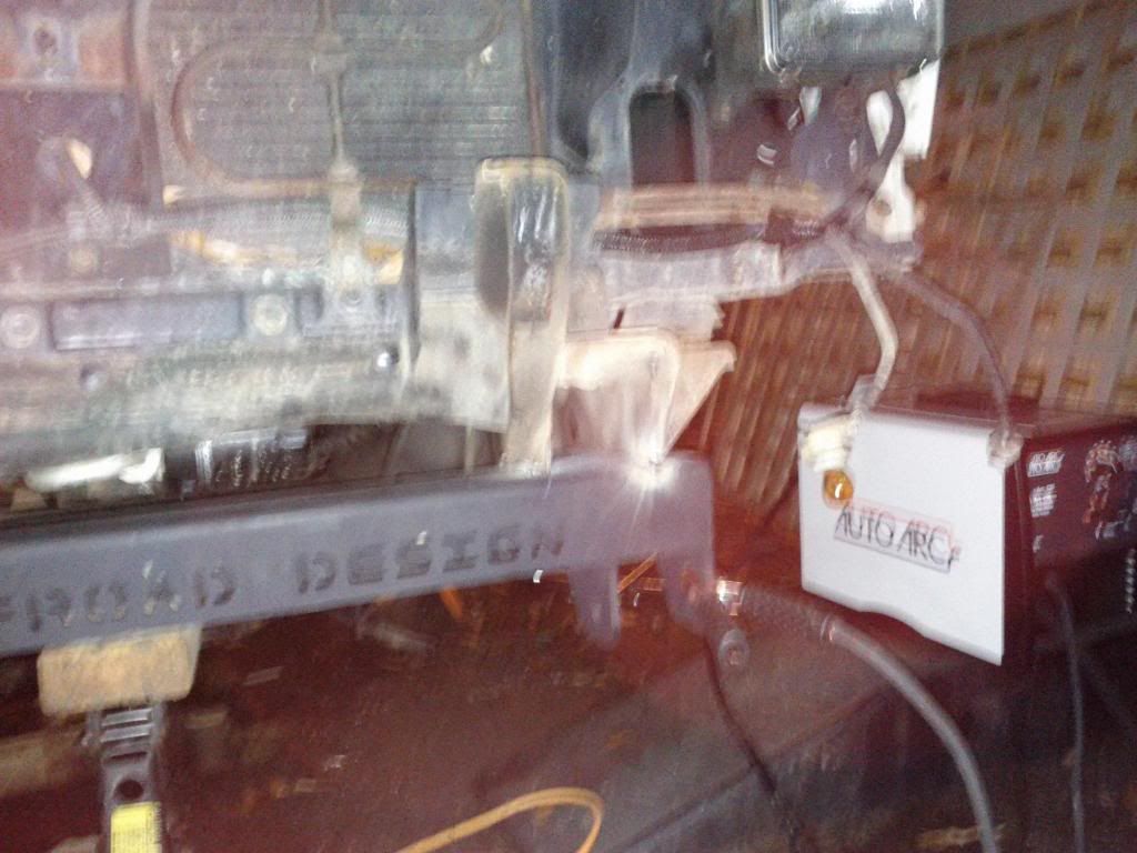

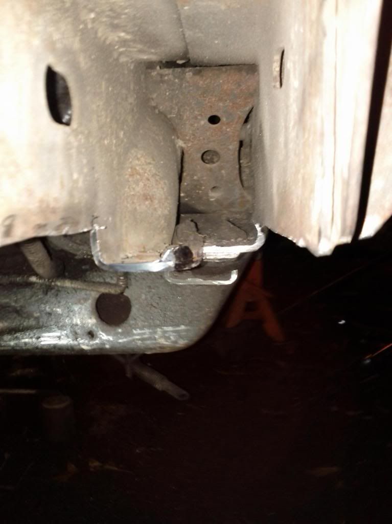

Welding the Sky kit on.
Thought this looked horrid so i notched the frame.
Passenger side.
Drivers side.
Crossmember tacked on.
All welded up!
Leafs bolted on, still gatta weld on the shackle mounts.

Thanks for the replies! I got the axle under it and holy shit this thing is huge... also got the drag link in and the steering stabilizer welded up to it today was going smooth until i went to put my wheels on and they wouldn't fit because the hub was about 1/2 in bigger all the way around. Would it be ok to cut the centers out and then run a bead of weld around the hole to toughen it up? They are stock steel wheels from a 2000 z71
5,228 Posts
What size wheels if they are 16s they Won't work with out wheel spacers to much back spacing
5,228 Posts
17s might clear
