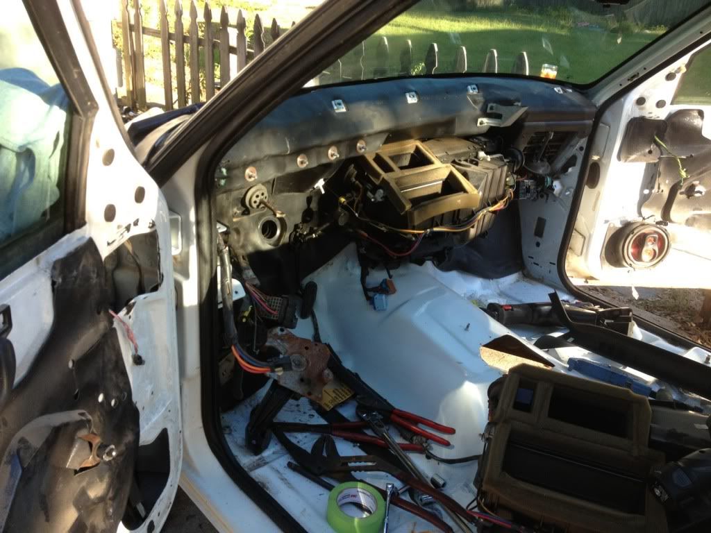

95-97 dash removal...I get a BUNCH of PMs and requests for this...it isn't that difficult,and takes about 30min with a few common tools,a zip gun,and no fear...
Here y'all go.

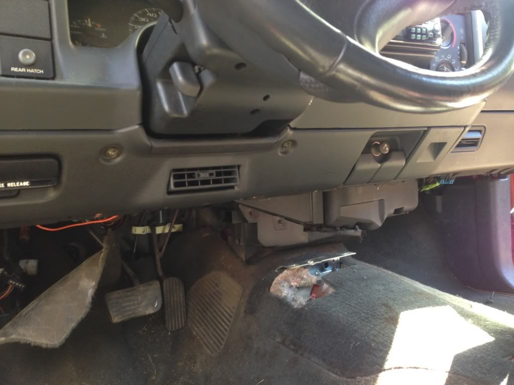

Remove all 3 lower plastic covers.(7mm screws,and one 10mm but near gas pedal)
Remove lower knee bolster/under column trim.(torx bitX4,a few 7mm across the bottom,and near center of dash)
Disconnect main column connector(7mm),unplug airbag plug(yellow),disconnect shifter cable(if column shift,pops right off),remove 15mm nuts X4,pull out column:

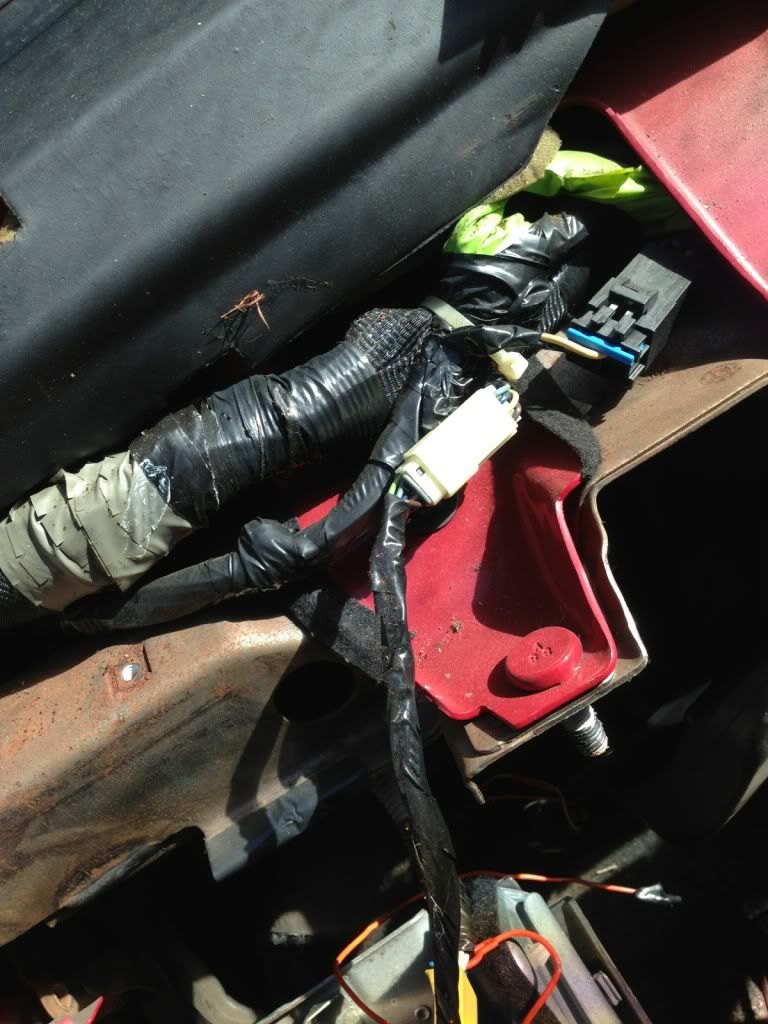

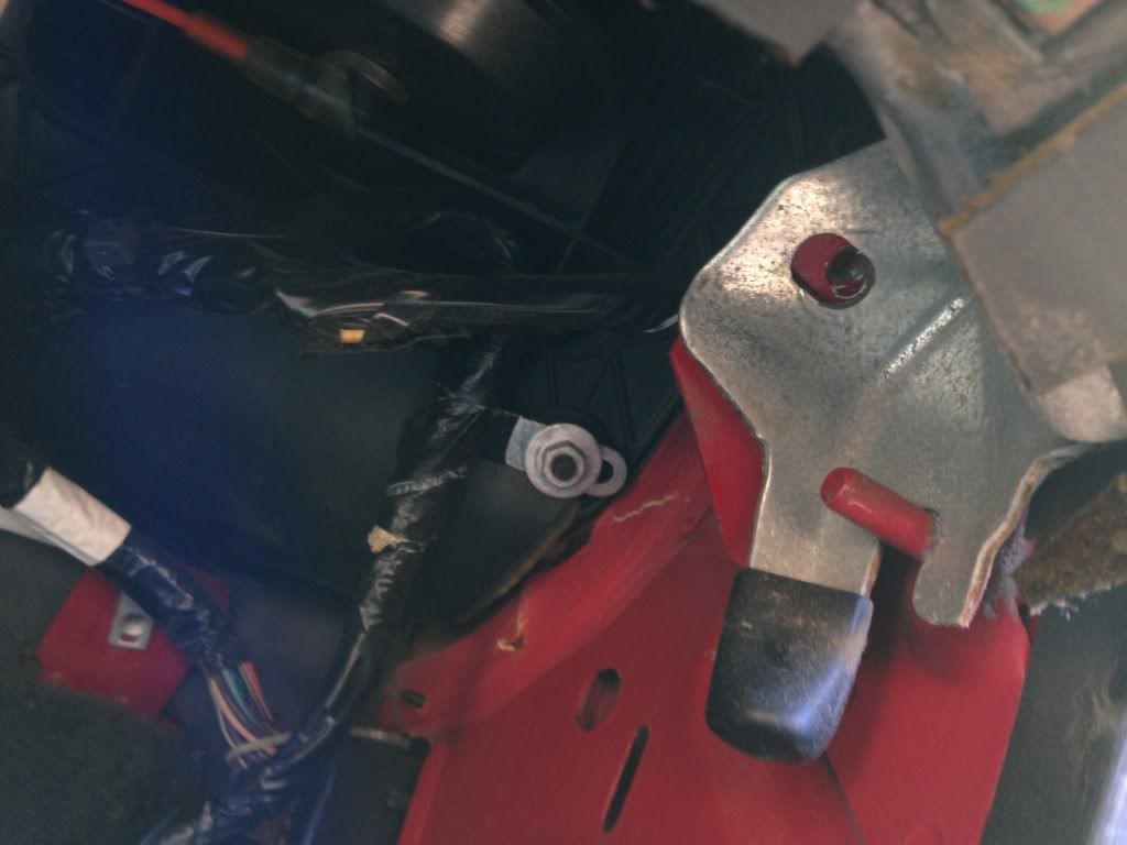

Remove all three 10mm bolts across the bottom of the dash,and unplug all connectors hanging under passenger side.ALSO disconnect antenna wire from under hood,and unhook it from evaporator housing..then pull it inside cab.

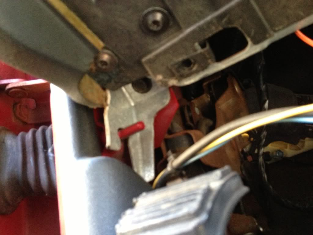

drivers side near parking brake pedal above kick plate.
center
Passenger side above kick plate
remove defrost vent&speaker grilles
Remove top bolts,and allow dash to tilt forward(7mm)

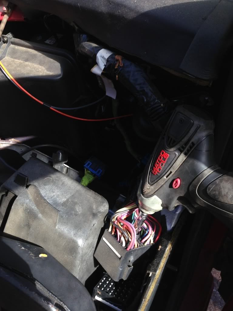

disconnect 7mm plug on passenger side
Disconnect HVAC vacuum lines at connector located in center.(4x4 models have an additional module plug close by,disconnect it as well if equipped)

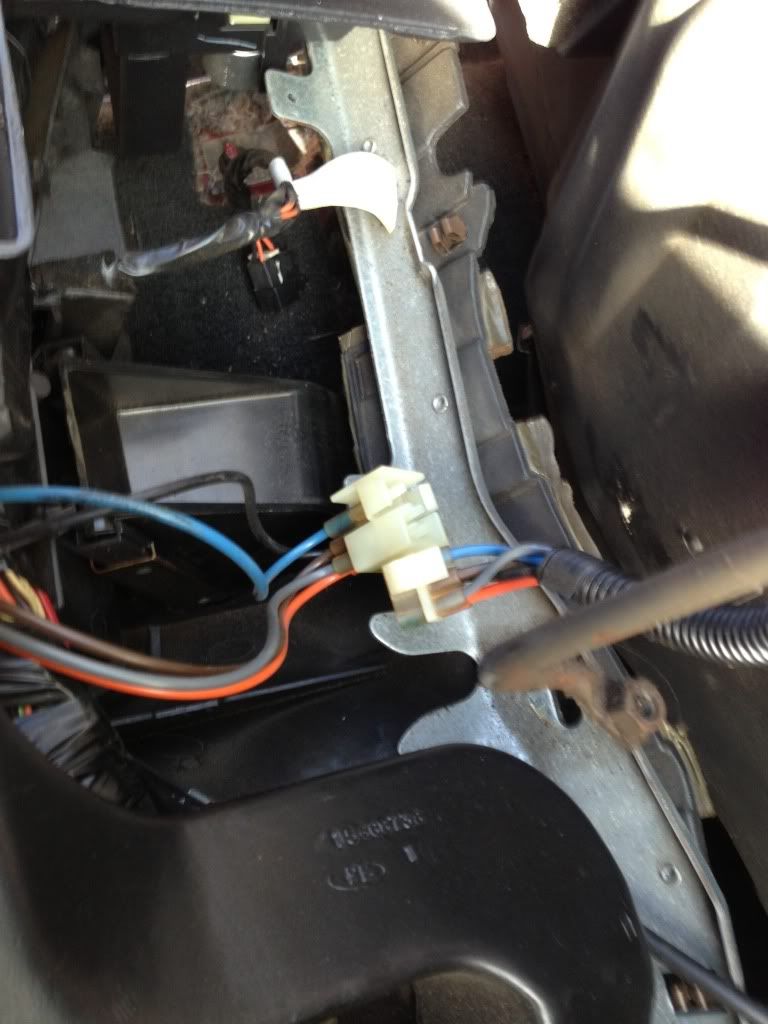

Disconnect plug to accessories jumper harness driverside,near column support bracket
Remove dash assembly.

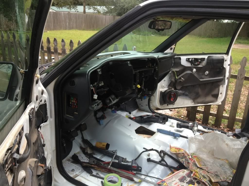

Buy a new dash,and forget it. It's more involved then it seems. I've pulled several of both styles,and nothing is the same.including the mounts to the cab itself.

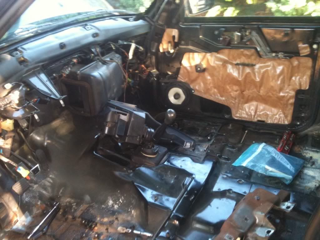

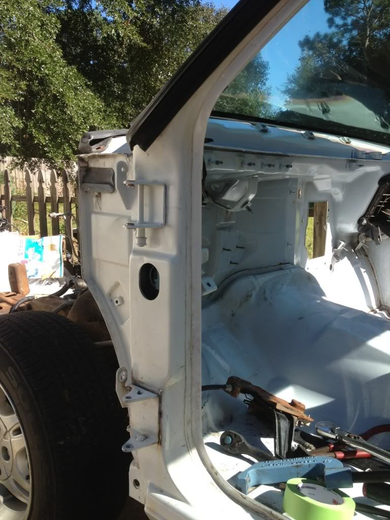

I don't have the ability to draw on pics:( but I hope you can see the big differences..here's pics from other trucks Ive rebuilt..
'99 bare naked
body harness&hvac box reinstalled
Dash pad reinstalled
'97 bare naked
you can see the structure around the driver's side is different,the pedals,column....all that are even mounted differently.
anything can be made to work with a welder tho,lol..except that cluster,and the headlight switch:haha: Ive seem them trimmed to fit a newer dash,but it looks bootleg,and honestly the 95-97 dash is a little nicer then 98&up in the way it's "built better" more parts..fussy lines cubby holes...little details.
