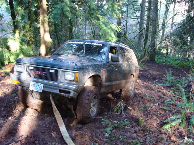

been wheeling it for awhile...
6
this is where i got to last wheel it and where i blew my front diff.
only 1 small spyder gear survived....distroyed all in cluding ring & pinion

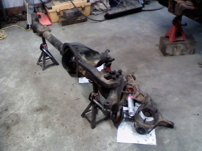

so it's on to the SAS right now..

going to be running Ford full widths 4:10's....
lp D44 with a Loc-Right
D60 with disk conversion and welded
This is where I'm at as of right now.....

almost got my front axle button'd up... painted my front diff cover till i can get a HD one...
just waiting to decide on which leafs to use on the front
going to use stock rears flipped and 7" perches with a 2nd pin mount 1.5" from center on the perch.
should clear 37"s (rear shackles will be rougly 8" I2I)
