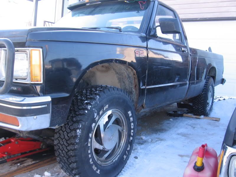

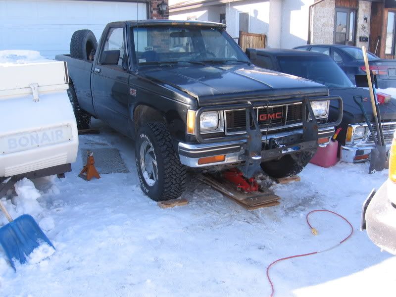

Recently i picked up a 85 2.8l carbed s10 4wd 5spd about 5-6 months ago and just blew it up..ive been researching sas and think im ready to do this..i got lots of fabricating skills up my sleeve....so i locally just found the guts out of a K5 blazer...front and rear diff 350 motor and auto tranni and transfer case...but i want to keep the 5 spd tranni...it should bolt up right...so today i pushed the truck into the drive way and started to tare out the motor and tranni...thought you guys would be intrested in watching...after i get my motor and tranni in the sas will begin...progress may be slow at first its still winter here...
