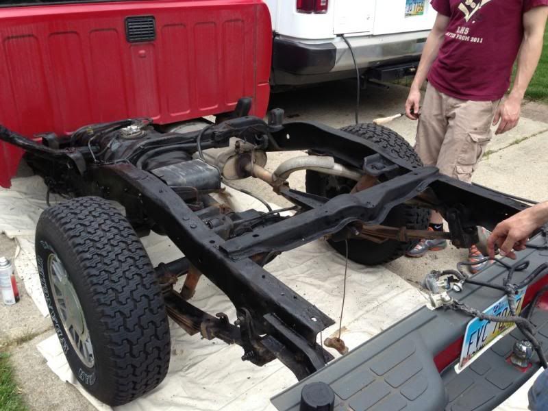

Well made some progress on saturday, but nowhere near what i had hoped. It was an uphill battle the whole way, i think i had to cut out half of the bolts i tried to remove. And whatever those clip things that gm uses instead of nuts are the dumbest things ever... Anyway we got the bed swapped and the rear frame undercoated when the bed was off, and also swapped the doors fenders, hood, wheels, and front end. the front end needs to be better aligned and i will probably have to take the fenders back off because there seems to be something pushing both of them out but i ran out of time and my parents wouldnt let me leave my truck in the garage overnight... heaven forbid my mom cant park in the garage for one whole night lol. Im still waiting on my coilover sleeves to get here before i can tackle the suspension, and im getting a ws6 steering box on monday so ill tackle the steering assembly as soon as i get that. Anyway here are the (not very good) pictures of the progress so far.
Undercoated the frame real quick.

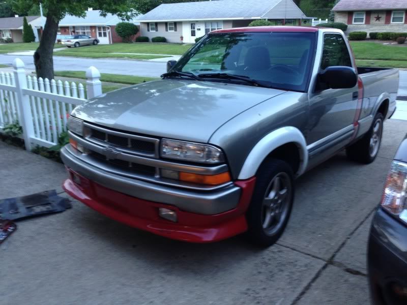

Small update, I put my xtreme valance on and test fitted a fender flare. I'm hoping to start on the suspension theirs afternoon and have it finished Saturday. Oh and I installed my Monroe air shocks, love those things!
My wife says my truck looks like its painted iron man colors lol.
Tons of progress in a short time. Nice looks like you got a good jump on things. Will look better with it dropped but why a 4x4? Not trying to be dumb but just wondering why you are doing a xtreme conversion and lowering a 4x4?
There are several reasons why I chose this path. First is so I can still drive a lowered truck through winter and if I need a little extra traction I can use the 4x4. The second reason is that eventually I want to throw in a lm4 or a l33 and convert the 4x4 to awd. The reason for the xtreme kit is for one I love the way they look and two it will help the truck look a little lower because being that I'm limited with how far I can lower it and I'm worried it won't look low enough.
surprised it hasn't been said yet.. DS headlight is in wrong :haha:
He headlight could probably use a little adjustment, but I don't think it's in wrong. I think it's the grill that needs to come up about half an inch. How I'm going to get it to do that though is a mystery to me since there is no adjustment. This truck was wrecked previously and I didn't find out until after I bought it how much it tweaked the front end.
