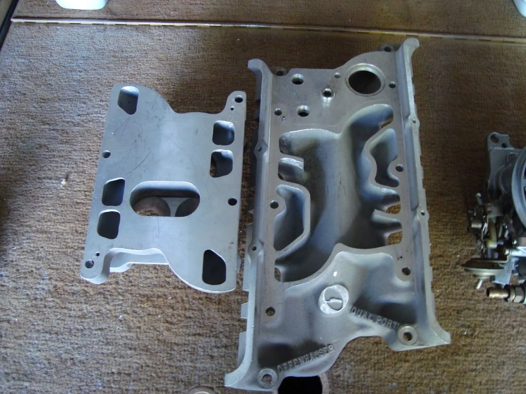

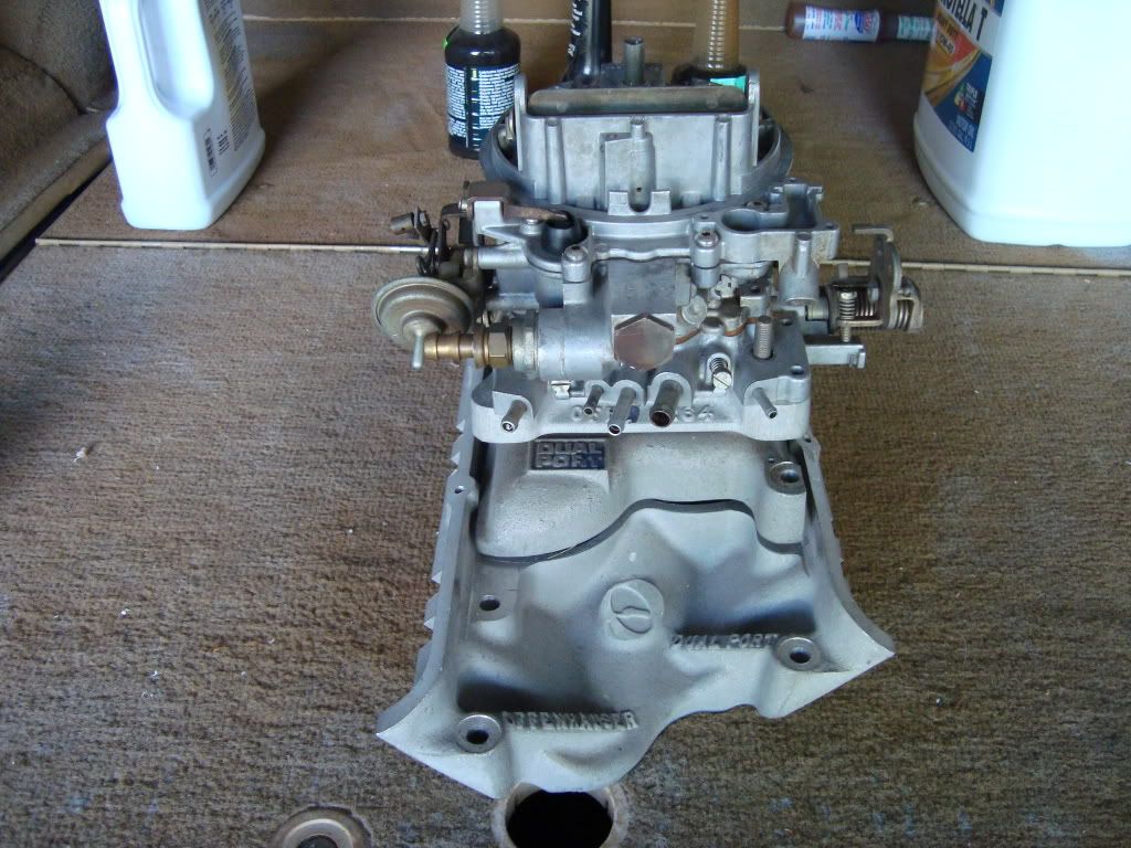

1. The common Edlebrock intake. It offers 2 intake tops, one for the stock 82 - 85 Rochester, the other top is for a Holley 4 barrel.
2. Offenhauser makes a "Daul Port" 4 barrel intake which is VERY rare.
I don't know how welll this works, I have never used it.

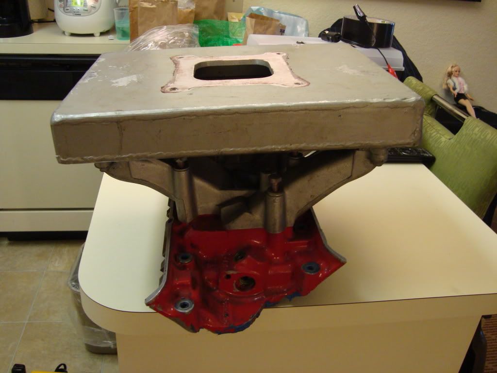

Custom built...
Tunnel ram intake. Probably not too good for a street driven truck.
Anyway, you get the idea.

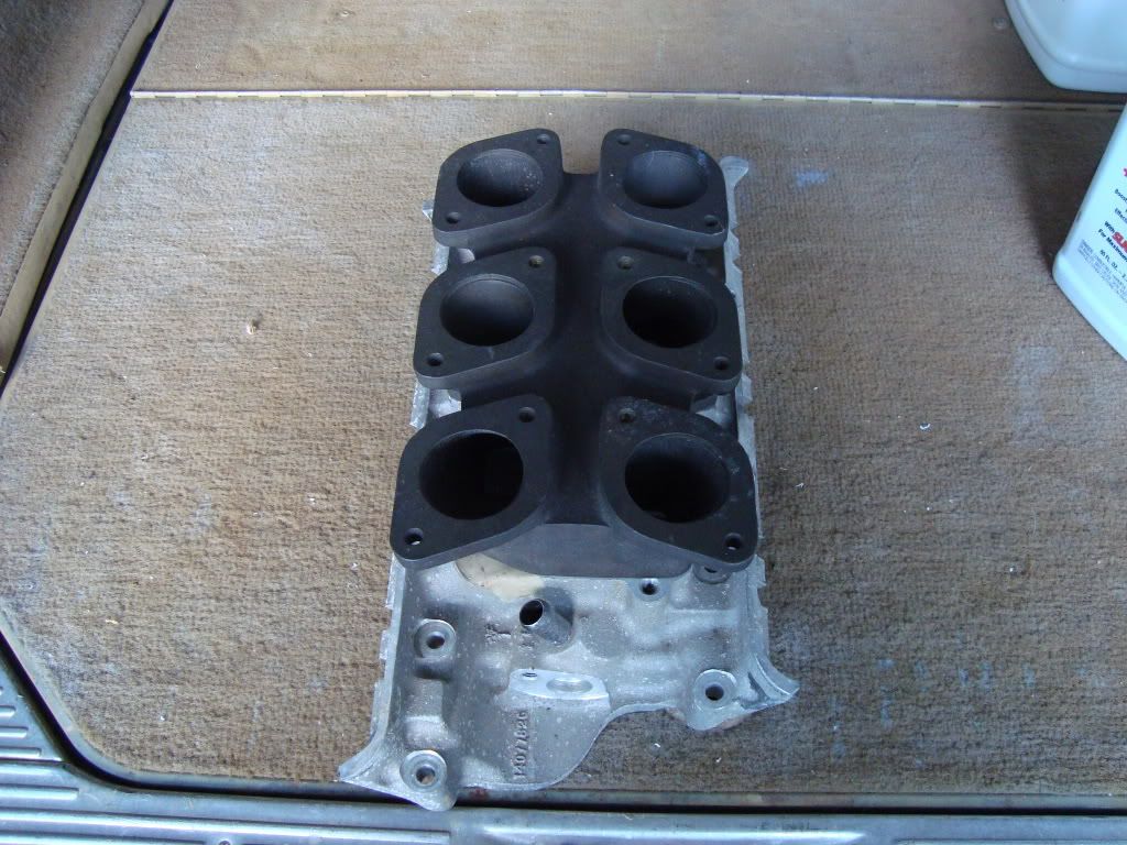

Here is a one off custom intake for 3 Weber 2 barrel downdrafts:
I will have to custom machine alot of parts to make this work. I have never seen another like it.
