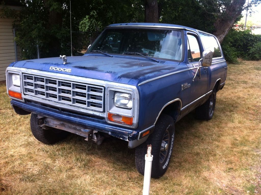

Well, this was given to me for Christmas in 2010. It was basically a shell since the engine/transmission have been removed. It's been sitting at my Grandfather's and I've been trying to get a chance to work on it. Well, I've finally pulled the trigger and trailered it up to my College so I can get it trail worthy for now.
Stock configuration.
318, 727 transmission, NP208 transfer case, 9-1/4" rear end (locked...but I haven't checked to see if factory or aftermarket). Dana 44 front with CAD. 32" tires currently on 15" rims. It was picked up mainly for the parts inside of it as it was used as storage and the owner tried to swap a built 383 into it, but failed with the build and didn't know what he was doing.
This is what it looked like basically when I got it.

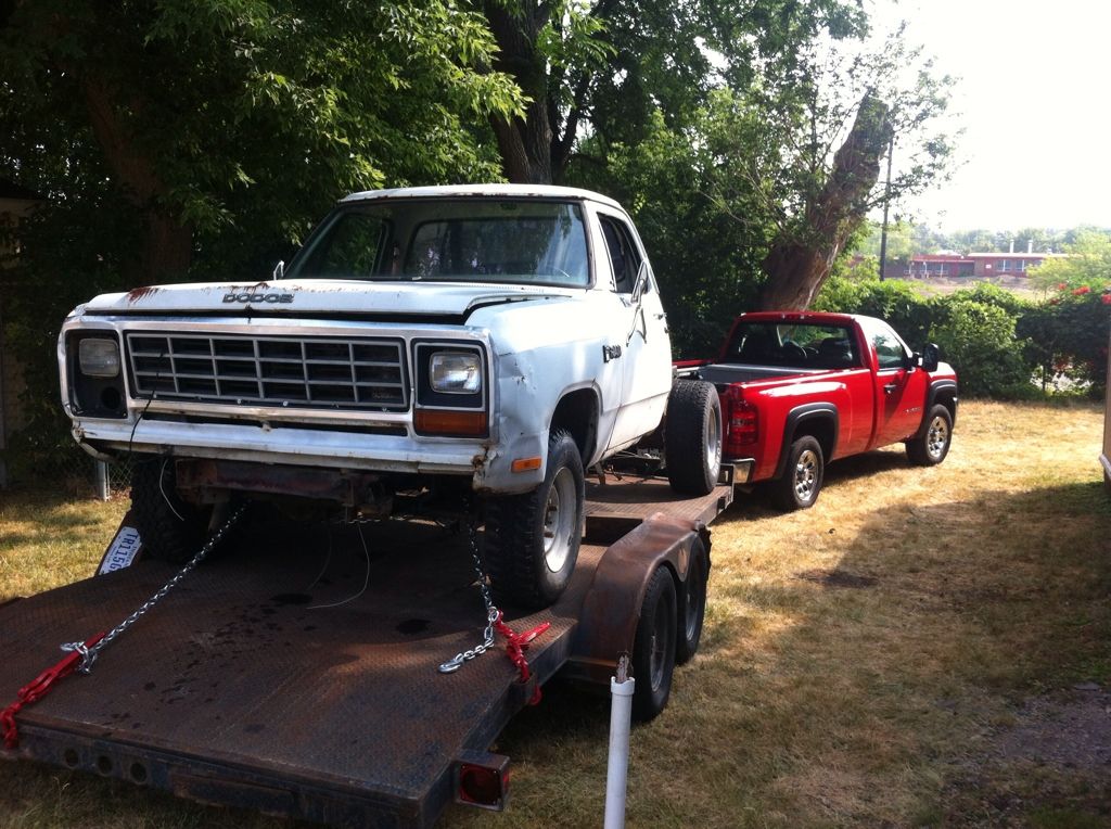

This past weekend I brought the parts truck up as well.
And a few pics of my RC versus my Silverado.

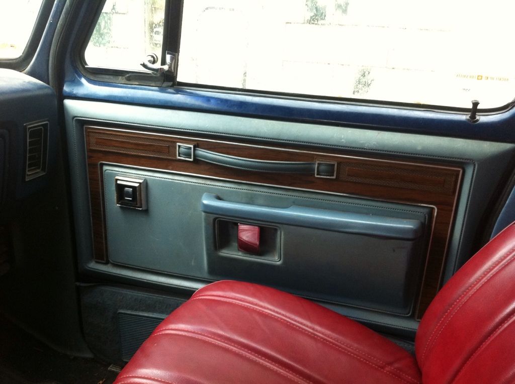

Door panel back on....but power windows are inop.....so maybe bad switches. I'll play with it more after the motor swap.

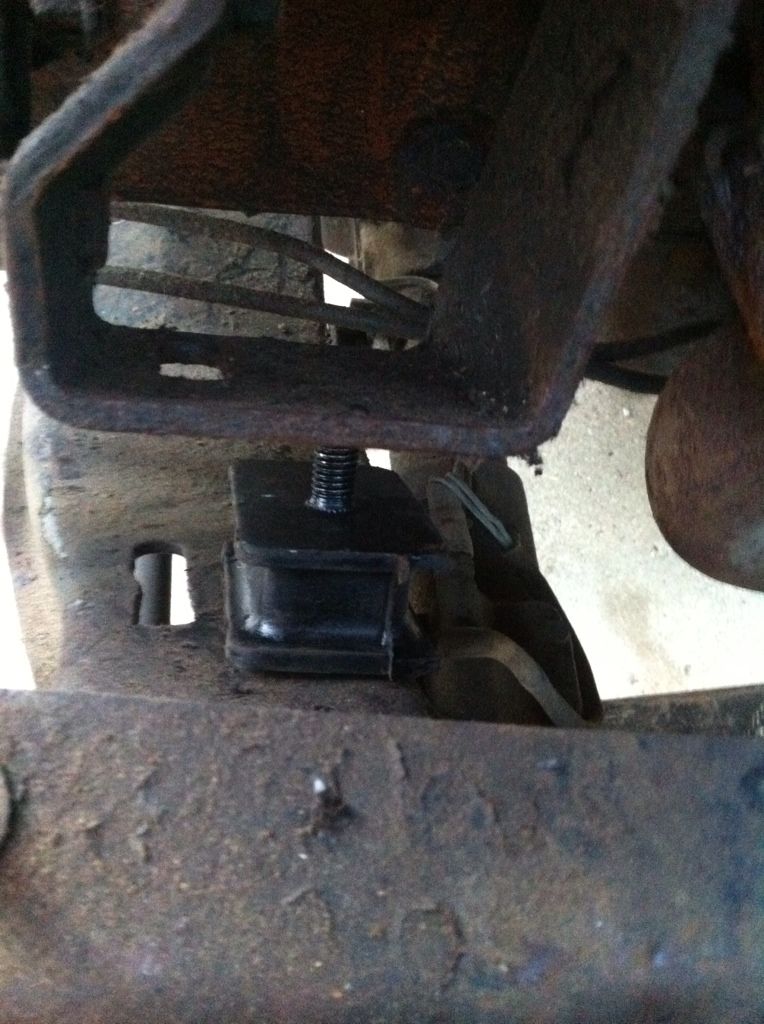

Had to move the metal motor mount in front of the engine tabs since the previous owner had put them behind...which gave me about an extra hour of work since I didn't know how it was supposed to be until I couldn't get it to line up correctly.
