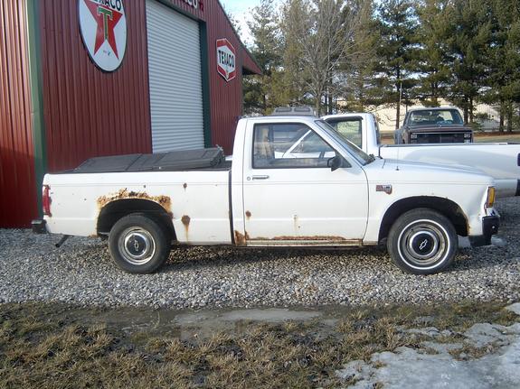

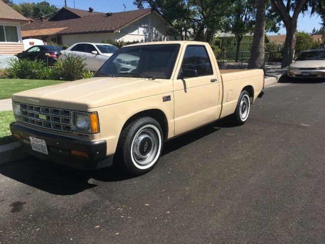

Like Mo says, the usual places. Rockers and cab corners are not to hard to fix if you have a real mig welder. The thing I always check is the 4 or 6 body mounts where it bolts to the frame. If that area is rusty, it's usually not worth fixing.
In CA it should look like this:
Not like this:
