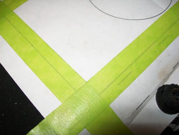

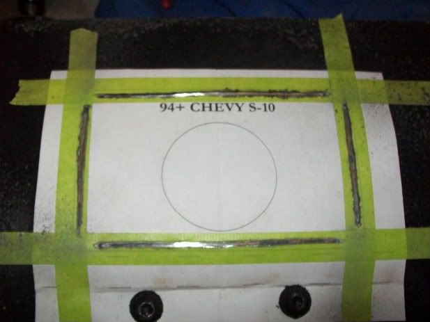

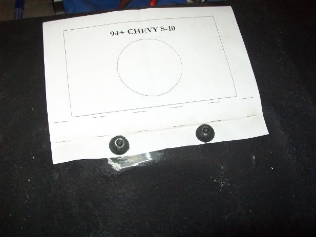

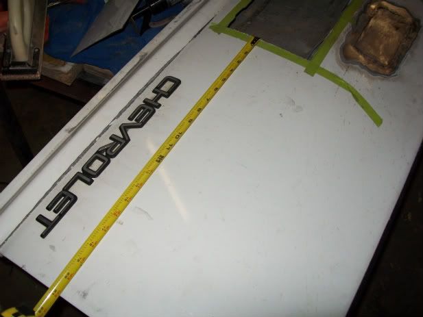

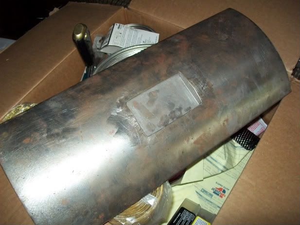

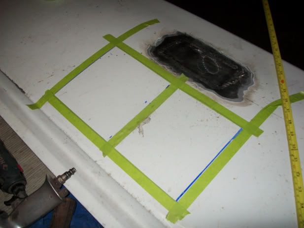

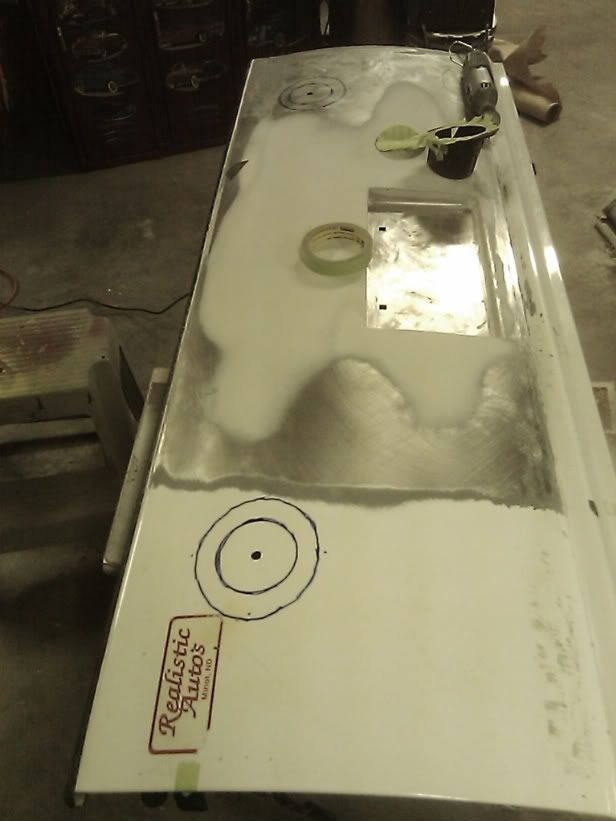

picked up a tailgate from the truck yard just incase i effed it up i would still have my stock gate.... i guess this could be a how to for the SD tailgate handle relocate
I just poked holes where the holes were and stuck the bolts in to get it close
making sure its even
Tape it up , you can see the lines through the tape
cut inside the lines , never on the line so you can trim to fit, FYI for the ones who dont know

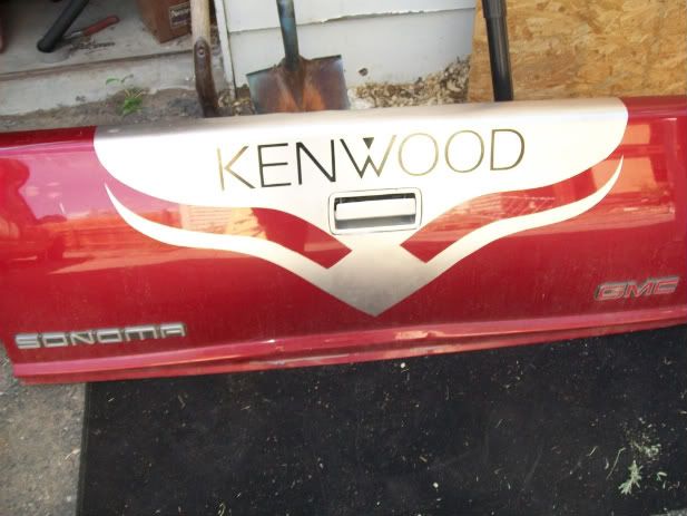

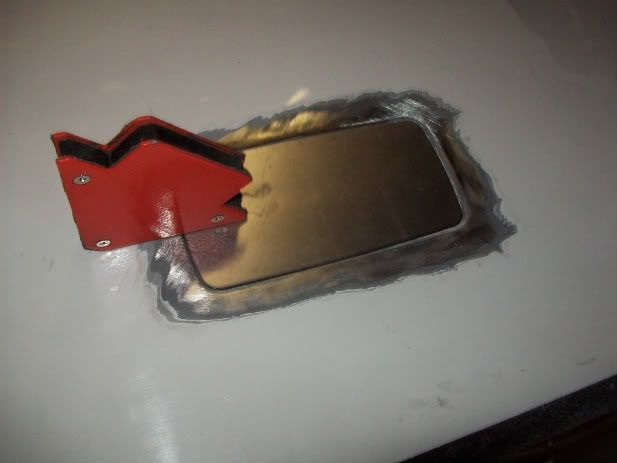

turned out good except for the weird angle of the handle but oh well .. also i might add before you screw the plate down get someone to hold it in place while you pull the handle andmake sure it pulls the latches equally, where i was going to mount this one one side didnt pull in all the way so i had toslide it over a hair to equal it up, maybe not a big deal for some but just a heads up

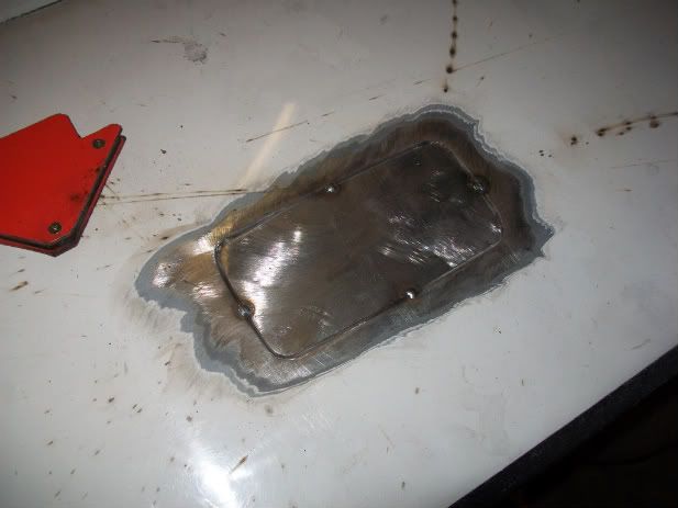

Re: Project: Rejuvenation 99' Noma

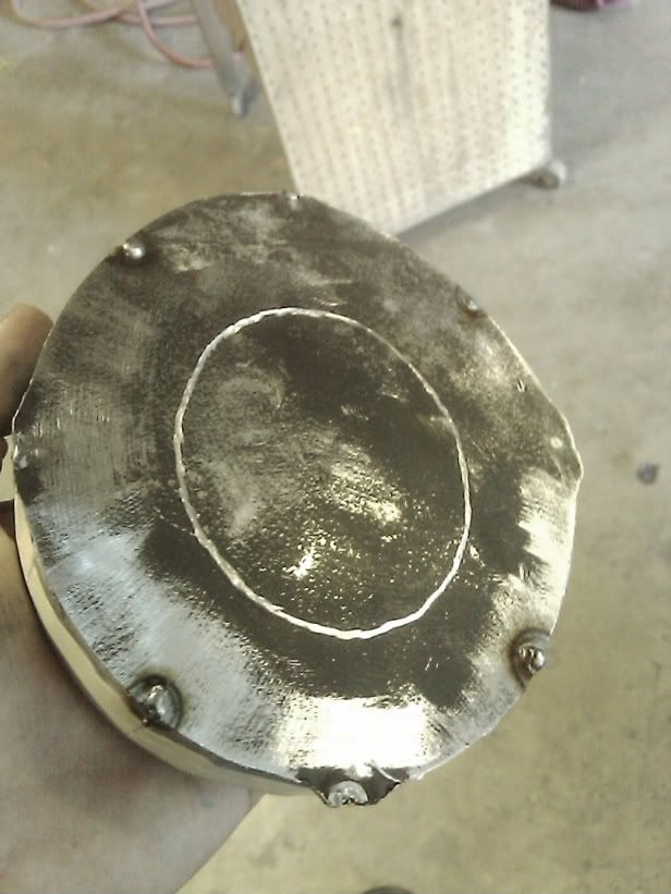

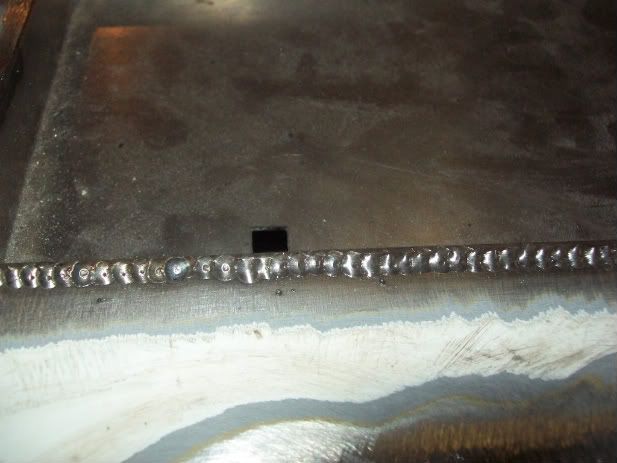

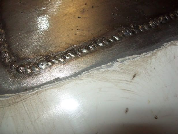

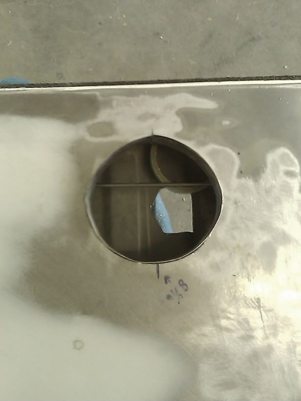

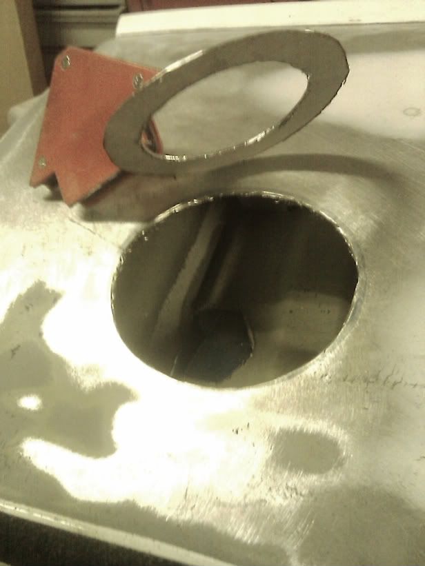

shaving the old handle hole
first few tacks to get it to stay

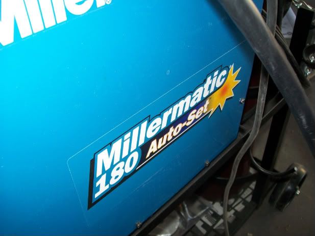

first time using this new welder but it came out alright, could of had some more heat but it worked, before this it was 2007 when i welded last so gotta get back in the groove.. you like the BIRD SHART weld on theleft side? i dont ( not sure what happend there)
next is the license plate box under the old handle... post pics later
ALERT if anyone wants details on relocating handle i have more detailed pics , might add a how to to Suicidedoor section because i got it from them but until then if you want pics let me know.

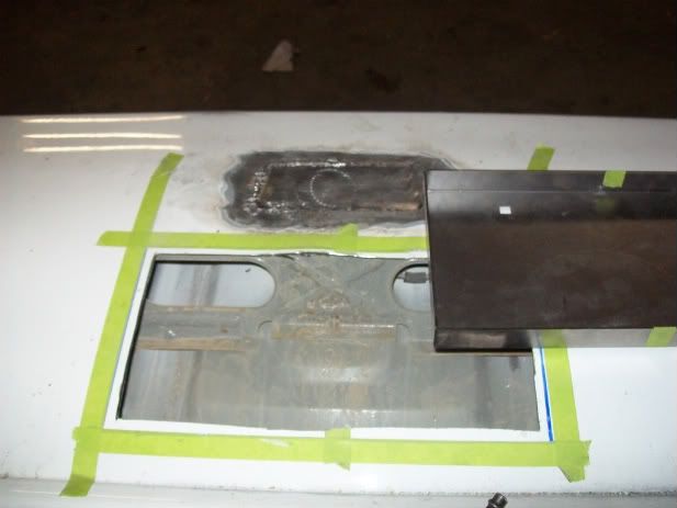

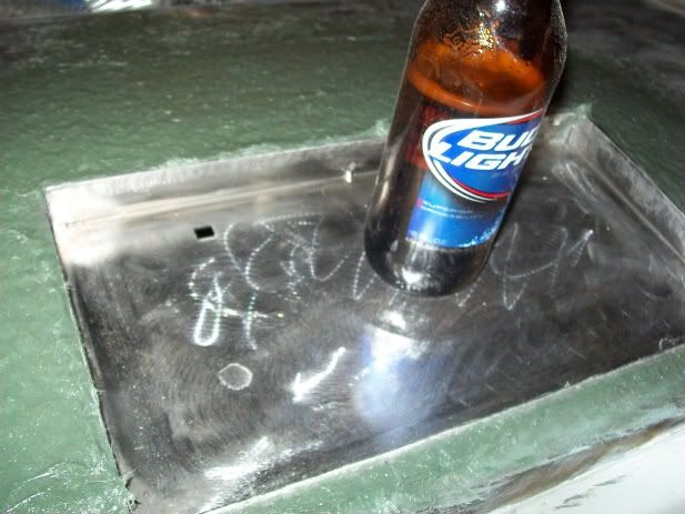

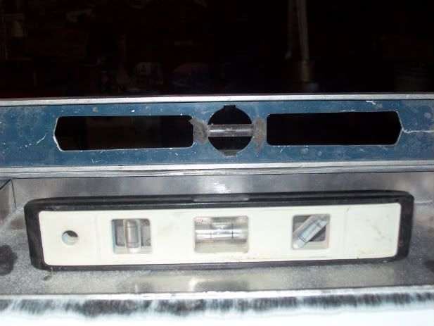

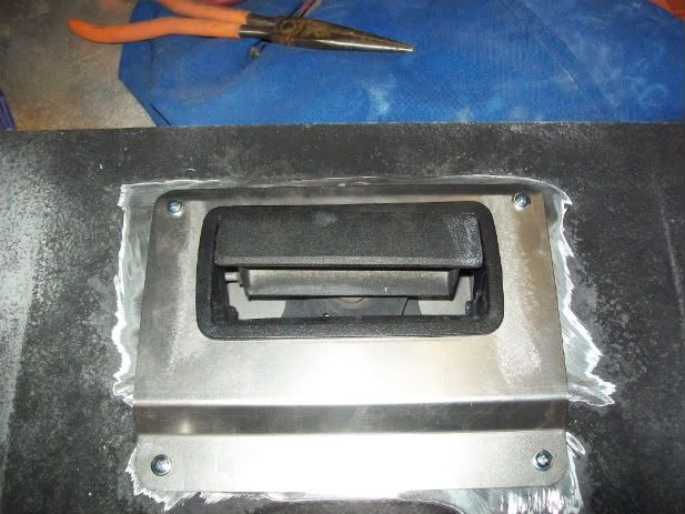

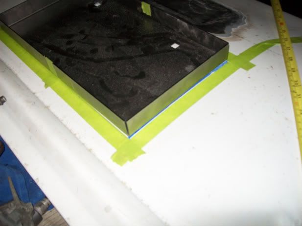

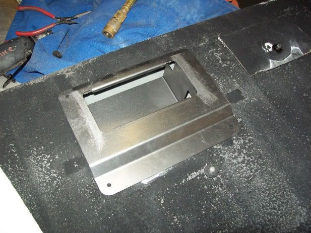

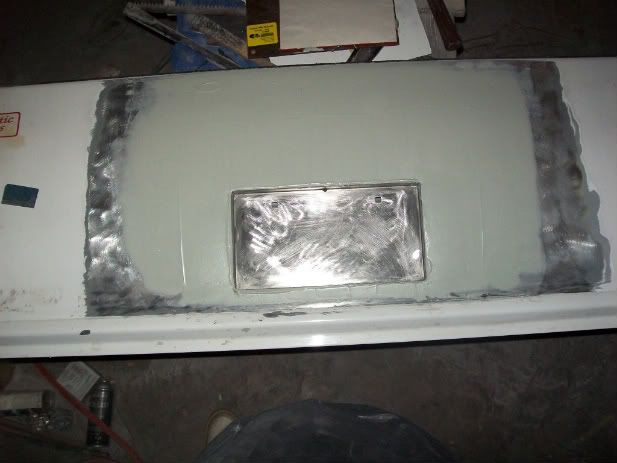

I marked the centerline of the license plate box and the center line of the tailgate... lined them up together and marked around them....
got it cut out, yes i warped a little when i welded in the handle filler, its just in that spot.. and i also found some body filler on the right side of the hole for the box.

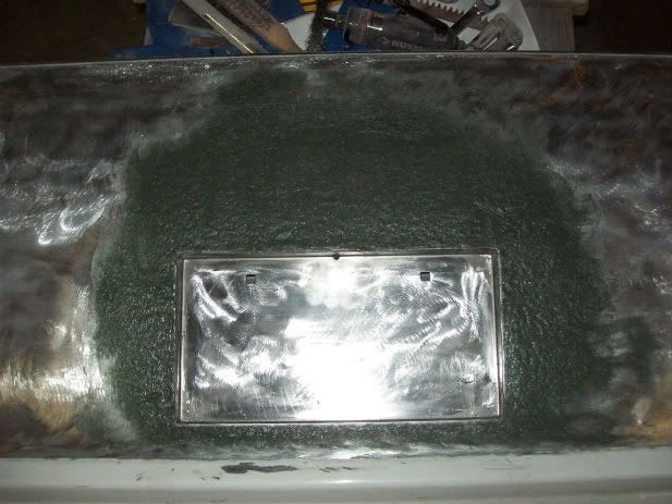

making sure the hole is the same on both sides. close enough

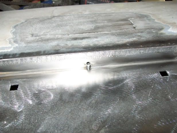

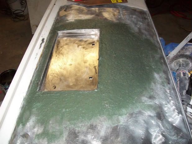

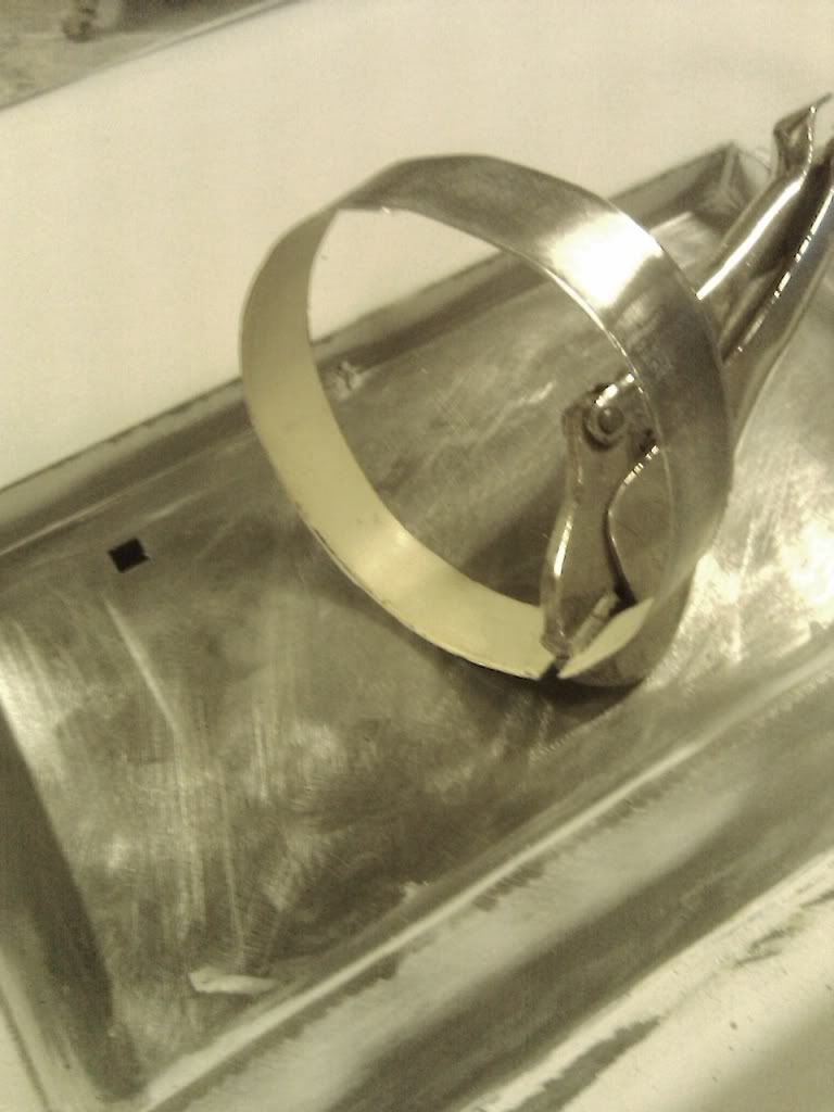

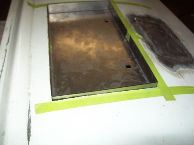

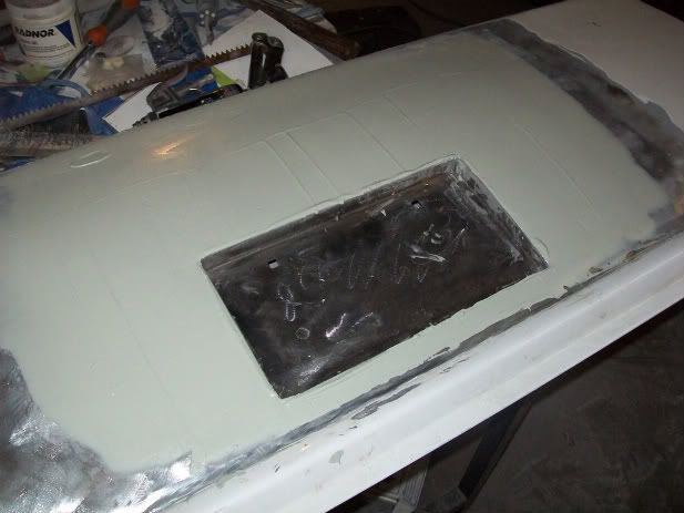

putting it.... i actually ended up sinking the top ( closest to handle) in almost flush with the tailgate skin and pulling the bottom out a little more than it is in the picture... so its at an angle. looks good that way
level the gate and make sure the box is level and shes good to go
not happy with the welds but ohwell. maybe find out i need to fix some spots when i grind them down. but thats it so far ill post more when i get the box finished

on the last pic, it looks as if you welded it with the box higher than the gate metal. when you flap disk this down, wont it just "eat" away the welds? looks good other than that. aslso the grille looks pretty cool man, dont destroy it, you might be able to sell it for some extra change
Slappy McNasty is offline
post #11 of 121 Old 05-22-2010, 10:29 PM Thread Starter
GMC so-low-ma
Bigmyksonoma's Avatar
Join Date: Apr 2009
Location: Southern Colorado
Posts: 274
User is: Bigmyksonoma is offline
Send a message via Yahoo to Bigmyksonoma
yeah i did your right.... ive already grinded it down with the right contour as the tailgate ( you can see in some spots the hair line line of the metal edge)
and im re welding it .... i only got that one side welded in until i realized in wyotech when i made a rollpan with a frenched plate box i cut it to fit and then spot welded the corner edge where the box and skin meet.... just had to remember the way i did it in wyotech haha... but yeah i posted the pic cause the welds were not bad lookin and i dont have any newer pics than that one.... well i wasnt gonna destroy it i had another grill , i was just gonna stick that in the back of the garage somewhere.. maybe if i touch it up a bit it may look better. i have a billet grill i just have to cut in half to fit and it might look better...... thanks for

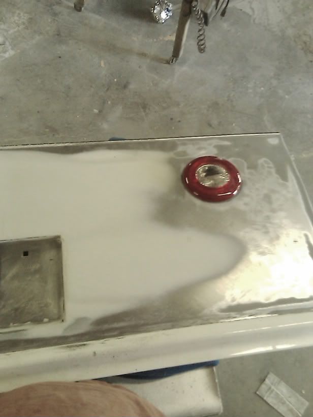

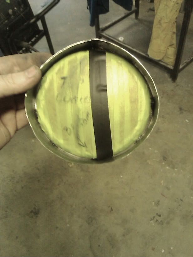

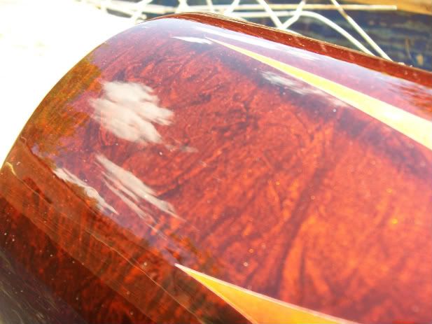

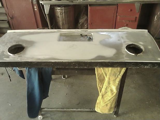

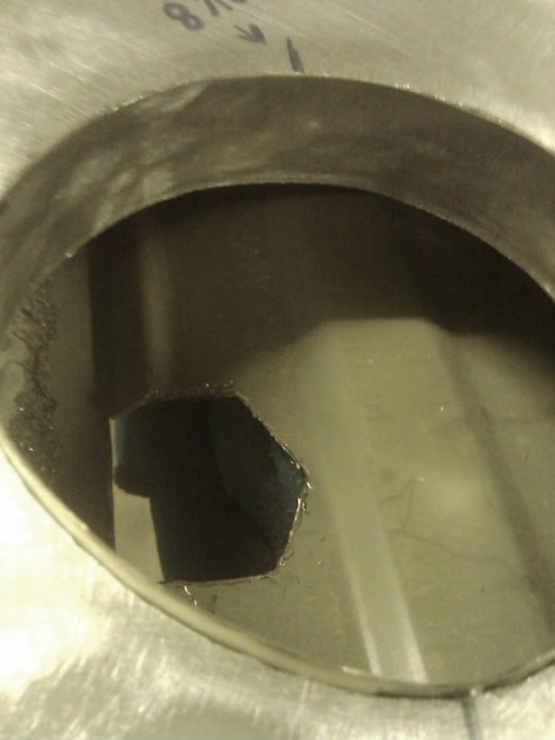

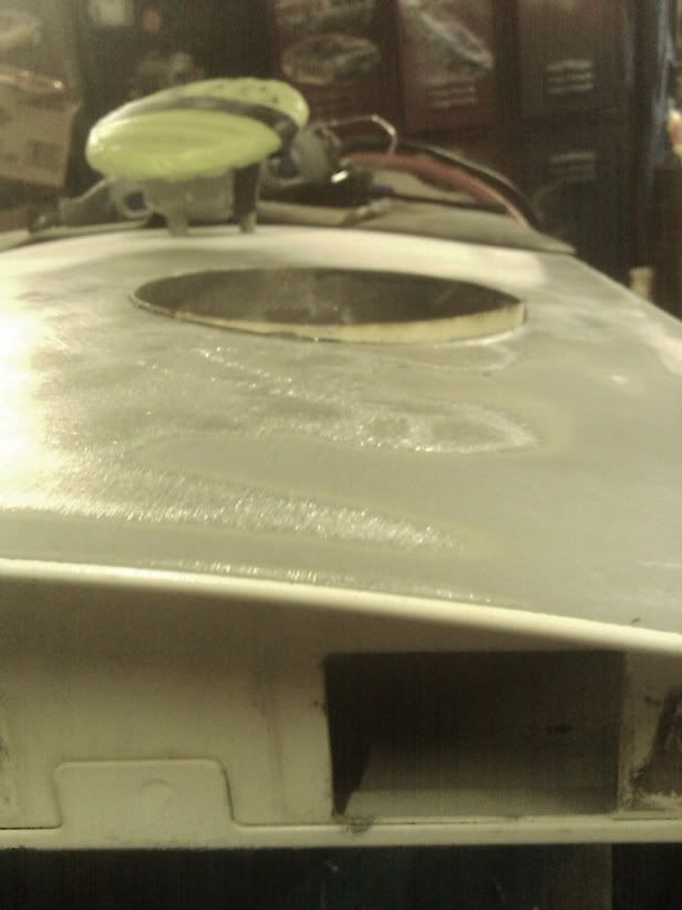

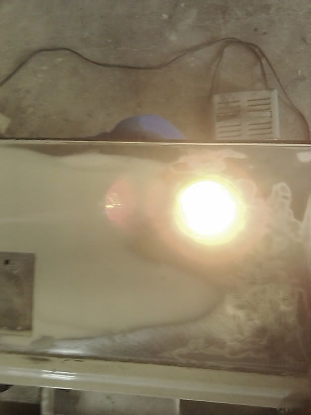

postin a few pics to keep the pics rollin in. almost got the tailgate ready for filler so ill have pics of it soon...until then
My dog Rocky up in the tree again
i found my WyoTech Mailbox i built and painted myself. i think its badass, would like to use it as a mailbox but i know it would vanish or get hit with a bat or somethin haha, Black base with silver marbellizer, with candy orange in the back faded into candy red, then taped the graphics and added the shadows
airbushin is sketchy but it was first time, was too close when i airbrushed

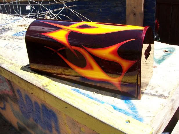

^ that was a grind box i built by the way for all you skater/BMX riders

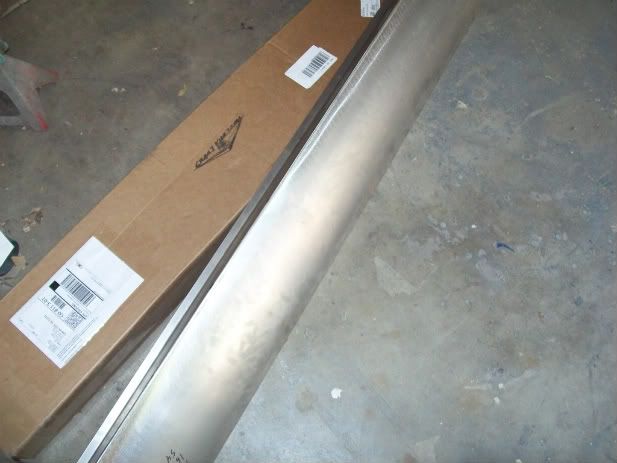

this is the roll pan i got in the mail today

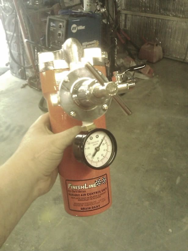

This little guy will come in handy, just got it few days ago
my welder im using, maybe someone would wanna know

alright this thread isnt too popular , but it is kinda boring stuff so far. got some more stuff done....

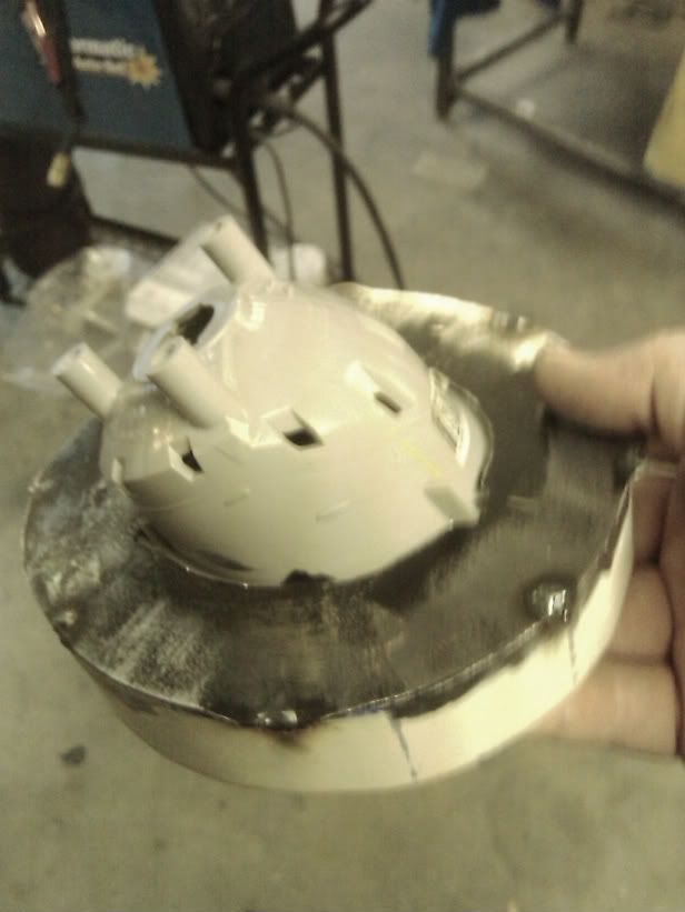

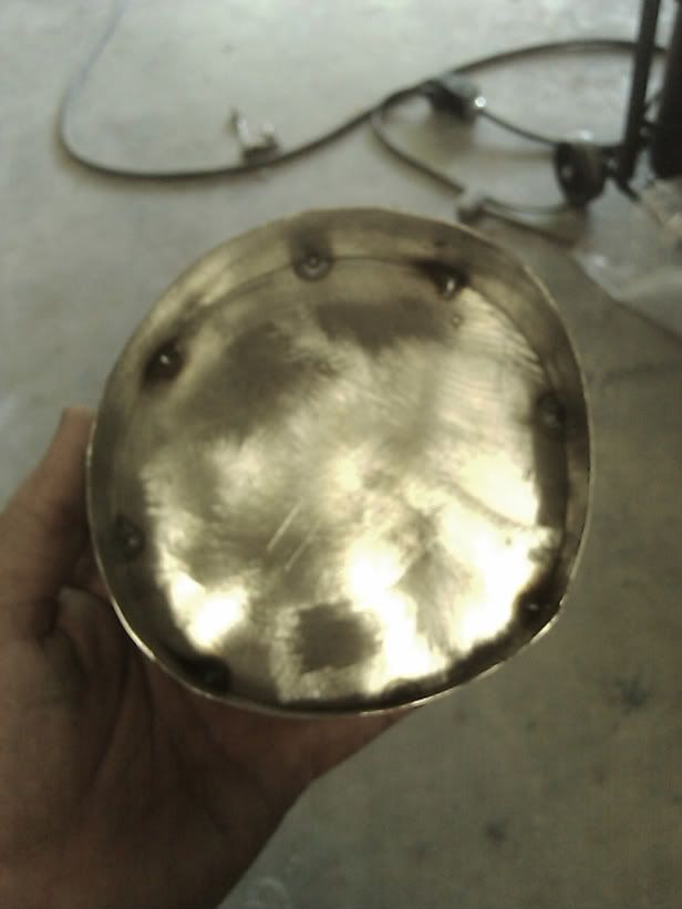

heres a tiny roll pan i built in Wyotech.
this is the hole for the license plate light wires and the weld under it is welded to the inner structure to avoid it vibrating because it was right up against it.. if you think i should grind it smooth or leave it let me know, the light will cover it
glassed in finally, just took this picture like 10 minutes ago

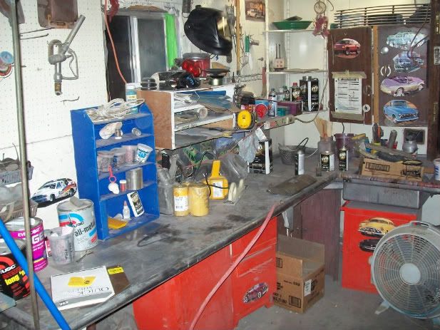

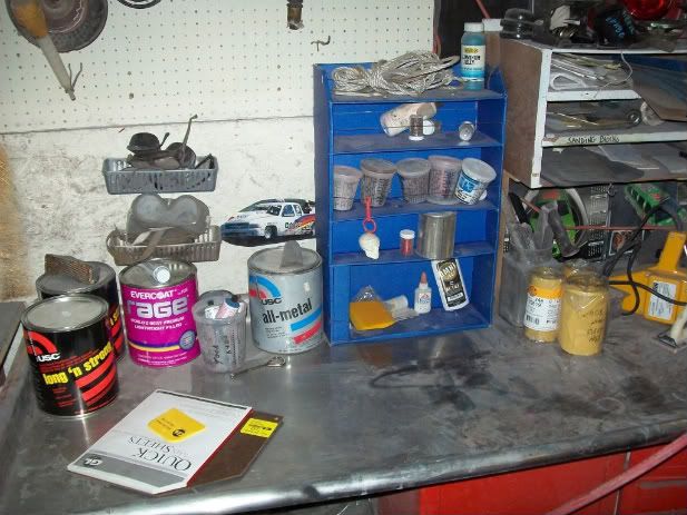

and my filler/paint "station" kinda cluttered
and what are these!!??

tackweld in place,
Spot weld( not continuous)
flap disk
Kitty hair(fiberglass) to get it close
then bondo/bodyfiller
Prime
blocksand the primer
seal it
paint it

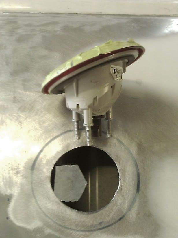

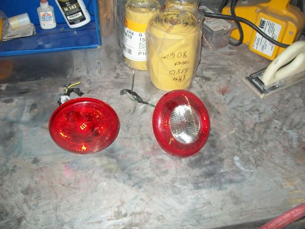

alright some progression pics , had to use my phone on these cause i almost didnt take them cause i didnt have the camera but it works. and dont flame for the body filler, not 100% sanded yet and yes i warped the handle area but there were alot of hidden damage wround where i put the license plate box, you can see filler in some of the old pics. but if you must flame, flame away ......

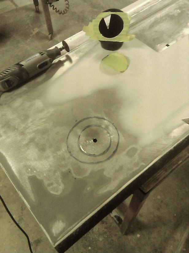

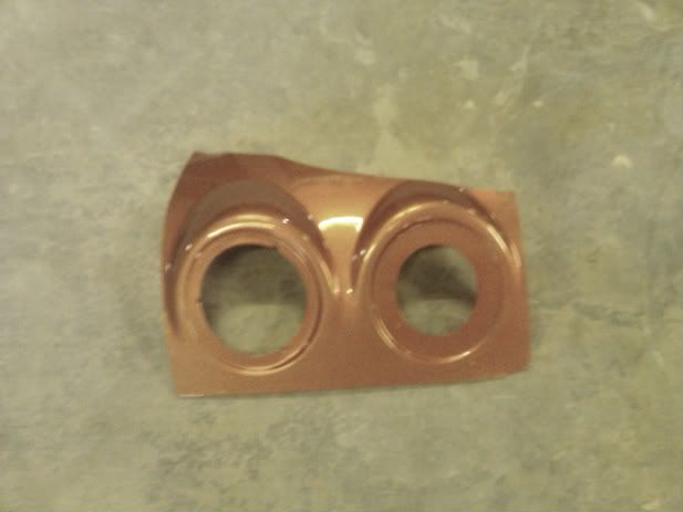

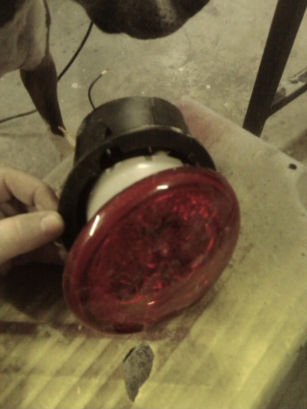

heres the roughout of where the lights are gonna be, the little hole is where the center is ( measured 4 times times to make sure it was the same on both sides). the bigger circle isnt accurate so dont look at that but its about how big the hole will be eventually....i wish i could put them to the side more but the latch assembly is there it should look good though
gotta love the dremel. see im just cutting the hole big enough to set the light in and line it up to trace around it to get the position right cause im frenching them in...

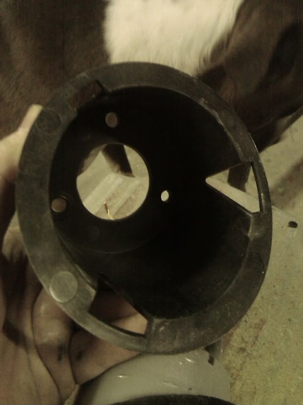

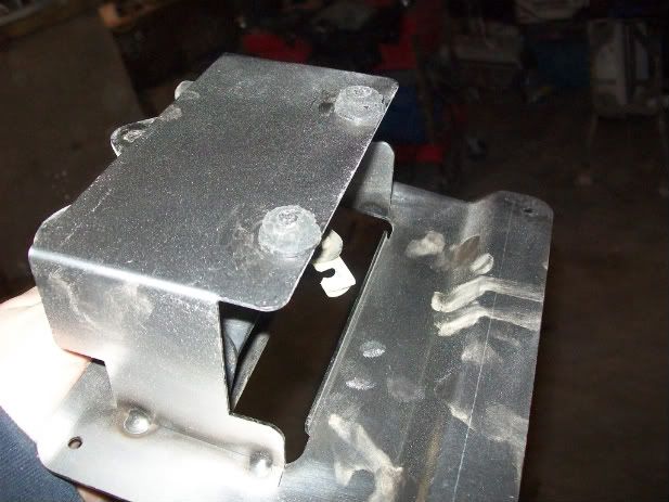

and these are the brackets i was waiting for, the black piece. ill put the lense from the outside then the bracket goes in from behind and pretty much pinches the metel in the middle to hold itself in. pretty simple design for making them work

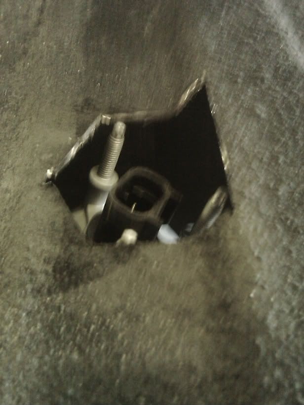

i got excited so i had to run inside and post the pics even though photobucket took 8 years to load them. but heres some pics....

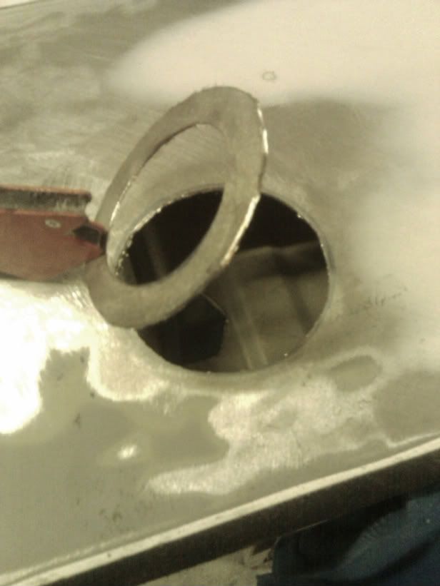

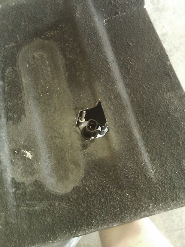

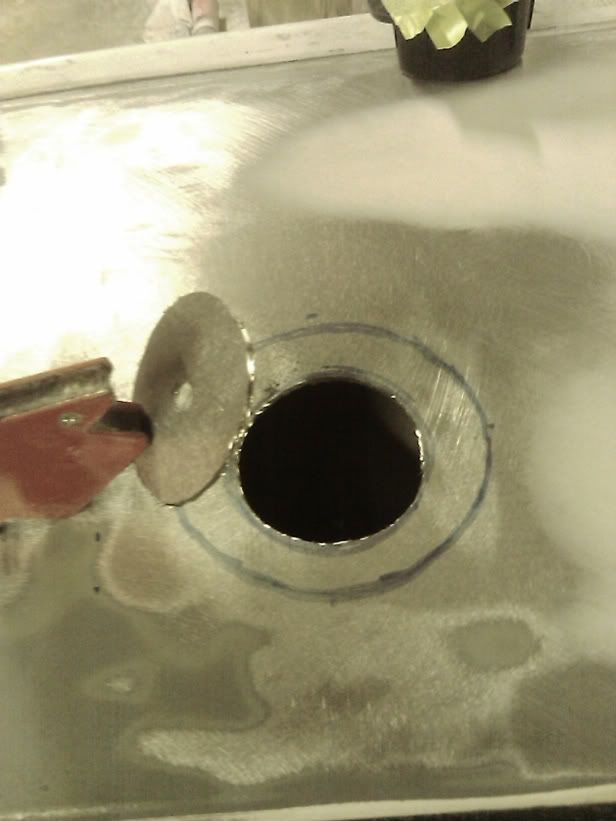

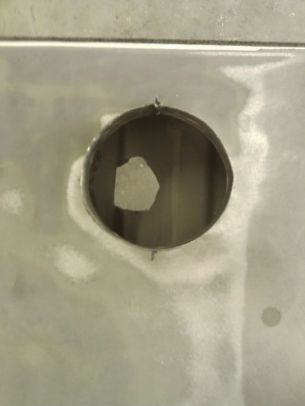

i drilled a hole and cut some of the back of the gate out to see what i was workin with. it will be a nicer hole when im done

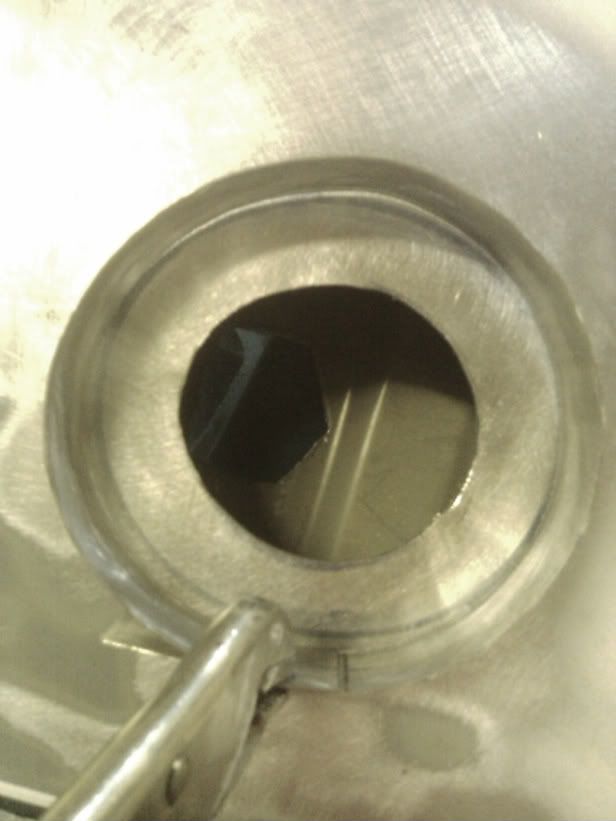

got the hole dremeled out to where i could set the light in and i DA'ed the marker off and then traced around the light to make the actually size hole that will eventually be there.

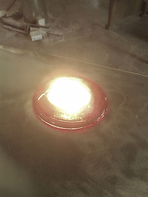

Sexy isnt it?? i thought so. even more when its frenched in
well callin it quits for the night, dont wanna piss off any nieghbors with my cutting and thats pretty much all i gotta do now lol... anyways heres the other light in, If i had my stupid camera i would get better shots but this is from my phone, ill get a farther away shot tomorrow....
and this was my failed attempt at the frenching pocket wall thingy haha... i wrapped tape aroung the light thinkin it would work good as a measurement, peel the tape off the light and lay it straight over metal and cut it... UH NO its too short, but you get the idea what i gotta do, i am halfway through cutting a long as piece that is a little wider too cause i realized i need to have room to adjust the depth.. im hoping to get about an inch deep after its all said and done... but here ya go

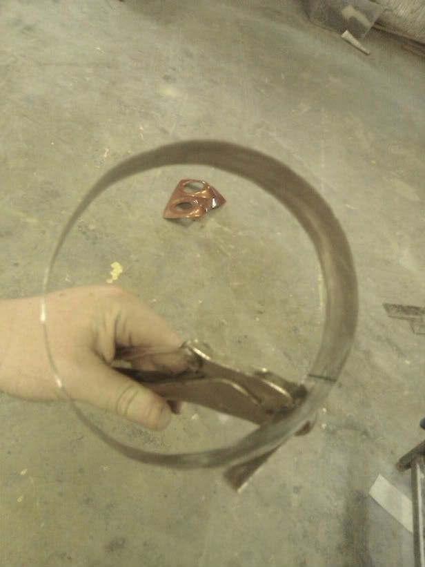

a friend of mine that works at the truck yard brought me this from the HHR i got the right side tail lights..... make things a little easier
and i got this in the mail today, OH YEAH . and the old a$$ one that im junkin.

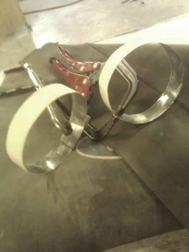

got the ring cut and marked, and the matching one...
then started on the passenger side, cutting the hole to fit the ring...
And finally! lookin like somethin
, after cutting and tacking the ring together
wanted to get otherside finished today too but this is all i got. This weekend i hope i can get both sides welded in ATLEAST possibly grinded, and whatever bodywork needed, so i can finish all the bodywork and PRIME IT!.... i wanna get that all done because monday i get my AVS taillight fillers so i can start the brake light install...

got started late but ready to cut out for bottom of the cups so it should get together quickly. but just got the other ring made and fitted in and my phone was gonna die so i took some pics and came to load them on the computer while my phone charges so heres the pics.... its so hot today by the way
if you look inside the hole in the first pic you will see the rod for the latch, i was planning on having to modify it to go around the tail lights but i think its gonna work perfect and not interfere with the lights..
and this is the light in but its taped up to protect it but you get an idea.... i had it in there to check clearance around the light, i wraped the lights with 5 layers of tape on the edges plus they have some play in the holes so when i do the bodywork and paint, the thickness of all that wont make the lights TIGHT in the hole. after its all said and done they should go in easy with a little play.. hope that makes sense

didnt get much else done today, i looked and it was 9 already and i lost my motivation lol...
this pic is the bottom made and tacked on, i tacked it better from the outside to make sure it held because i didnt trust the ones i tacked to start with. not perfect but best i can do without any metal shaping tools. ( plus the lights arent perfect circles which made it harder but it gave me a good start and ill filler it and try and get the shape batter after its all welded in.
you can see the better tacks on the back, i dremeled the edge of the bottom plate even with the sides before so once i get close to being done with the spot welds around the edge ill grind them tabs you can see down,... with the start of the cut out and i found the center and used a template i made from the HHR taillight holes i got from the junk yard...
and the hole is done with a little trimming and tweeking to center the light in the cup as good as i could but it turned out good i think
dont look at the black tape it was from yesteday and since then the heat has messed it up, it was to show me the center line of the taillight
..and thats it for the night, i got maybe half of the cups bottom welded on, finish it up tomorrow and start the other side and finish that before i weld them to the gate

well got a boost of energy and went and finished welding the cup tonight, except for the spots i still have to grind off but thats nothin.... and for some reason i thought it would be funny to post this video of my dog opening the back door like he always does. off topic i know.... its off my phone
