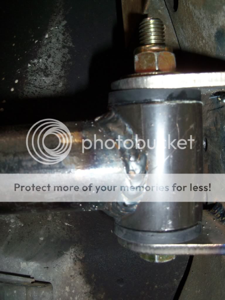

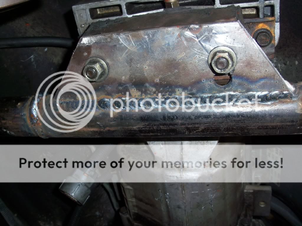

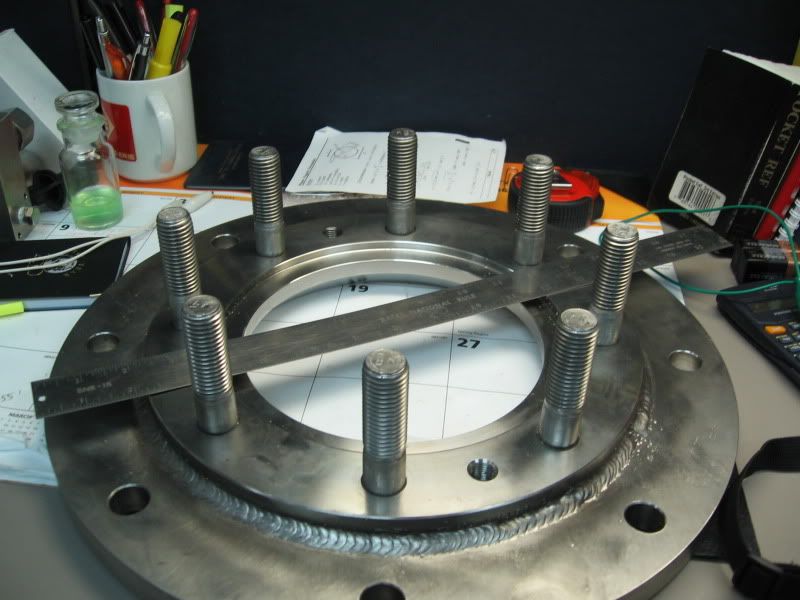

post up some pics of your welds.

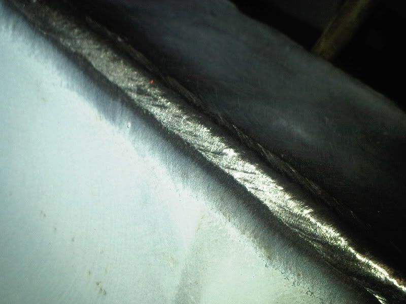

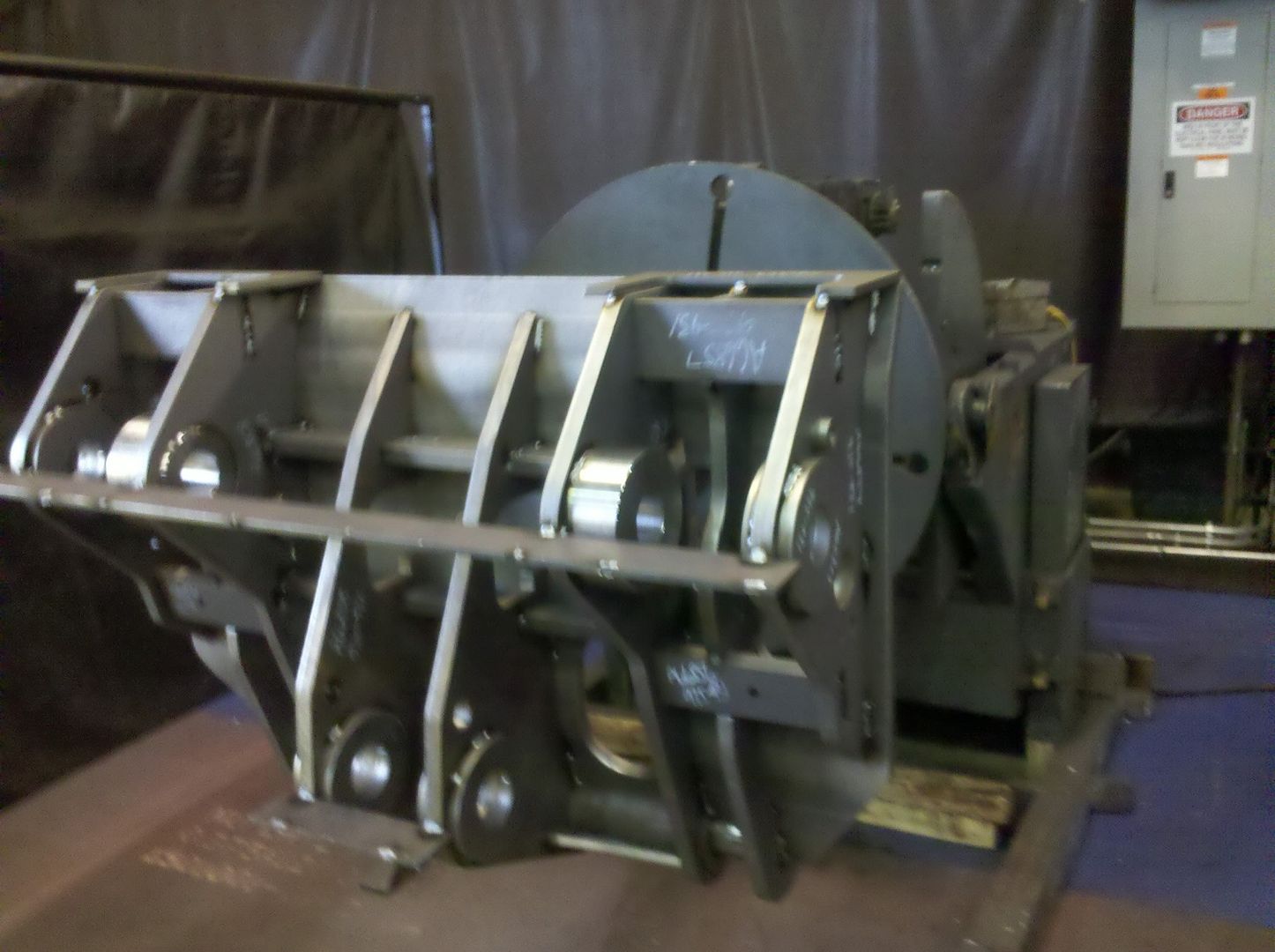

I just got a job welding heres where I am no formal training after three weeks. Pics of what I weld and my welder too.

You got some undercut and what not in there. but looks pretty good tho. I assume your running spray looking at your weld and equipment ( when else do you need a drum of wire ha). So what are you making in the photo?

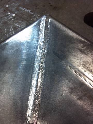

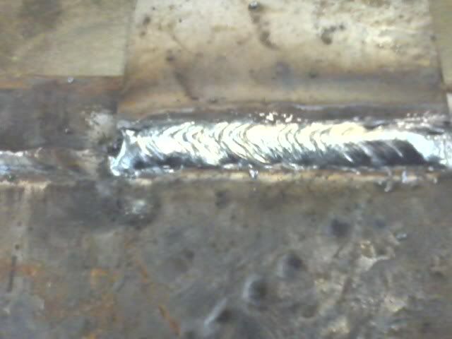

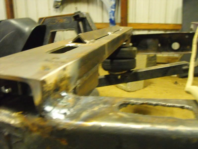

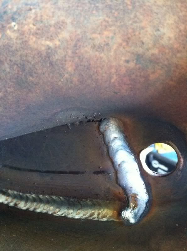

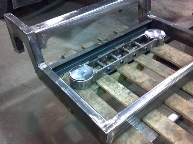

Self taught but i have confidence in my welds.
i didnt weld that crappy one on the edge of the corner but the rest was me.
its a hinge for a fence with a bit of undercut.
There can be some improvement here.
welded in my bolt in notch, i should have done an uphill weld but i dont have too much practice doing that technique so i did a downhill instead, from what i hear it doesn't penetrate as much.
either way i have seen worse lol. always looking for ways to improve my welds, its something i take pride in, especially on a vehicle when suspension is involved.

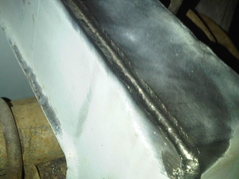

I had some undercut for sure, needed to run a stringer first. Its a coupler for a front end loader, the part that hooks to the bucket, We make all sorts of heavy construction stuff where I work. Coupler area is the best, always a different piece, lots of turns, not just a bunch of 10ft long welds, some multi pass welds too. Spray transfer is the shit, besides the heat it puts off.
bean dip they look good, I am self taught. A lot of guys I work with that are welders are self taught, most of them actually. Makes me feel good when I weld something that looks better than a guy who went to school and has been doing it longer.

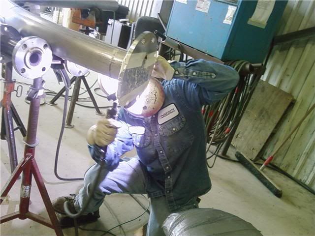

You got a job as a welder, doing structural welds on heavy equipment with no prior welding experience at all, on the job or otherwise? Please tell me what company you work for so I can avoid it.
That looks like a robotic welder. More pics?

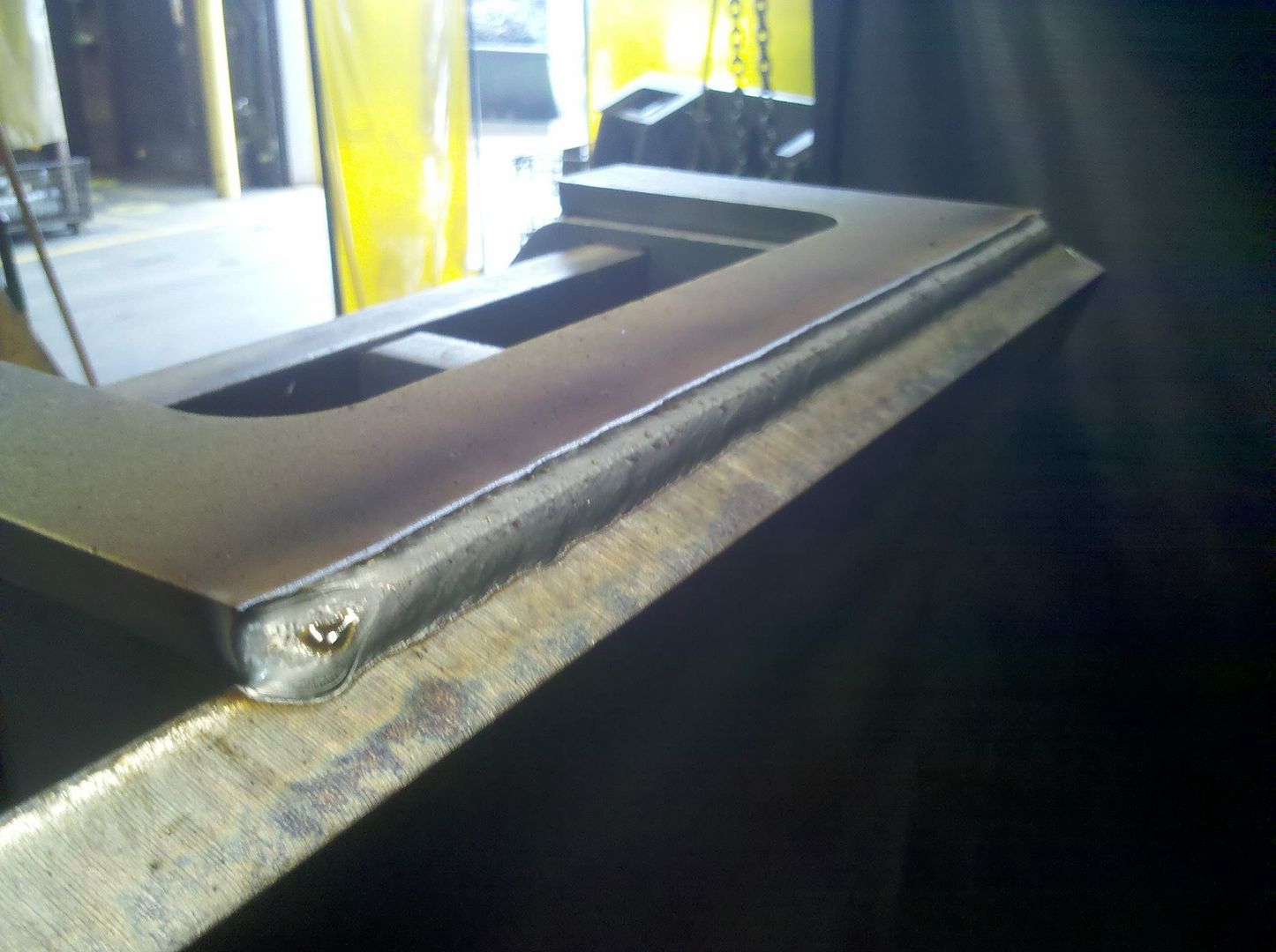

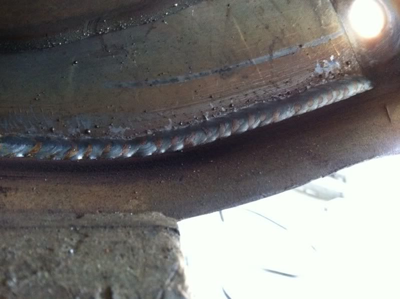

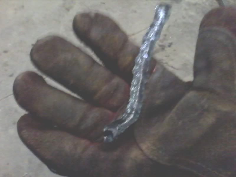

heres a pic of a practice (mig) vertical up pulsed spray weld that i did before my certification.

well i passed mine. but all you have to do for mig is a 6in vertical up pulsed spray weld which consists of 3 passes. and it costs 85 dollars for the certification plate. im pretty sure that there is a seperate one for mig welding aluminum also.
yuck

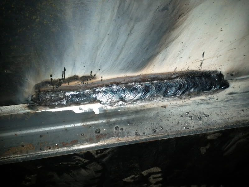

Re: post up some pics of your welds.

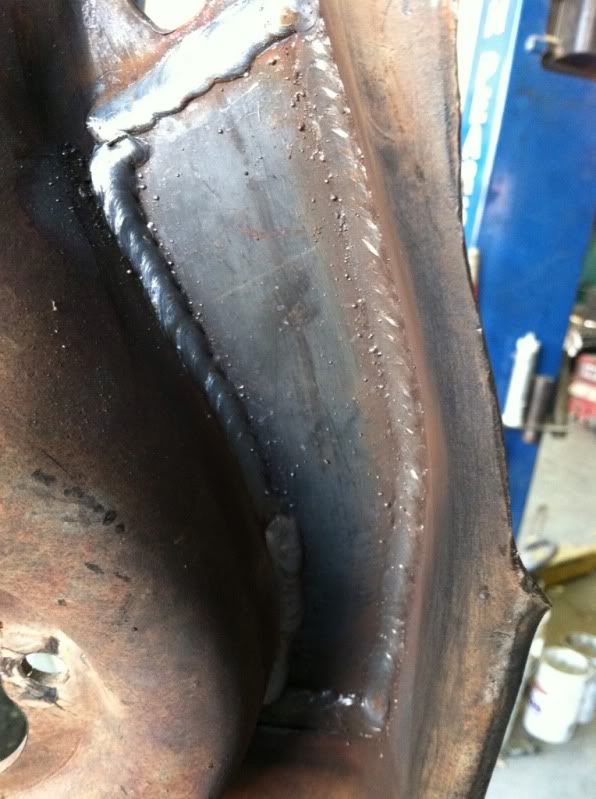

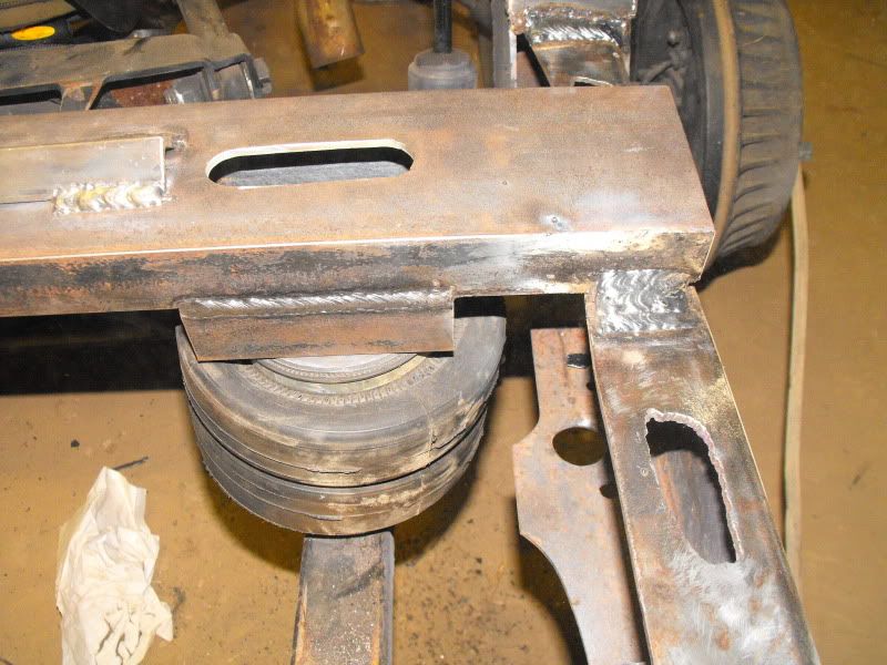

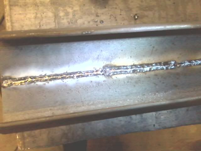

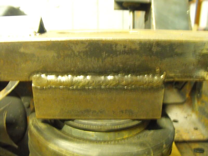

Welded with a lincoln 170. I am self taught too.
The welds were ground down and redone on this pic. I had a hard time getting the settings right for the sch80 for some reason.

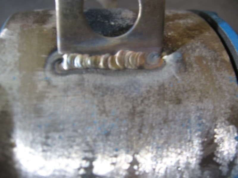

ill throw a few up.

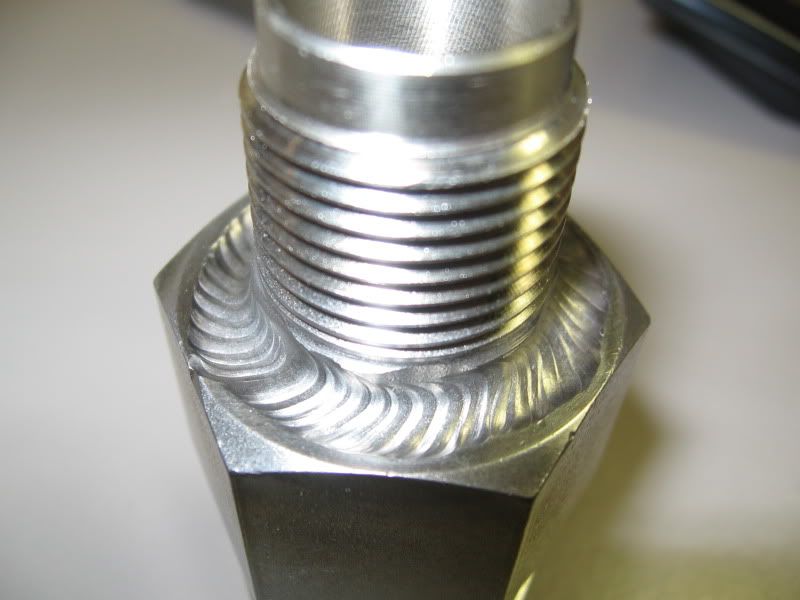

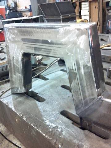

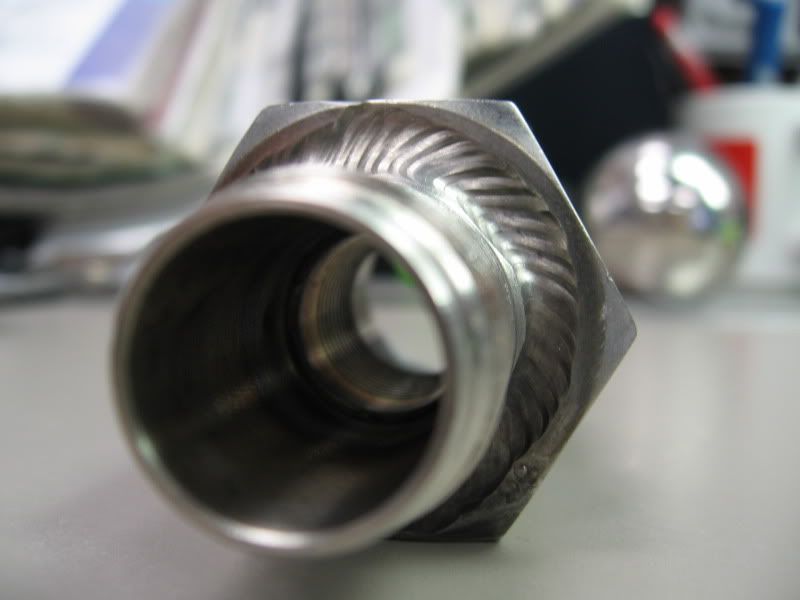

308 Stick rods, on 5/8" steel plate. Dont ask why i used a stainless rod on carbon steel. Was just doing what i was told. I tried talking them into letting me use a 7024, but nope. 308 it was. stupid considering the rest of the assembly was done with a 7024 or 7018.
Some mig work on a frame i was building for a hardbody. Still haven't finished it yet.
Some tig aluminum passes i made when i first got my tig welder
some beer cans that needed to be welded together:

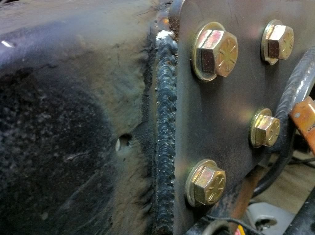

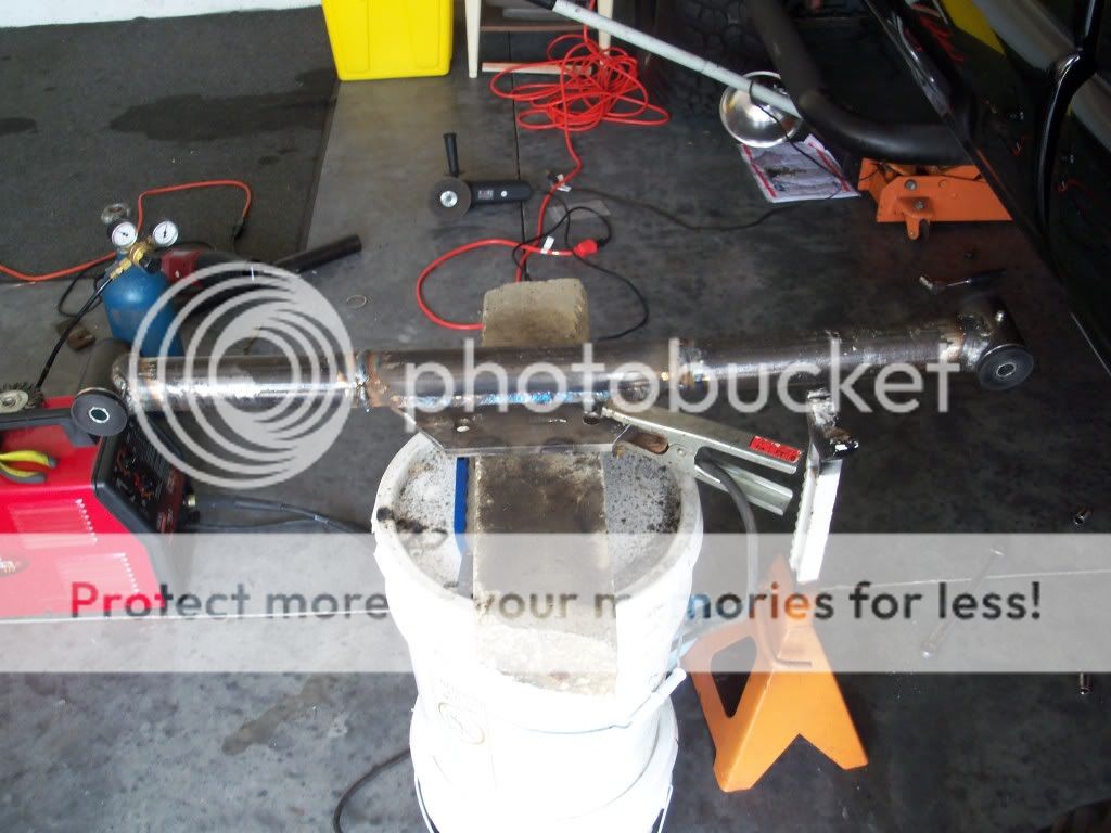

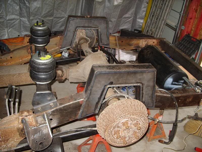

These I did with my miller 140 on its own 30amp breaker i wired in. Its 3x3x1/4 wall with beveled edges
My first exhaust I've ever welded up

i did clean the frame, clean bare metal but i left the chassis saver paint just outside of the weld area. i should have cleaned it further but at the time believed that was enough. but trust me though, the frame was clean before welding, ie. shiny bare metal.

Just got a Miller 185 yesterday and been dehumping some arms with it.
35 wire and running 75/25 mix.
I'm getting better for sure.

post #32 of 265 Old 11-08-2011, 10:55 PM
22 psi...stock
low-s-dime's Avatar
Join Date: Sep 2004
Location: dirty jerz
Age: 37
Posts: 3,792
User is: low-s-dime is offline
Send a message via AIM to low-s-dime
bronze, tig, autogenus
a105, tig, 720 psi @ 100°F
316ss to cast iron, tig, crappy
316ss, tig, autogenus, looks undercut but was a recess, custom adaptor
316ss, mig, custom designed window for bayer chemical, single bevel groove
carbon steel, pulse mig, my first shot at it...took a little getting used to
Dan
04.5 2500HD LLY CCSB 4wd
07 impala SS
mig...tig...stick...any questions
low-s-dime's (lincolnmetal) welding learning center
http://www.gmtruckforum.com/fab-shop/
s10forum.com member since 2002
mine are no where near as good as any of the ones posted in here
Learning to use a 7018 rod from a 6013. Little different.
Slag (I was very bored)
Bag bar on my dime
CUNSTRUCTIVE criticism is welcomed.
Dude...get some better pictures of this joint...more clear on this angle, a shot looking at the side, and one towards the back of the c-channel.

post #38 of 265 Old 02-15-2012, 12:15 AM
Mafia Customz
mafiacustomz's Avatar
Join Date: Jan 2009
Location: Artemus
Posts: 748
User is: mafiacustomz is offline
Send a message via Yahoo to mafiacustomz
why did he use C channel i would have used square stock and bolted my bags to that and why did he put it on top the frame and not in the frame. i have not bagged a s10 like that but im guessing its just to get a lower ride not for looks.
S.E.S.
post #39 of 265 Old 02-15-2012, 12:25 AM
Meh...noob
Join Date: Dec 2010
Location: LGV, TX
Posts: 787
User is: oh so slow is offline
It looks like there's another piece of channel underneath it too so dropping it inside the frame would give the same result right? I don't have a bagged ride. Just making an observation
post #40 of 265 Old 02-15-2012, 03:23 PM
Mafia Customz
Join Date: Jan 2009
Location: Artemus
Posts: 748
i think he cut the c channel and welded it together to bolt the bags to their just seems to be a lack of planing. I myself like to plan for about a week to make sure its as best as it can be and look super sweet when done.
S.E.S.

with all these great fabricators on here seems like some one would make a better looking c-notch
S.E.S.
post #44 of 265 Old 02-24-2012, 10:48 AM
Registered Asshole
rstadelmaier's Avatar
Join Date: Jan 2012
Location: Pittsburgh
Posts: 1,059
User is: rstadelmaier is offline
is that better a better looking c notch? i like the look of no welds on the notch, but everything else i'm doing is going to showoff every weld

NOT MINE, but i thought they were too nice not to share
Originally Posted by roademon View Post
pretty big dick in a box you got there brent
Classy Chassy
wildman ss is offline

i dont mean better welds on a c-notch i mean a better looking c notch all around the whole design
S.E.S.
post #48 of 265 Old 02-24-2012, 11:22 PM
Meh...noob
Join Date: Dec 2010
Location: LGV, TX
Posts: 787
You mean like with a radius around the axle and where it meets the frame? Not too much you can do to get to creative unless you back half it. Just my $.02

based on it being a load bearing structural member with incurred compound stresses, there is only so much that can be done with the actual design...
i think this is a well desgined c-notch/backhalf so far. creative with the crossmembers instead of just using 1.5" tubing.
