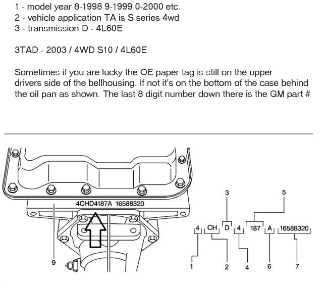

Any 98-04 4wd S10 (not full sized) 4L60E will interchange. The broadcast code needs to be xTAD. x being the year. Yours is a 3TAD.
