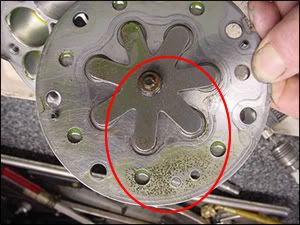

Thanks for the info on the gaskets As far as reassembly goes though, I'm not sure you know what I'm referring to with my 'alignment' issue. I'm talking about the 7star shape exhaust/discharge 'valve' and it's holder/limiter (pictured below):
And it attaches to this (which I found to be a 'proportioning valve'):
However, the proportioning valve has nothing that aligns it within the compressor body, and it seems that there is nothing that aligns the exhaust/discharge 'valve' over the ports. There is just the nut that tightens it down to the prop valve, but the prop valve just pushes down into the body. Am I missing something?
And as far as the leader hoses go, would it be ok to use the 3/8" ViAir leader hose on the discharge side of the comp and then run 1/2" leader on the intake behind a 1/2" oiler and a breather filter? I would think that the hose sizes would be ok (since the area of 1/2" line is more than 1.5x the area of 3/8" line), but I would be worried that the ViAir leader is a little too short to be used on the discharge side due to the heat generated by the comp. Plus I've heard that you need an all-metal check valve to be able to handle the heat from the comp and I dunno that the ViAir one is all metal. Any input?
Thanks again for all your help

Doug do you have any idea why my SD7V16 isn't pumping any air? I have an oiler, 1/2" braided s/s suction line, 3/8" braided s/s discharge line, check valve, water trap, etc... it's hooked up to electricity, the clutch engages and spins the compressor, but I get nothing. Is there a pressure relief valve on the head or something? Is there some port somewhere that I need to plug up or cap off? I'm sick of this thing being on my truck but not working
layinbody31 is offline
post #63 of 85 Old 06-07-2011, 05:49 PM Thread Starter
~~<<' DRIVEN '>>~~
DJDAudio's Avatar
Join Date: Apr 2003
Location: Pittsburgh PA
Posts: 23,957
User is: DJDAudio is offline
Send a message via AIM to DJDAudio Send a message via Yahoo to DJDAudio
Re: Sanden compressor FACTS and info.
Was it used when you got it?
If you can shut the engine down remove the lines from the compressor and rotate the center of the clutch by hand while holding your finger over the suction, if no suction you have either a snapped or stuck valve plate or if the center clutch spins very freely a snapped main shaft.
The valves you can pull the bolts from the head to inspect.

I have a Sanden SD6 I fitted with a custom bracketfor airing wheels after offroading.
I opened it up, all looked well inside valves good. But when I fit it, and give it a go, it gives only a litle air. Like a mouse with asthma. When I turn the shaft the pistons move as it should.
Also, it gives a horible chirp. Initially it did nothing, after 5 minutes the chirp started becoming gradually worse, only disappear for a while with Q10 on the belt.
Any ideas?
I am sure the mounting was done right. I am reopening to check for dirt inside, the compressor was open on the table for long, maybe it is dust...
Any ideas?
Make sure you have the proper amount of oil in the crank case. Also if left open to the elements, the remaining ester oil from when it was used as a AC compressor can combine with the moisture in the air and form an acidic reaction that can etch the metal, this will allow rust and oxidation to form on the machined surfaces. All of the above can cause the chirping as well as drop in compression.
Also was it from a junk yard? Allot of old compressors may have gone bad but been left in the car

I got the original one from a junkyard that I worked at several years ago. After it didn't work I got another one off of eBay and put the head from the first onto the new one (because the head was already drilled/tapped for NPT threads), but I still have nothing. Has the 'mouse with asthma' low pumping issue that ob1 is having with his. Everything engages/spins/cycles properly I just don't get any air
The sooner I can get this figured out the better because I think my backup ViAir 480 that has been my only comp for now just blew up this morning
That is the strange thing, if the pistons are moving they physically have to be moving a god bit of air for they have at least 7CF of displacement.
This may sound silly but is your head built for center suction and the model you have center discharge?
If the pistons are moving and no air is coming out the valves are to blame.
To check for internal blow-by put compressed air on the output of the compressor very little should come out of the suction side.
also put compressed air into the oil fill port if you hear allot of air hissing out either port there is a ring or internal passage blow through.
The opinions and views expressed in the above post are the intellectual property of DJDAudio. The above mentioned information shall also hold no legal binding against Doug DeHaven in the court of law.

opened it up over the weekend. Cleaned the valves. There was minor rust on the valve seats, it rubbed right off with the alcohol.
Re-assembled it turns nicely. But when I blow into the suction port, some air excape from behind the pulley and clutch.
To me that sounds like
1 one or more pistons are shot
2 Breather between the crank case and head is not working as it should.
What do you guys think?
Yea, Definitely no air should come out of the front main seal. Something does not sound right.
