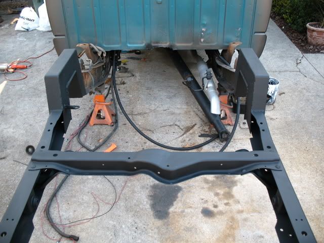

Heres mine, i did use a wire brush and then i tried out a flap disk.. and o man 100X better, then one i got time to get the spots i couldnt with a grinder i used a hand wire brush.. im in the process of doing the rest of the truck now.. and make sure u wear a mask and have good air casue that crap makes a mess and smells horrible..
