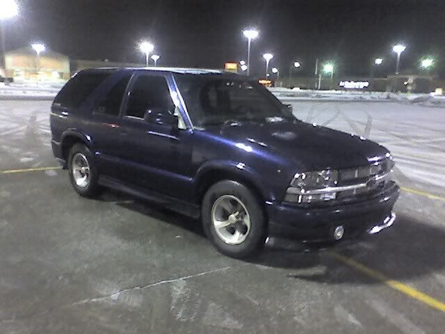

I have a 2003 blazer that I'm looking to paint blue like a real dark blue and I've looked at tons of colors but I'm thinking about the HOK kandy cobalt but I'm gonna make it darker and add some metal flake to it and I was wondering how would orange metal flake look? like glow orange?
because I am in the process of buying a 1st gen I want to paint orange
my blazer isn't a true xtreme but I've done all the work to it in my garage or driveway
so far:
3 inch drop all around
fiberglass rollpan
xtreme kit
one 12 inch alpine type x
when done:
5 inch drop all around
18" 20" iroc combo
two 12 inch x's

cobalt blue kandy is a beautiful color....but adding orange flake to it will certainly clash ....

would it give it like an orange glow?
I'm looking make the blue a little darker not a ton darker

Ya I wouldn't think it would look all that good. And paint toad knows his shit so if he says don't do it I'd probably listen to him.

like in with the blue mixed very lightly...just for a little glow
but my whole idea is I'm gonna be building a 1st gen s10 after the blazer is closer to finished and I get better established in a job(in school for painting at the moment). The s10 will be orange and I want like opposites...orange with blue on one and blue with orange on the other

i personally do not like adding anything to the kandy nor do i like putting anything on top of a kandy(besides clear)
if you want to do stuff like that then i would suggest you use a base/clear system and don't worry about a urethane kandy....

i never put anything over candy. only in or under. the effect u want, wont work like u would think. the blue will just tint the orange darker, and what ever is under will be lighter, say silver, so ull have these dark specs. it doesnt compliment the way u would think.

i would do a blue kbc with an orange ice pearl over the top. that might work ok. or majik blue pearl. but not flake.
