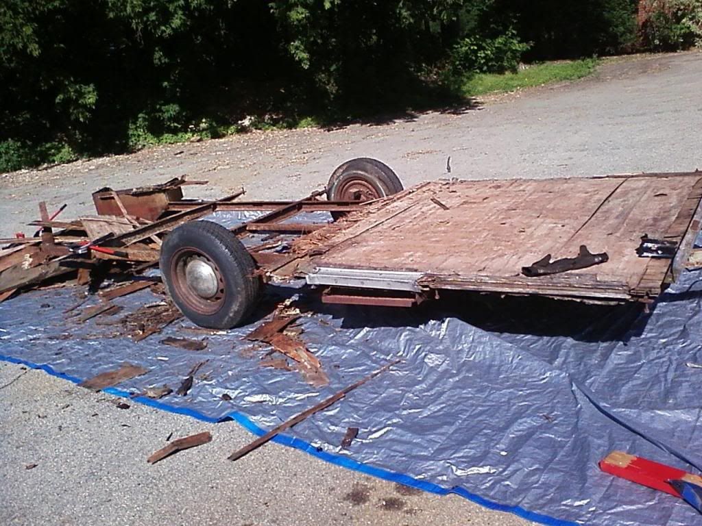

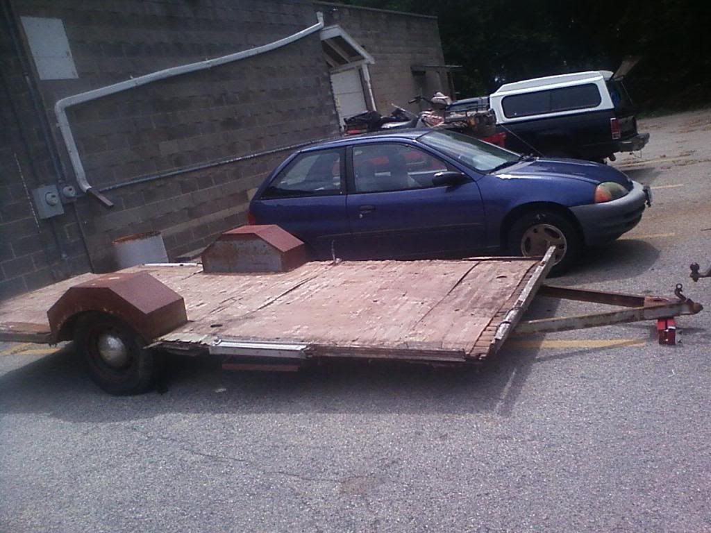

This actually turned out to be a fun project. I finally am olmost finished with the trailer, just a few minor things, but here is kinda a build up:
brought it home:
Started to pull it apart:

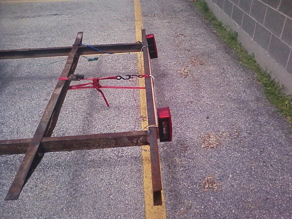

Welded a C Channel on back for support and to mount the lites in (this was only the temporary setup, its better now.)

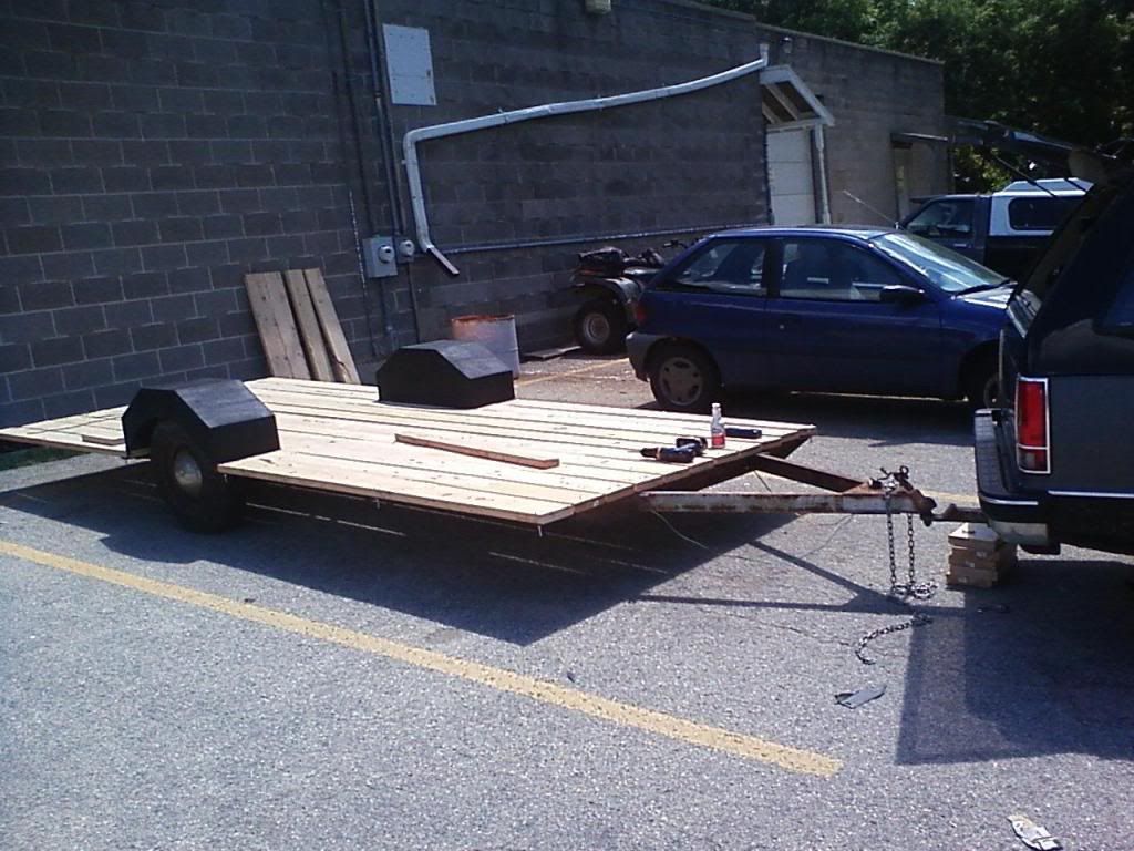

And the olmost finished product:

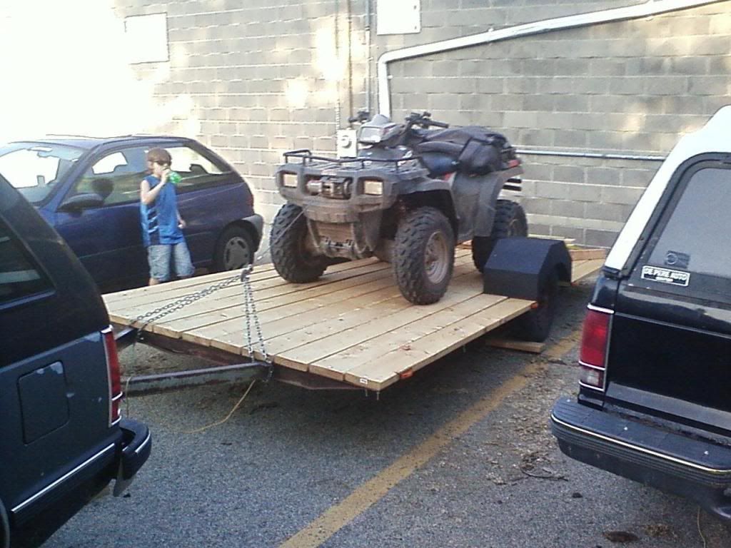

How it's gunna be used:
This actually turned out to be fun, had my nephew help me alot, and he was thrilled. I stuck right at about $600-700 into it all total. Frame was $100, wood was about $100, mounting hardware all total (bolts, C channel, ect) was probably another $60, lites were about $50+ (All LED lites, 4 running down each side, t tail lites, and a 3 lite strip in the back center), gas to drive around and get everything... yea, I stuck a little money into it, but I think it was worth it.

Tip on tieing the fourwheeler down. Its not a good idea to use the winch like that because the lock that changes it from freespool to locked is made of plastic and the constant slack and tension while bouncing during travel tears it up fairly quick. At least thats what WARN told me when i brought mine back for warantee.
usually I use a ratchet strap, this is only temp. untill I get more tie downs bolted down. I have them, just no time.
Thanks tho!
brought it home:
New Hitch and Jack:
