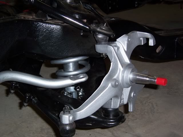

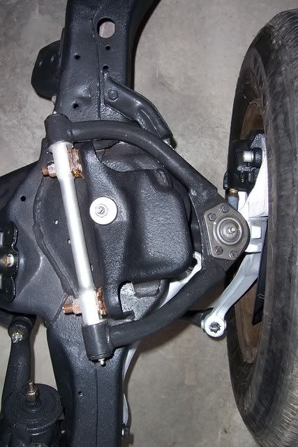

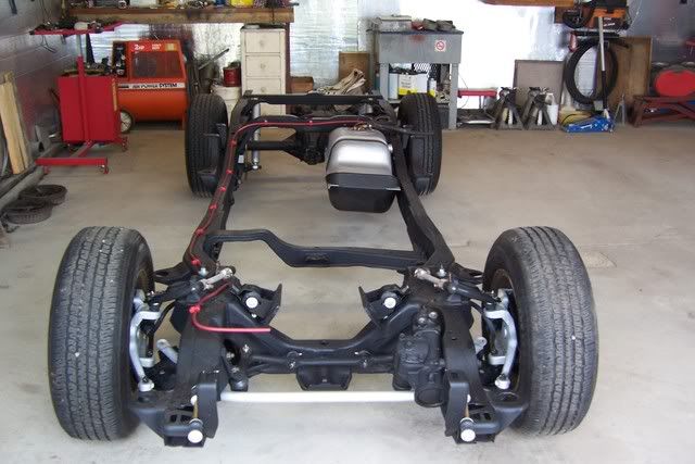

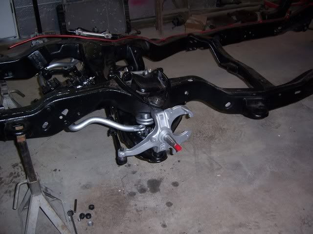

does anyone have pictures of these speedway arms,other than on the site? installed or otherwise?

So there is no downward bend of the arms, and the balljoint mount is completely parallel with the tubing? thats the only way you could flip them from side to side.
