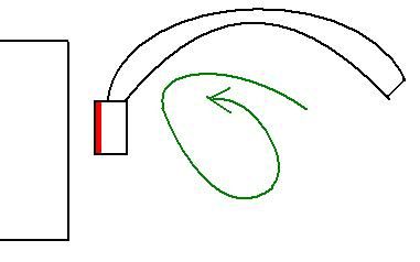

Quicky MS Paint drawing for ya.
The red represents the mating surface of the fitting to the caliper in it's stock form (shown). Notice how the hose/fitting is offset to the one side?
When you flip the hose to be bent down you're changing that red mating side to now mate to the bolt head and not the caliper, and that offset is likely what's causing it to leak.
What you need to do is coil it like how the green arrow shows, so that the red mating surface will still be in contact with the caliper, but the hose will not be in jeopardy of hitting the frame due to being coiled

If that is the case, could he not switch just the lines from left to right and do what he is doing? Just a thought.

Re: Project: Minty Fresh
i didnt change the mating surface. i just swiveled it 180 degrees.

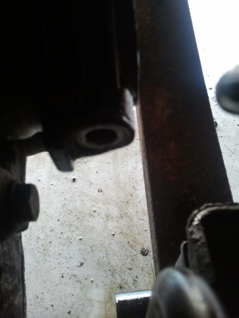

Does it still fit into the caliper the same? I seem to remember trying that at first on mine and then deciding that looping it was the only way for it to work...
layinbody31 is offline

ill go take some pics for you.

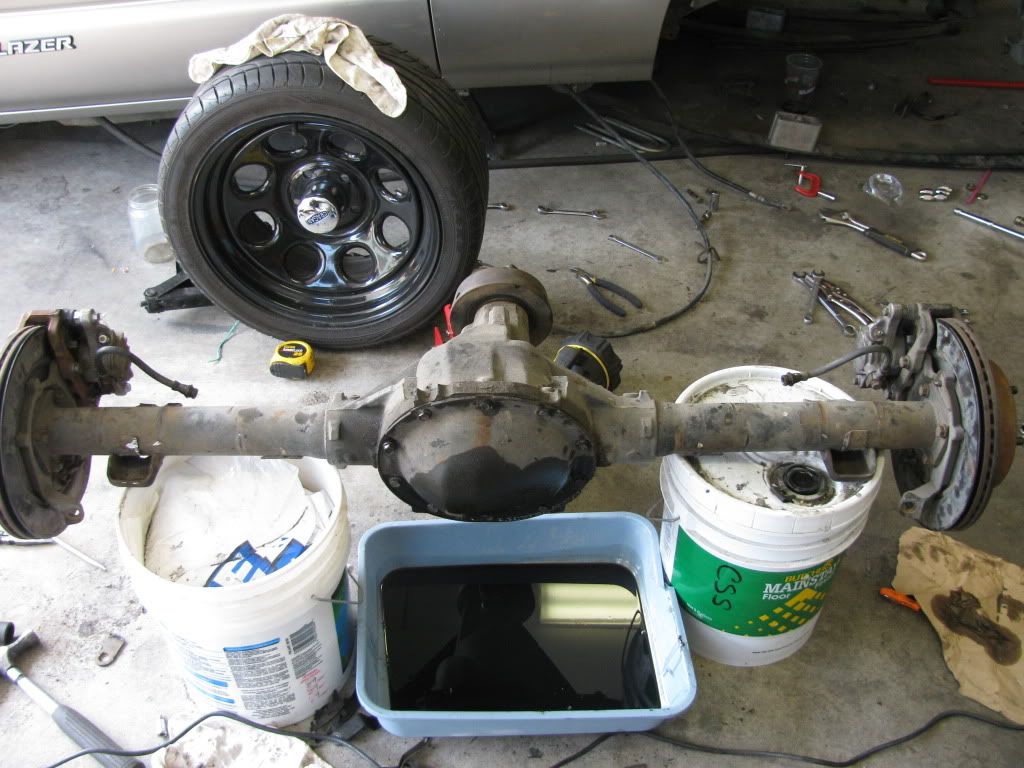

post #369 of 1315 Old 05-03-2012, 02:07 PM Thread Starter
No longer a pizza tech.
90blueS10's Avatar
Location: Topeka
Posts: 12,171
User is: 90blueS10 is offline
you can see here how i had it mounted.

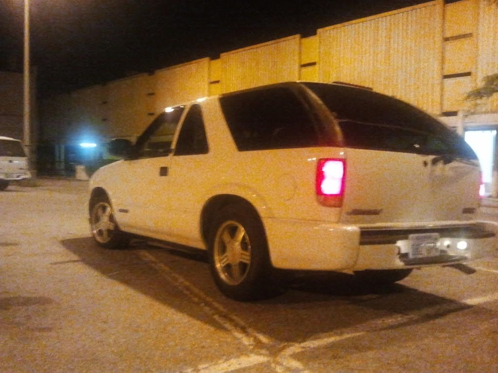

post #370 of 1315 Old 05-04-2012, 12:13 AM Thread Starter
90blueS10's Avatar
Location: Topeka
Posts: 12,171
My dad brought me something while i was at work.
Ryan

post #373 of 1315 Old 05-04-2012, 02:01 AM Thread Starter
90blueS10's Avatar
Location: Topeka
Posts: 12,171
Yeah ill get on that some time. lol

Brent, my dad went to napa and had them look up the specific crush gaskets for it, which were thicker than the ones I got in an assorted box from the help! Section. He also cleaned the surface until new metal was showing.
