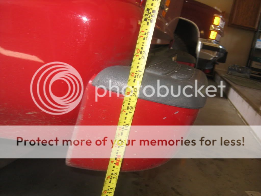

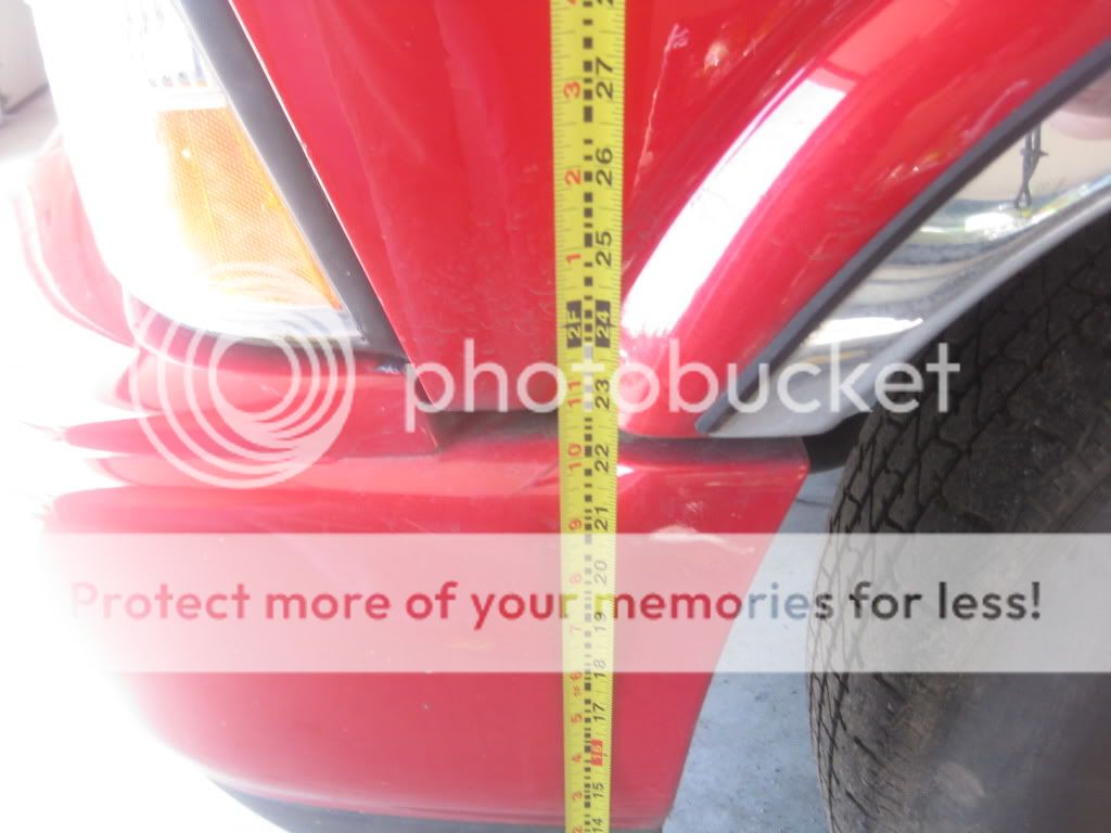

Re: Project: Jamie, about time I figured out what I wanted and got to it!

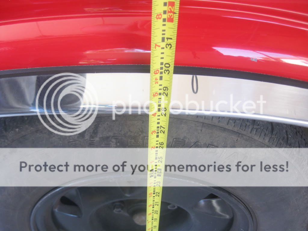

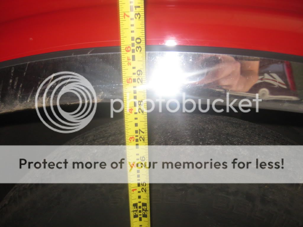

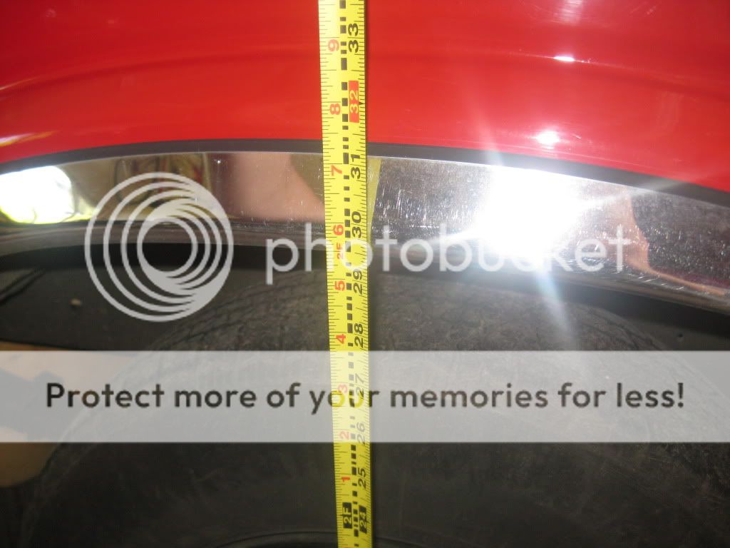

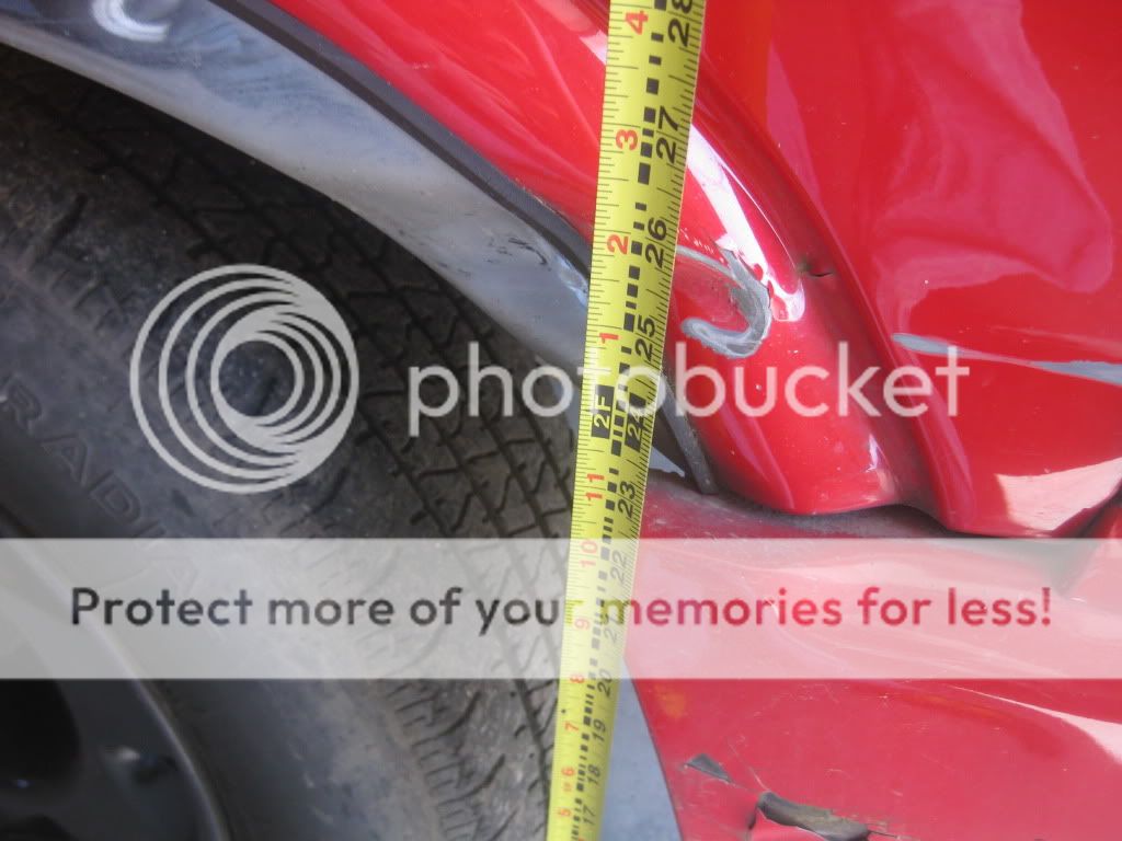

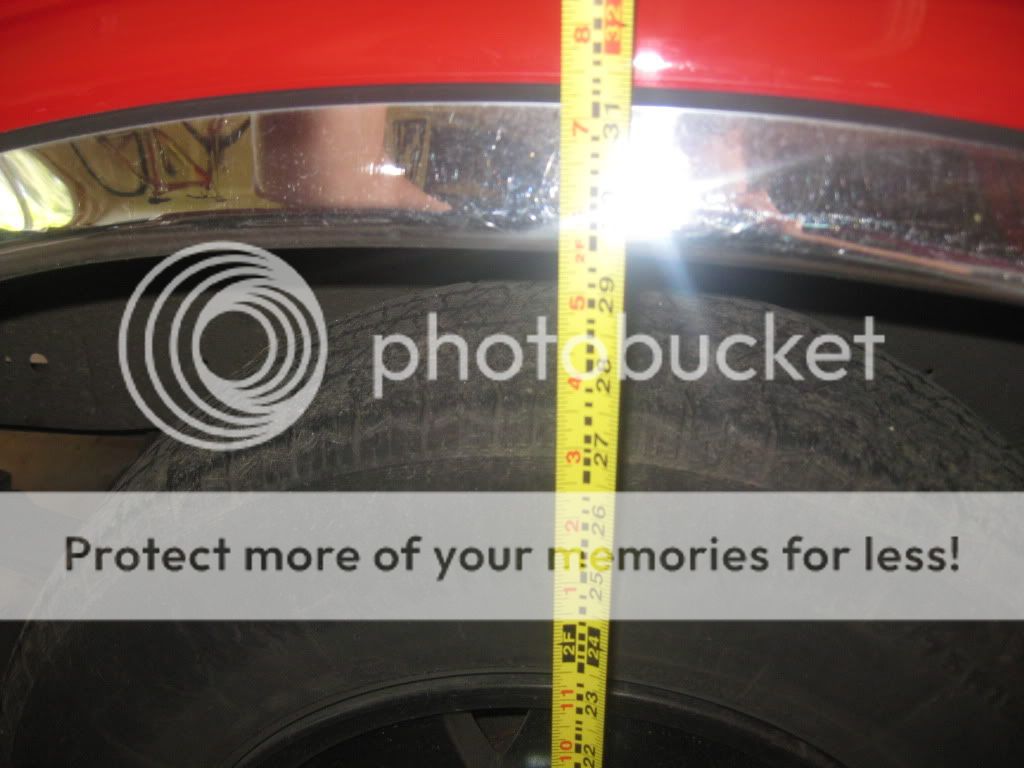

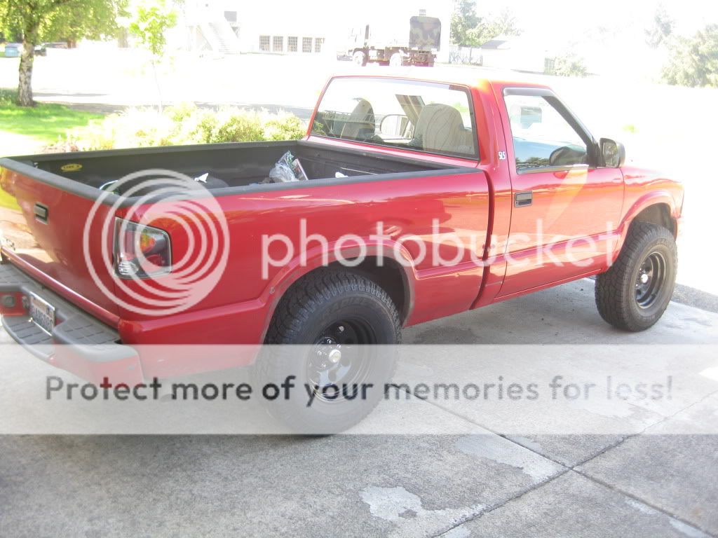

Stock height photo's...

Did I mention...I love the way this thing looks even though only the back is done? Not to mention I am only 2 hours into it...of actual work that is

every bone in my body is mad at you for lifting a zq8 :'( but i guess you already had so much invested in it and it was already halfway there. still a tearjearker

Your mad? I've wanted a Zq8 for YEARS!...then I find out I've been robbed of one basically because all the cool suspension stuff has been swapped out! And I don't have the ZQ8 wheels! I never bothered to check all the tags, because I never cared, because I assumed it wasn't...hence I went with lifting it. Like you said...I'm this far into it, I went ahead and did it! That doesn't mean further on down the line I don't rip all this stuff off this truck and slam it, then go get another truck with a V6 and lift that one lol

Someone swapped your springs and steering box too, not just the wheels?

the rear springs are all i can imagine someone would swap, the front looks a lot lower. he's got a huge rake. so you still have rear sway, larger front, zq8 steering box and frame brace...

Steering box I imagine is stock, sway bar in front...huge...and I don't have an extra brace which is also throwing me off...but that may have been taken out, when the dude put in a self disconnect driveshaft. Unless it isn't an obvious brace. The rear springs are not ZQ8 from what I can tell. As for the ride height, there is only a 1-1.5" difference from front to back...so I'm a little off. Maybe this is an odd ball order. Running the VIN it is one of two trucks with these exact options.

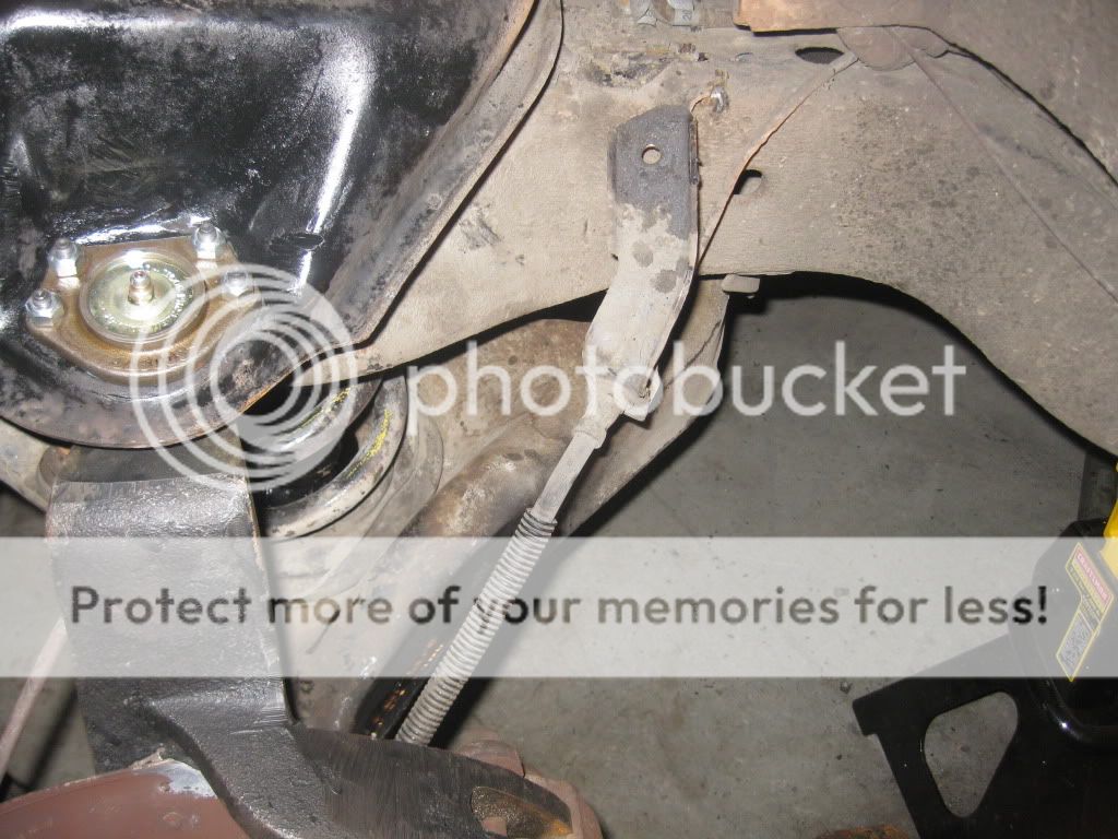

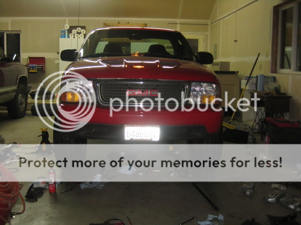

Update...front end disassembled. My fingers are bruised and battered...I'm luck the guy that owned this truck originally...undercoated the ENTIRE truck...or it might be rust I was fighting with. I'm ok fighting undercoat...rust is a bitch.
Pics coming soon

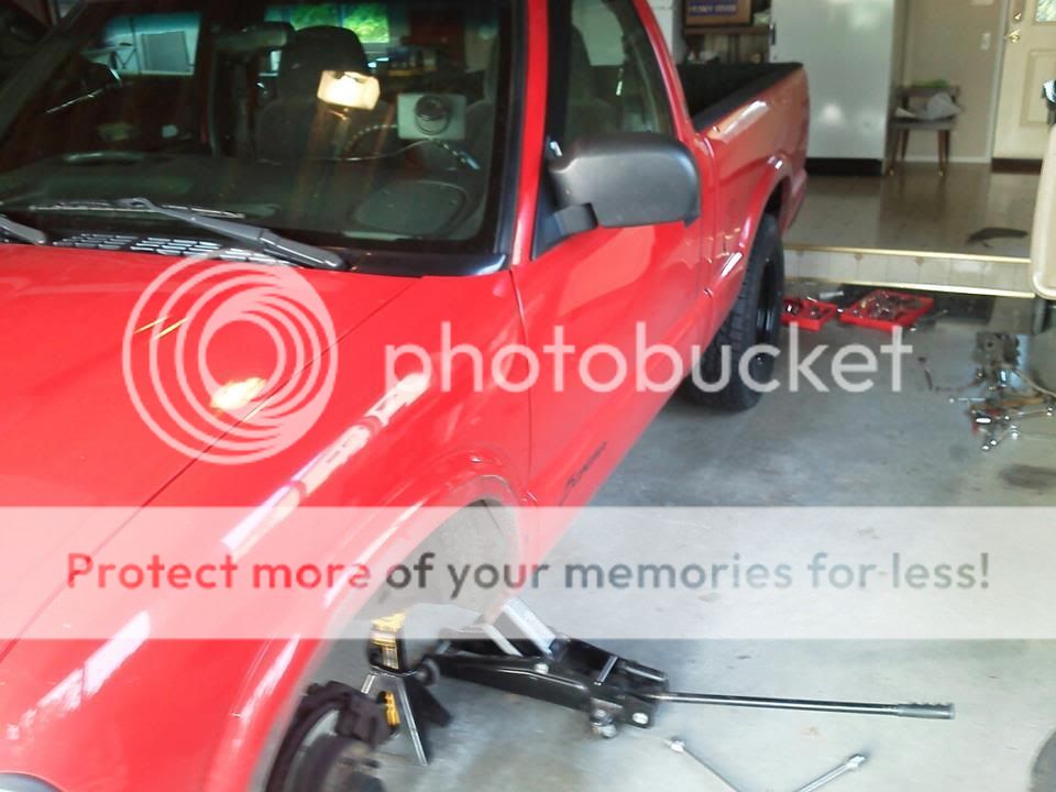

Well, got the wrong spring compressor, so I don't have her back together yet. I don't want to try pry bars, nor do I want to do the effing jack up the LCA and hope for the best...so again...she sits. Good thing I have another truck to drive! I wanted this done! Updated pics to follow

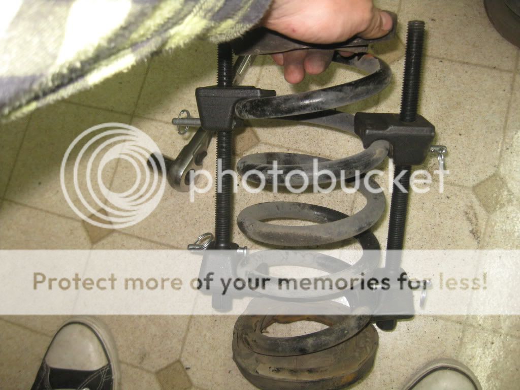

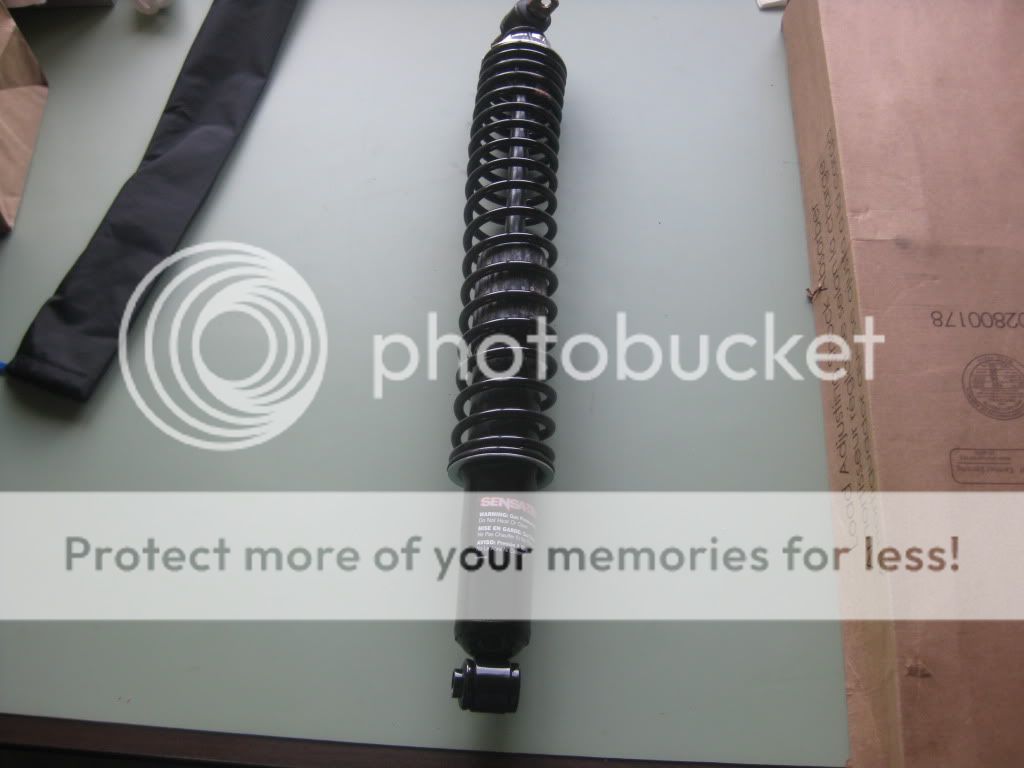

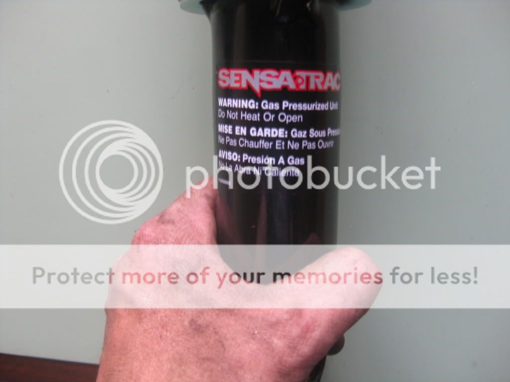

This is not the correct spring compressor...it doesn't work, don't try it!

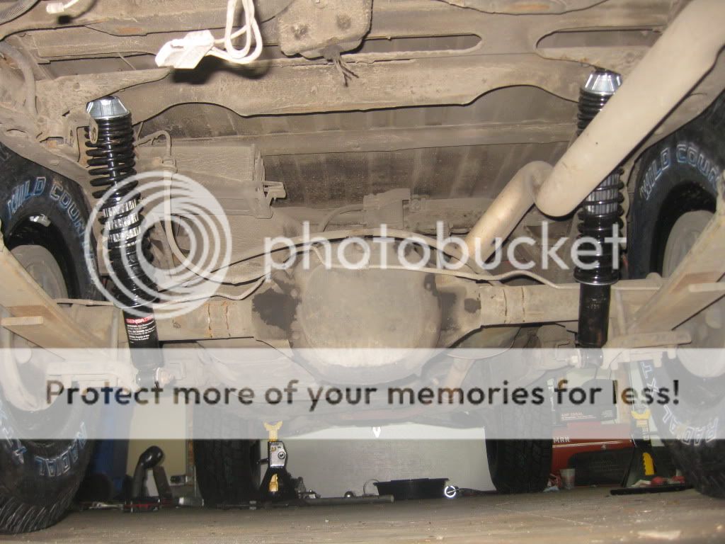

I did a little painting while I was under the truck. My truck is undercoated...well, so I just hit the spots that needed covering, so it looks like crap. But again, I have undercoating, this was more for protective measure, it'll be dirty again soon enough

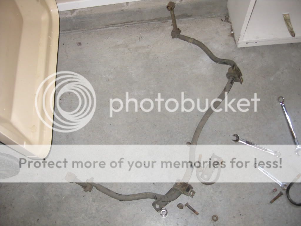

The damned rear sway bar of my Zq8...wtf over
The rotors, repacked and ready to go...fml you stupid springs!
These are the shocks I am running in the rear, they are Sensa-trac's from Monroe. 106 bucks as a package for both rear shocks, they are a load sensing shock, as I haul often. The tech recommended I don't use these for heavy off road. Again I am building a mostly street queen, so it doesn't matter at this point
Side one done, side two coming up! Other then that I'm golden. But fml the brake lines are way overstretched, even removing the bracket. So I am going to move her out of the garage when I'm done, but I can't drive it for safety sake. I was busy most of the day, so by the time I got to it, I couldn't get the truck done before tonight. Oh well, I guess it'll be monday before I am all said and done. Pics coming up here in a few hours when I'm done.
Does anyone know about how long the brake lines are on a stock ZQ8? I think that might be what's screwing me, I know that it's fine to go from a straight z85 z83? truck to the lift spindles, but I don't think ZQ8 to lift is any good, I think the ZQ8's brake lines are shorter then a regular Dime. Oh well, the hard part is over, well in a little bit, and if the worst I've had to deal with is the brakelines aren't long enough preventing me from lifting, I'd say I am doing a good enough job. As well as that means with the fine help of S10forum and Dezertdimes, thank you for all the help, we definitely know our stuff.
Time for more caffeine batman...out!
She has a bit of Cali Lean, but because I can't cruise her yet, this may settle out. We shall see but I need extended brake lines...here's why
But other then that she is done being lifted!!!
I changed the oil too while I was dirty greasy grimy lol
Also found this....
I will need to get that replaced. But I need to go in for the alignment anyway, so I might as well get them to replace it lol

This is the correct spring compressor, it goes inside the spring...get this one...as stated in other threads, it makes life easy! On top of that...it was free to rent from O'reilly's

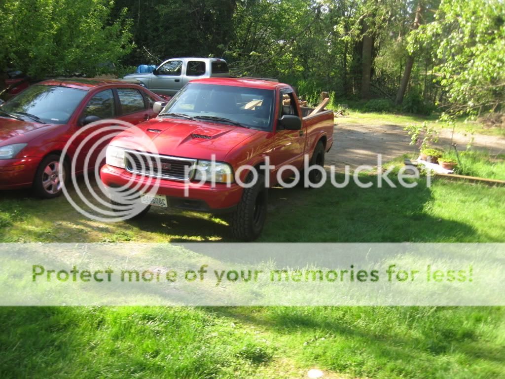

You're probably the first person to lift a zq8 it looks killer though. It looks kind of weird without the 4x4 tow hooks. I would consider throwing some on there, you can usually pick them up for free from your local yard. and they bolt right on.
but that sucks about the brake lines, I'm sorry I have no input about that. I just know that finding brake lines for these trucks suck. I found mine at Quality Auto Parts (aka CarQuest)
Lol I was already looking at tow hooks...but I have a couple lying around from other things.
As for brake lines I am just going to go to my local brake place, probably Napa, and have some made real quick. Then I can at least cruise it!
From what i can see on my phone,it looks like the front wheels stick out a bit? Have you thought about putting some spacers on the rear?
I am actually going to get a Blazer rear for it. But the other thing that isn't helping is that the alignment is way off right now, both wheels are pointed outwards in the front. I don't do spacers. So I will do the Blazer rear that is 2 inches wider then the stock S10 rear. I also plan to regear that rear end

It's worse in the photo, and the mangled fender doesn't help. But I agree with spacers, I just choose not to use them. It's like using a bandaid where you need stitches. I can fix the problem with a different part, and really make it look better and not have that extra piece in there. I like that much better then spacers. I have plenty of friends that use spacers, just not something I want.
Time to do some clearancing...BFH ready...here goes nothing! Oh and my hack saw. Pics coming soon
That's fair. I could swap the axle,but not something i want to tear into on the '93. I'd rather throw on some 1/4" spacers and call it a day. I'll have to checl out the pics on the work computer tommorow. My phone never does them justice.
Yeah, for me it's a truck I have had since I was 16. So I tend to go above and beyond when I do things on her. So I'd rather do the axle.
I'm having trouble clearing the fender from the tire. But I'm working at it. And I may have a leak in the rubber cover on the lower ball joints, that or I overfilled them. I'll keep an eye on them for now. But I at least am that much closer to being able to drive her again.

Went to get my alignment...and the upper ball joints have to much slop. They are moogs...any suggestions? I am checking with Doestch, the maker or at least seller of the spindles I have to see if there is a special ball joint I need.
this will give me the time though to get the new tie rod end that I need, I somehow managed to eff up the grease cover on it, so I'm going to go ahead and replace it, and probably the other side as well.
After that, I need bigger lift shackles for the rear, I'm going for the Blazer rear, and I'll do the disc conversion on the rear as well, and I have upgraded front brakes that are going to go in too. I'll do those since I have to take the front apart again. FML this is turning into a PITA...but I love the truck so I'll finish it!

Forgot to add, there are three washers that came with the ball joints, do I need these? I saved them, because I wasn't sure. But I have never had to shim the ball joints with these
