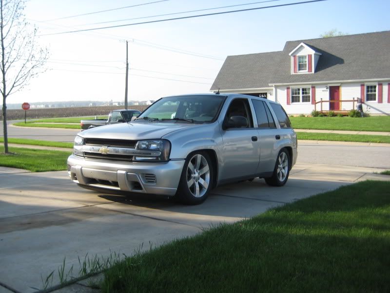

I had some new balljoints pressed in upper and lower when I lowered my girls trailblazer. Huge upgrade in my opinion, handles so much better, had about 120k when I did. Wish I would have went with djm arms to fix the tiny bit of neg camber though.
$$$$$$$$$$$Project El Cheapo$$$$$$$$$$$$$$$
How much did you drop it?

Re: [ProjecT] How Long Til The Wife Notices...?
Belltech adjustable shock strut thingy set at 1.5" in front I think, I didn't use any of the extra spacers for more drop. Eibach spring in rear. Got in a bind going out of town and tried to get an alignment and needed all four bjs....dropped 800 on new balljoints and getting them pressed in, so I could have paid for and installed arms myself....oh well. Handles great now, it was night and day difference, but by eye is has a little negative camber.

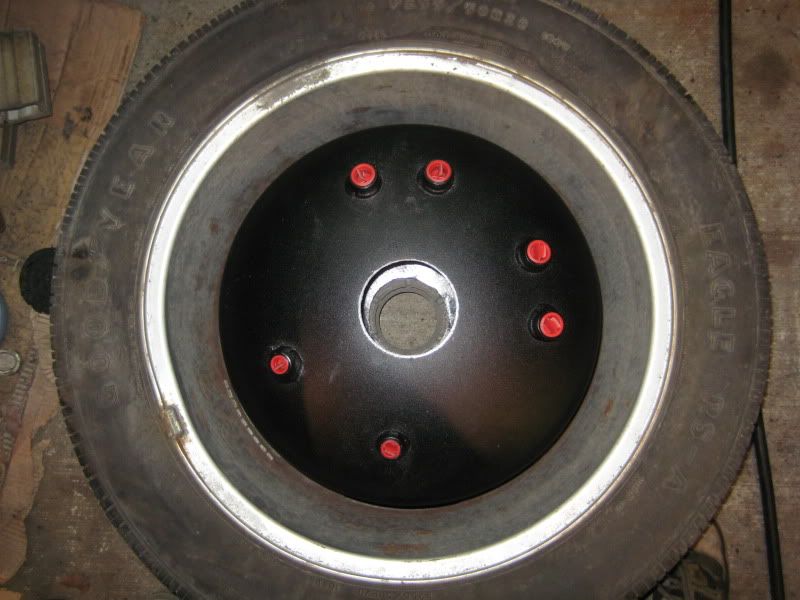

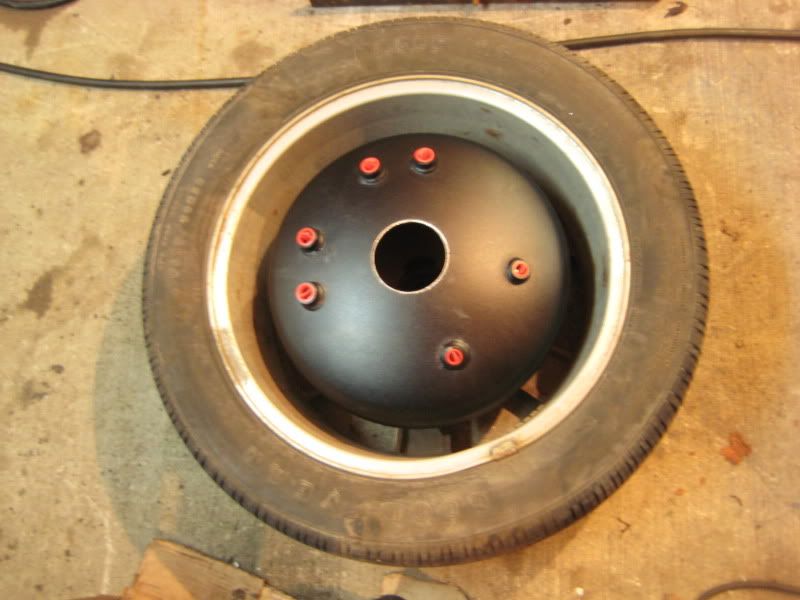

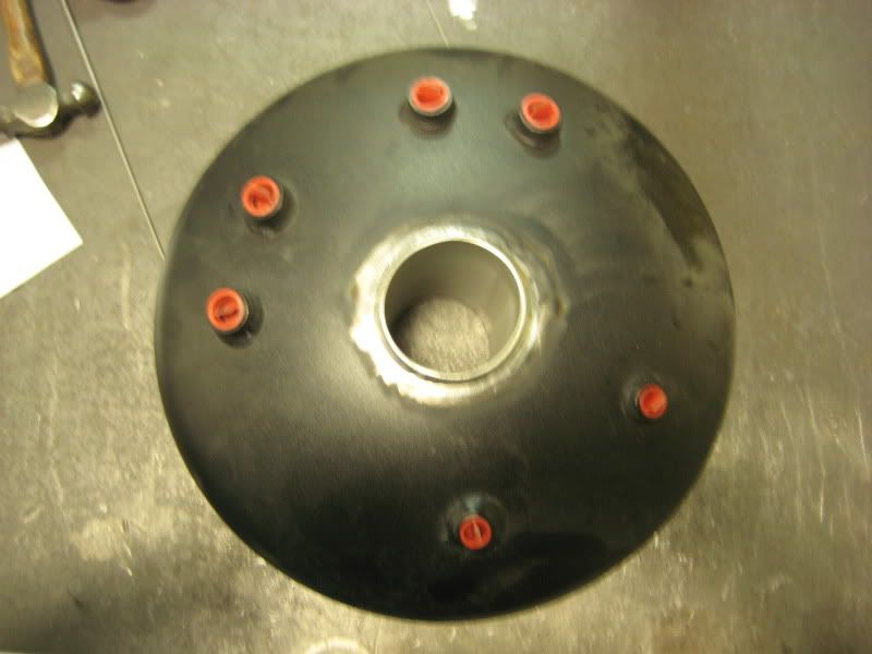

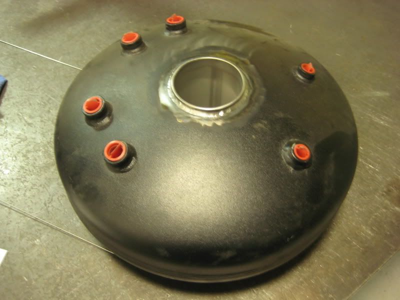

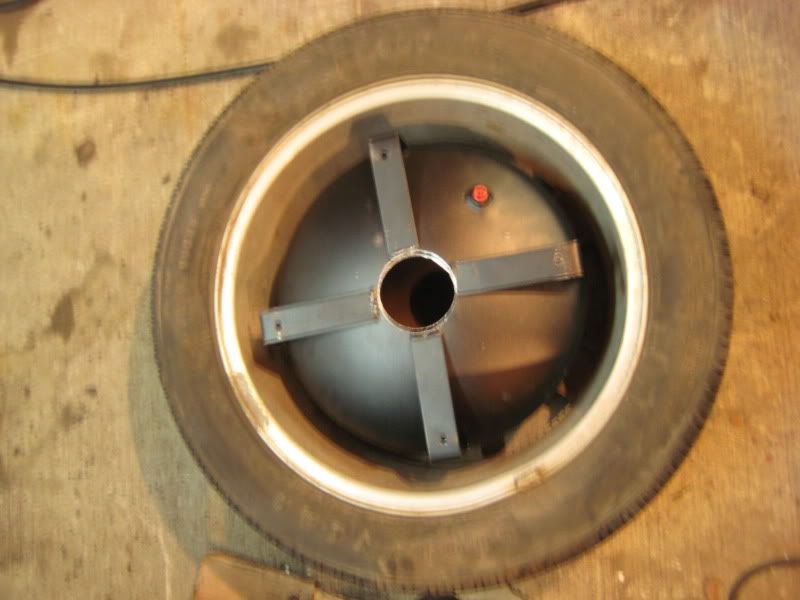

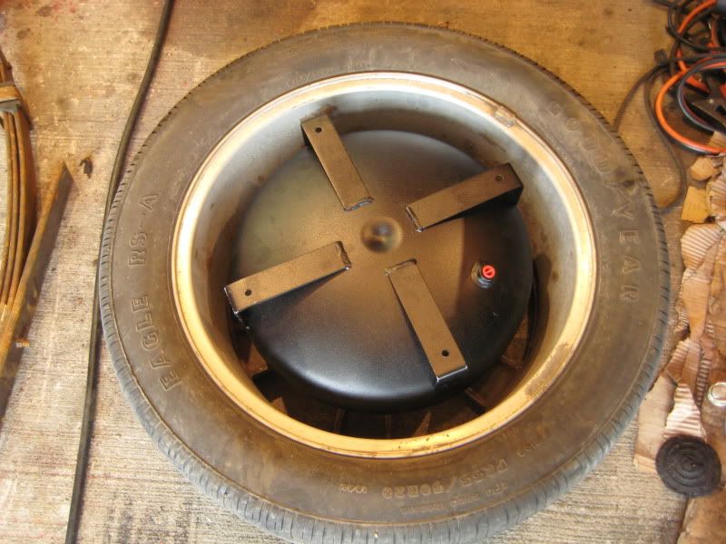

Progress
Tank sitting inside spare
Started to cut out one side with the hole saw. Drill battery died
Hole finished
Started on the other side til the drill battery died
Holes finished
Other way. I think I'm gonna cut the legs off so I can position them exactly where I want them. I might only use 3 to mount it just because of what I have to work with under the truck. And I might mount them on the other side of the tank so the fittings face upward and are tucked up inside the truck
The holes are there so the spare tire cable/bracket is able to pass through the tank. A length of pipe will get welded down through the middle of the tank to facilitate that. You can see the hole in the center of the wheel that the spare tire cable bracket sits inside to hold the spare up under the truck
And a close up
That is all for now. I'm hoping to cut the legs off yet tonight and tomorrow hopefully one of the welders at work can TIG a piece of stainless pipe down the middle and then I'll pressure test it. I'm thinking I may lose about a half gallon of space by putting the pipe in but I'll still have 3.5 gal at that point so I'm not too worried about it. I only have a 3gal on the Sonoma and it's always been a sufficient amount of air

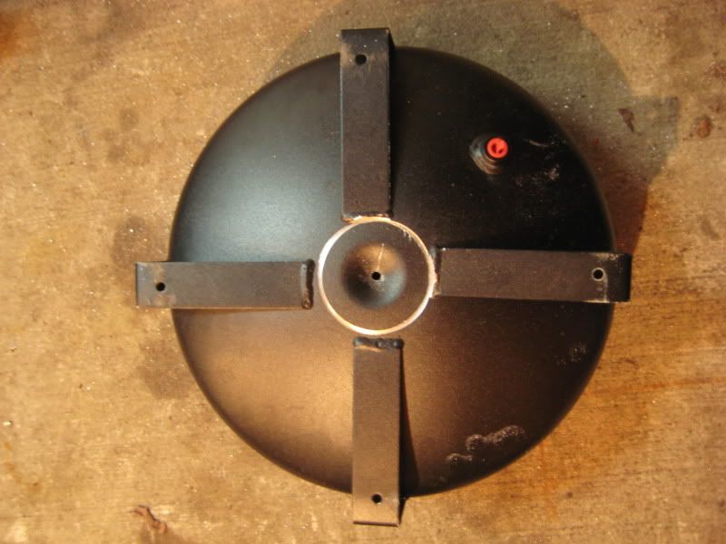

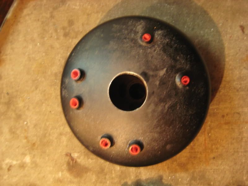

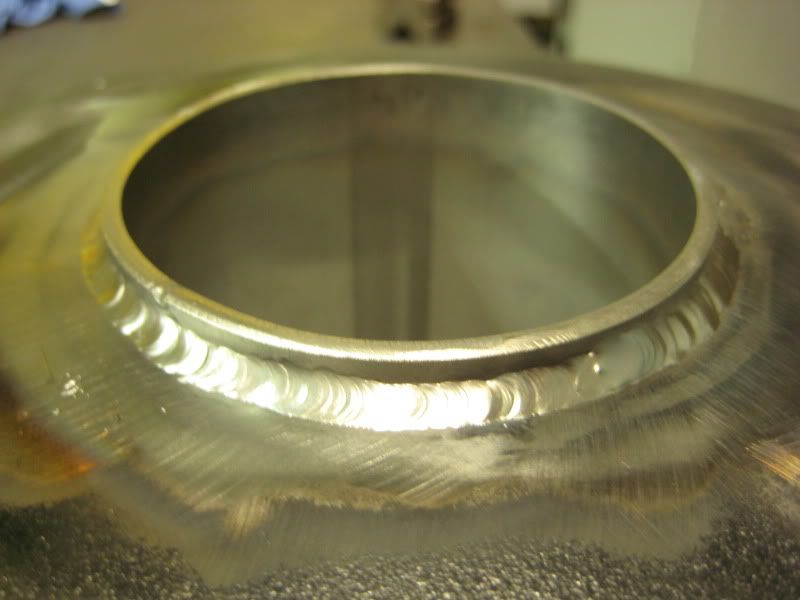

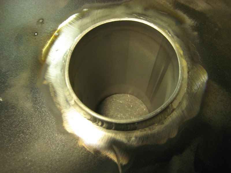

Pipe is welded in the middle and looks AWESOME
I'll get some pics at lunch time after I pressure test it

ok fine, here you go.
To start, some pics I took of my daughter last night

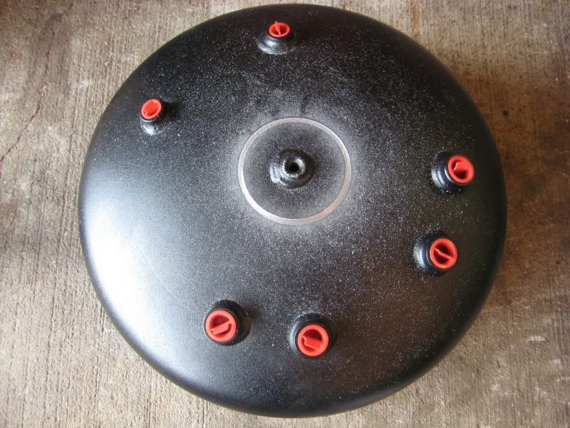

And pics I just grabbed of the tank. I'm not going to be able to pressure test it because my boss yelled at me for working on personal projects at work. I'll test it at home over the weekend most likely. Like I said... turned out AWESOME

Spots in the tank that were leaking have been fixed
Next step: Mount it and the ViAir
I'm thinking I may run a full manual height control system like Semi trucks run if/when I bag this. That way there will be no valves to worry about. It would be rather easy to do a 'lay out when parked' over ride on it so that's what I'm thinking I might do. Until then the air management will support filling tires and I might even throw my impact and an air line in the little cubby area underneath the mat in the back, so that if you ever have to change a tire it's super easy. And maybe train horns. And maybe air ride towing controls... Hmmmmmmmmmmmmmmmm the possibilities are endless

Got my parts yesterday. Put the 5th SS 20" wheel in the spare location
Wife was napping with the baby
Won't it get a lot of chips being under there?
Haven't had any issues with chipping yet, and it's been under there almost a year. The tire is tipped slightly upwards (facing down and to the rear), so the tread of the tire that faces forward takes any impacts from road debris/gravel/etc
