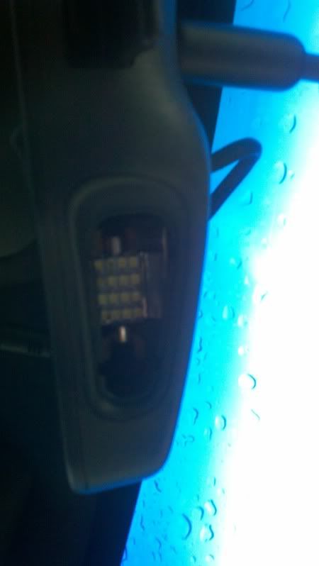

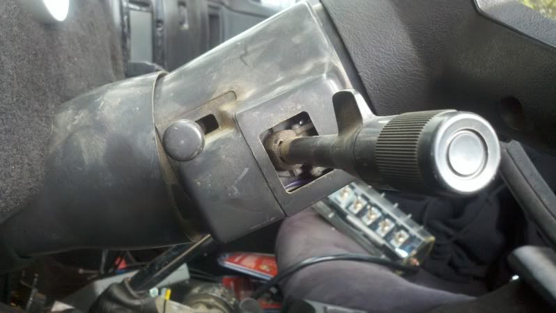

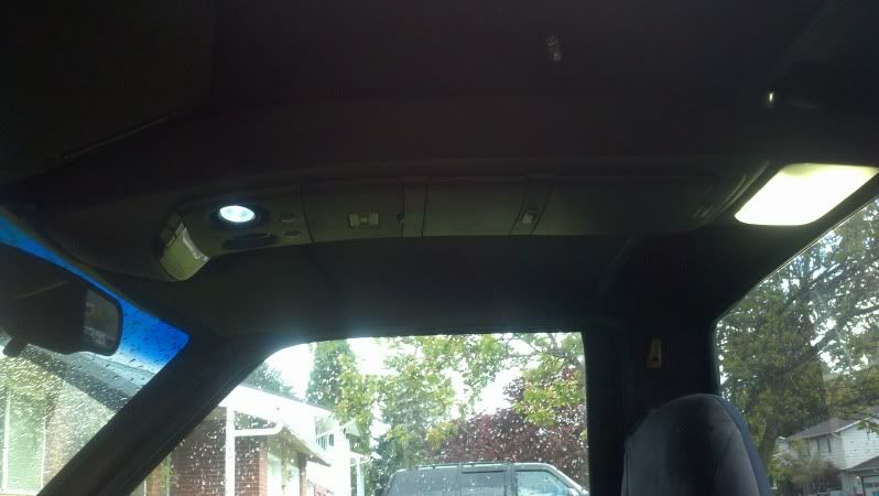

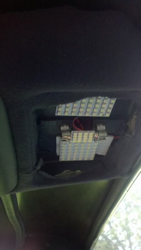

Finally did a tilt column for it. It solved my problems with the left blinker not turning off after a turn, no high beams, and me nearly breaking my leg (or pen in my pocket) every time I get in
I also finished the overhead lights. I now have 2 48 SMD LED setups in the overhead and a 16. The map lights have 7 SMD leds in each and the mirror has 2 more 16s, its like daylight in there!

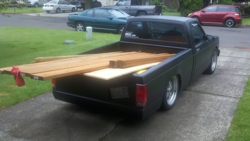

used it like a truck today

How hard was it to do the tilt column? I was wanting to do this for a while now.

it took all of a few hours maybe
4 10mm hold the column to the firewall
5/8 nut holding the steering shaft in under the hood
take out the underdash panel
2 15mm nuts holding the column to the dash
unplug the hi/lo switch, the ignition harnesses, and the whole blinker, horn, hazards harness
then reverse it back in, easy

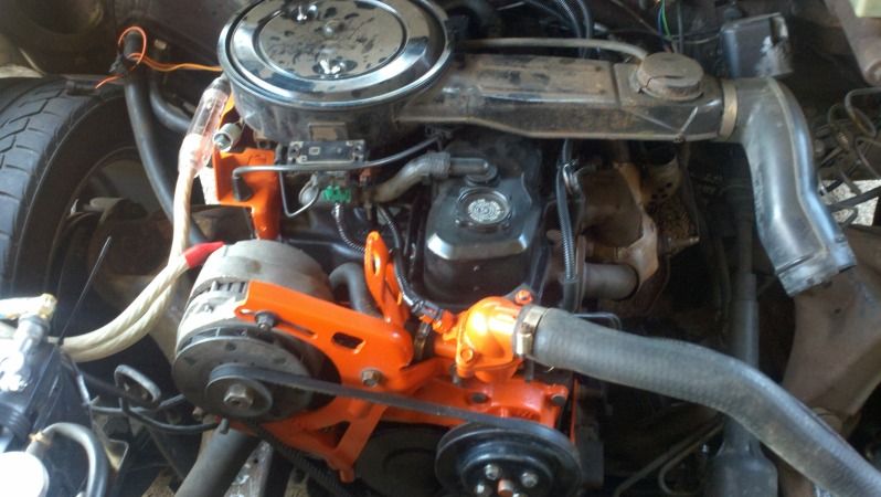

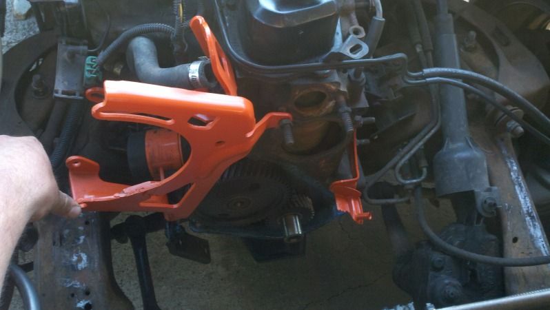

stuffs getting paint and Im fixing the dam oil leak thats gotten worse since day one, basically blowing the engine apart and replacing/painting ish

not using, dripping. I ordered the whole engine gasket kit, $42 at Hi/Lo O'Reilly, even comes with valves seals so Im considering sort of a rebuild for it. Sucks about the price and I wish I knew awhile back. I got the pan gasket $10, the valves cover gaskets $23?, and the thottle body rebuild kit $45 and it looks like the $42 kit has it all plus the head gasket and tons of other stuff! grrrr

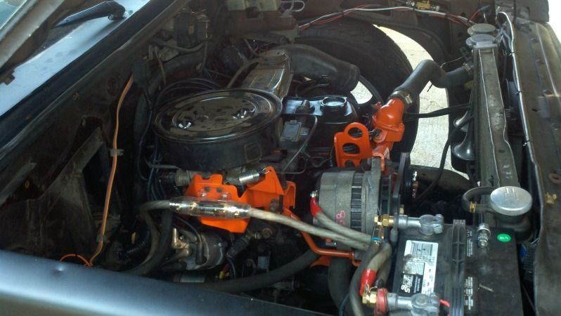

back at it making it pretty while Im fixing the oil leak

ok, I got some more painting to do and Im waiting on a EGR bypass from JEGs, but other than that shes close to cleaned up! I reloomed 90% of the wiring, cleaned and painted almost everything removable on the engine and did new gaskets all over the place. I also moved the main power wires down to the starter instead of off the alt and took the extra power wire off the firewall. I might paint the intake hat orange and the rest black and I want to move the battery. Gotta paint the alt as well and move the blower up somehow, add some fenderwells and loom the big power wires
