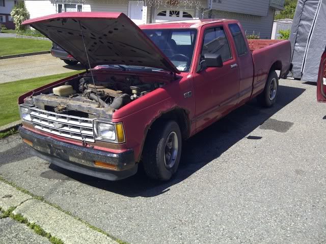

As the title reads.

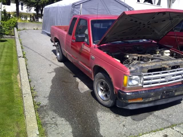

Picked it up for $450.00, 315***kms on the drivetrain, moldy interior, sliding rear glass window, rubber floor, T5, 2.5L Iron Duke, short box, gay fender flares, and rubber trim clad on the body.
When I got the truck home, I removed the rubber trim, fender flares, and washed it of course, however. It didn't really do much good for the fading away red paint.
Here are some pictures(old, yes I do know.)
So, yesterday I was really tearing into the truck and removing items... I realized I need to remove my entire dash to really clean up the mold/mildew... So, while I was in the process, I removed the dash speaker covers and noticed that there were Pioneer 6x9's in the front, and again in the rear. Last time I was at Canadian Tire, those were selling for $150.00 for 2, 4 in total is $300.00. I cleaned the dash parts, scuffed them up and hit them with some black paint.. I hit a stump when removing the guage cluster, I do not understand how to remove the temperature control arm from the little knob you slide up and down to control the temperature. So I went to removing the seats and other various interior items.. Looks like I have to re-weld in some floor boards, oh.. And replace the seats they are far too gone. The floor will be changed over to carpet when I am re-doing the interior(seat belts, seats, sound, etc.), headliner is fubar'd so, I will need to replace the material on it. Also! Does anyone know what size the Torx head is for the seat belt bolt? I think it is a T55, my dad thinks it's a T50.
Pictures to come for sure.

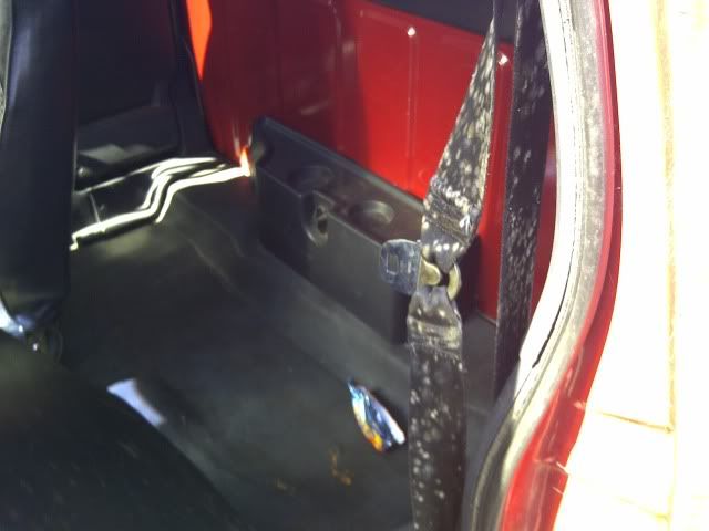

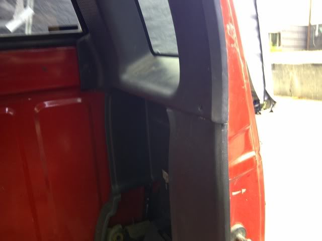

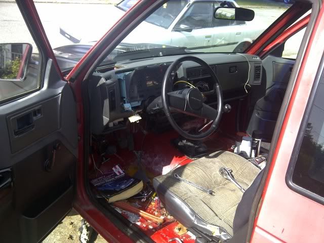

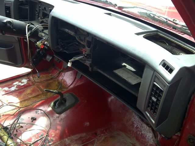

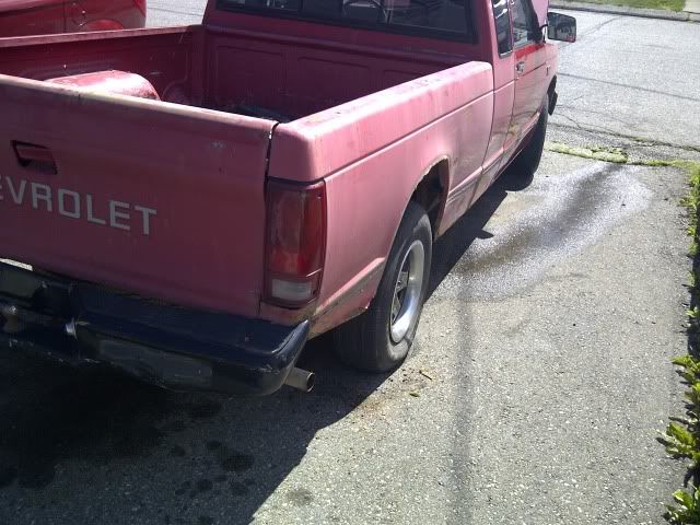

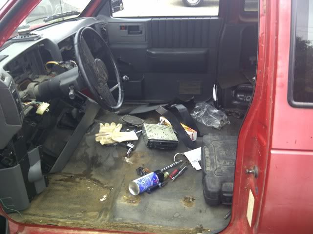

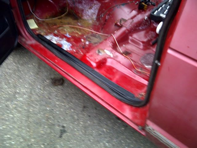

Well I am happy to say.. I have pictures. Not a whole lot, and I have been using my blackberry to take pictures with. It does not have an auto focus on it, or it does I just do not know how to use it properly..

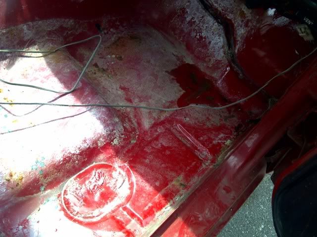

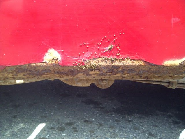

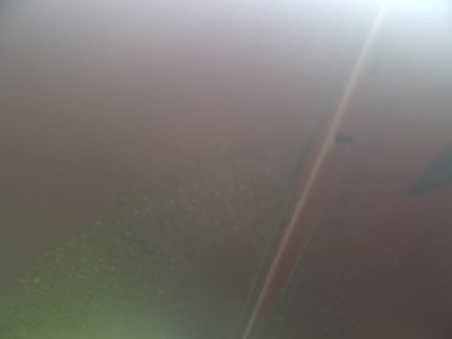

Anyways, the rust on the roof thank-fully is just surface rust. The rust inside of the cab is surface rust from moisture being stuck in the headliner..

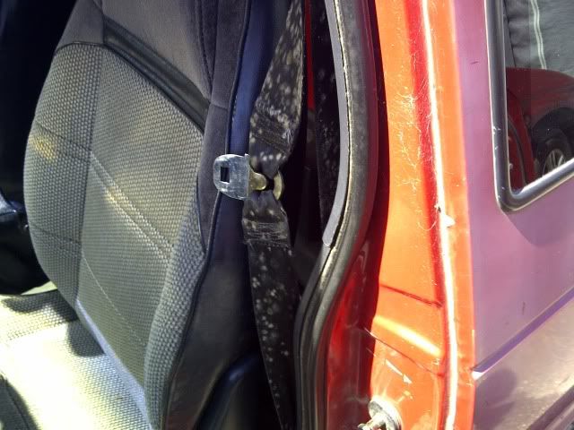

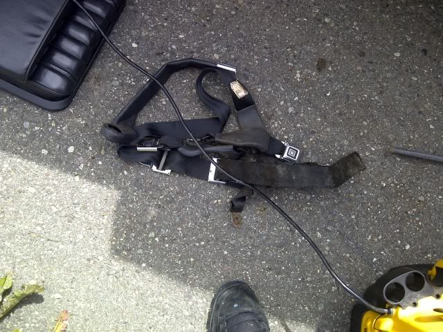

Interior is almost fully gutted.. Running into a few problems, got the passenger side belt off, however. The driver side, I haven't attempted due to the factor I do not want to strip the Torx head, or the bolt.
The rear jumper seats are a pain in the ass to try and take out..
Not the best of pictures..
Rust on the roof(inside under headliner)

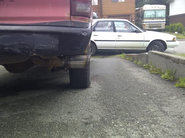

Crappy tire exhaust tip.. For that extra ricer touch..

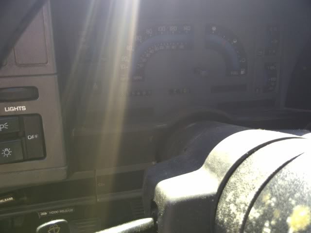

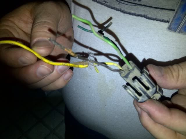

These two items(parking brake release cable, and air temperature control unit) are the two items keeping me from removing the dash completely.

the parking brake, look up under the dash, there will be a little notch that the cable slides into. youll see what i mean when you look underneath. and as far as the ac controls. that just slides off.

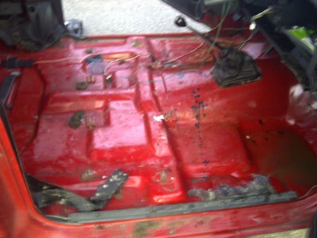

Thanks! I got it off, just need to remove the temperature control unit, and one more bolt to finally get the dash out.. However...
Rubber flooring is out. Tomorrow will be a strict cleaning of the floor.

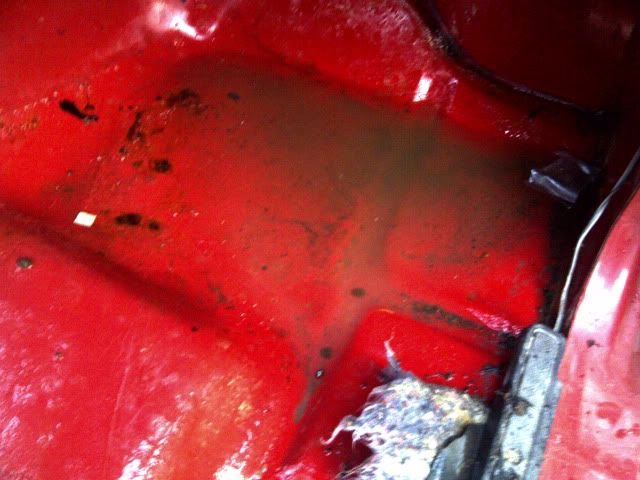

So happy that I do not have to replace the passenger side floor panel(the one with a puddle on it..)
Will have to see about the drivers side tomorrow though. See what is hiding under that dirt and crude.. Also, may have found some of the electrical problems also. Some wires are damaged, torn, split apart. Bulbs in the dash cluster are burned right out, so. All plastic parts are getting painted black, and the accents(minor) will be painted red/lighted red.

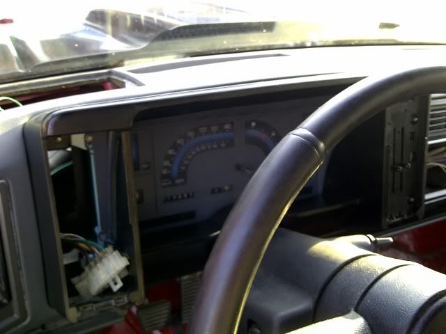

Only items in the interior needing to be removed are the following... Dash, Steering wheel, shifter boot and knob, passenger jump seat, both panels in the rear for the jump seats, seatbelt mechanisms' and the floor panel that goes next to the door.. Kick panel? Not sure.
Interior is almost done though! Need to get some more black paint though..

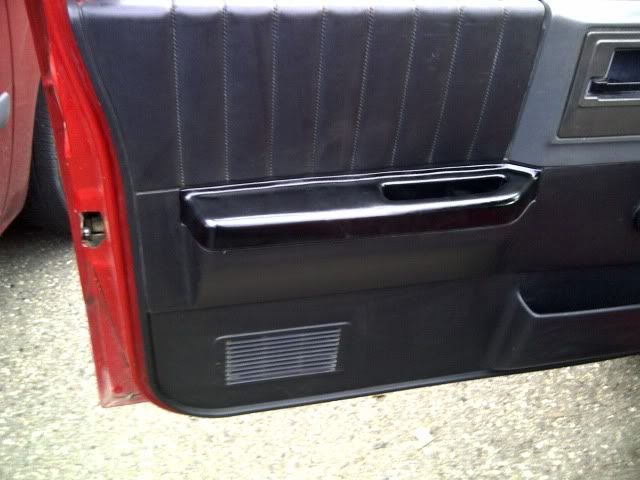

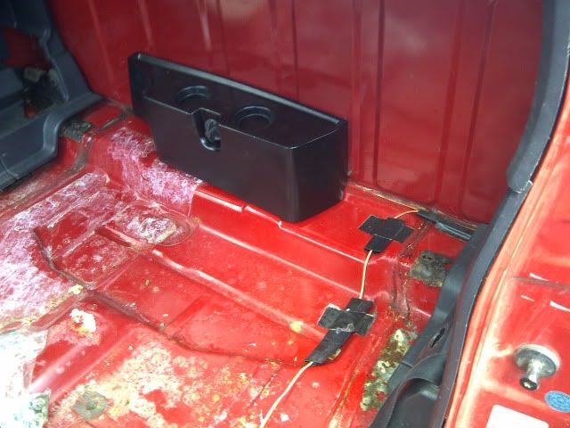

Well, I ran out of black paint and it started to rain, so I started putting the interior back together(main reason is my friend is wanting me to come and get her with her stuff and bring it back to this town.)
Interior is fully cleaned, just putting parts back in, need to replace the bulbs in my dash before I can officially drive at night though, and I must fix my wiper issue.

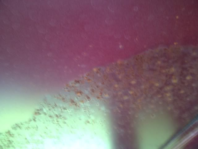

Damn spiders and their young!
Might need to replace unless I soak it in a bucket of 75 - 25 water/bleach.

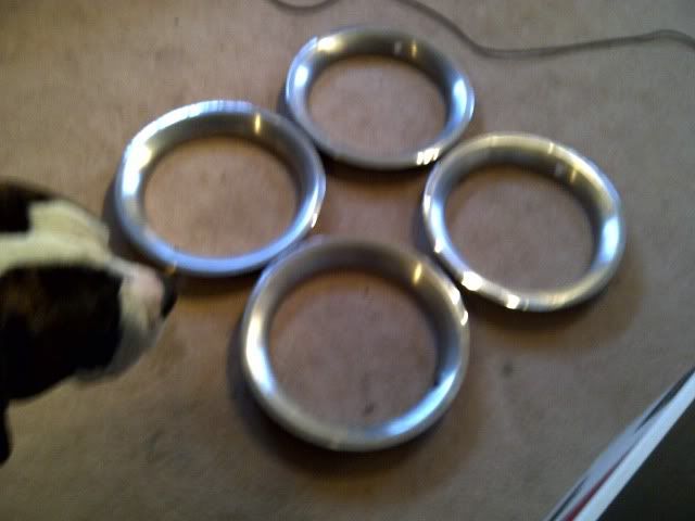

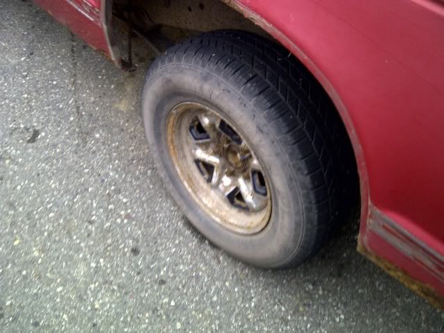

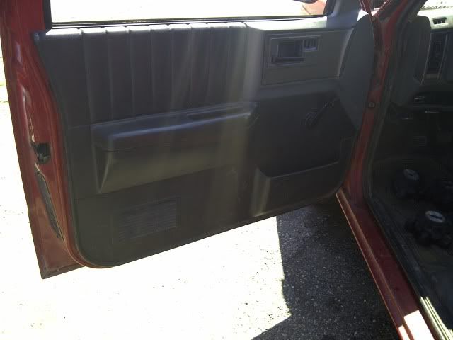

Picture dump...

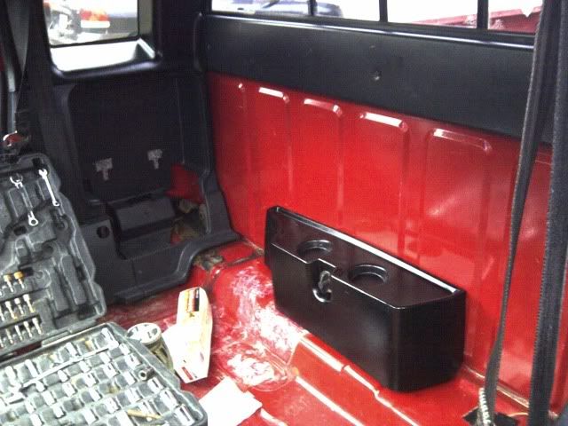

Minor update, but it's still progress from where I was before! When the rain was falling, I noticed that the windshield is leaking. Some black silicon will fix that, when I get to it of course..
Got the back plate put back on.
Starting to look like an interior again..
Still need to order in the floor. Other than that, I got the windstripping put back on correctly(previous owner had them backwards).
So odd, some black parts, some gray parts, something isn't right..
Bed o' garbage.
Rims.
Beauty rings.

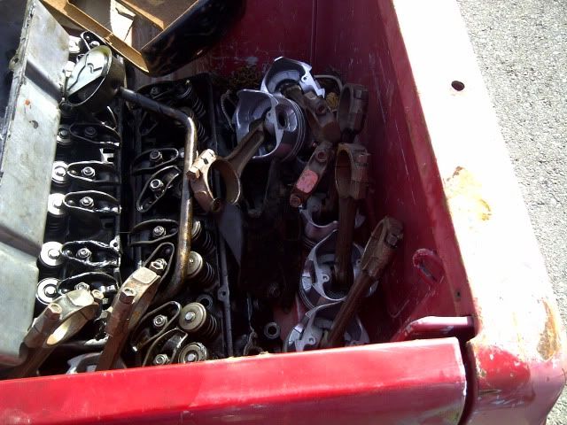

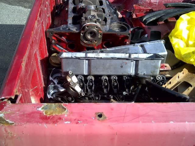

I found a fullsize 350, transmission and rear end for cheap in a used auto parts/junkyard of course, all in good condition. I will do a rebuild and conversion from TBI to Carburated on the engine. Rebuild the transmission, and rebuild the rear-end. I might also put in some better items for the two also.
Anyways, that is my picture-less update.. Just a thought on what to do first.

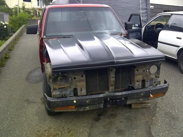

So. Found myself a 1994 Core support, and rear end out of a 4x4 Blazer. No need for a full size rear end. The rear end is for the 4.3L Vortec, I do believe it is.. 4.11:1?
Anyhow. I've had company over so I haven't really been doing much work on this. I've gotten the 2" cowl hood, waiting on fenders and driver side inner. Need doors. These ones are no where near being save-able.
Going to get Pete, to do the body work around my windshield for me, and cab corner on the passenger side.
Anyways, I've got a few pictures to share with the ladies and gentlemen of this site.

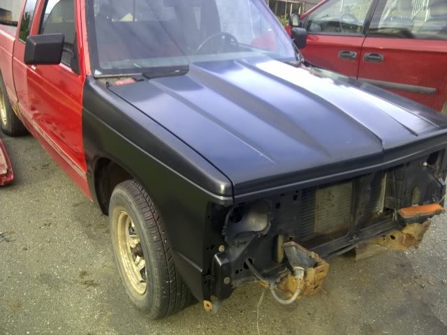

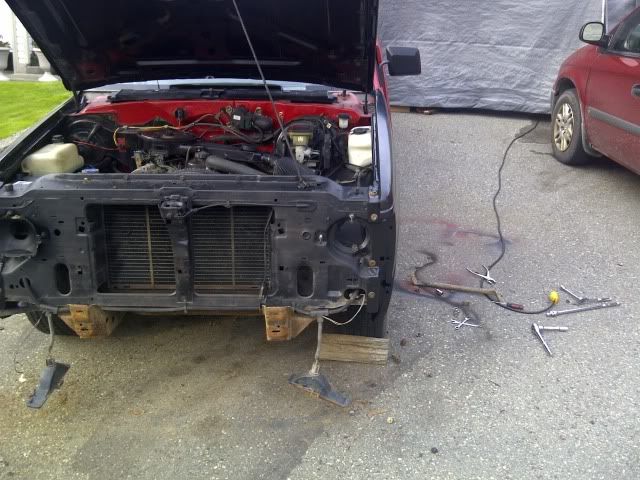

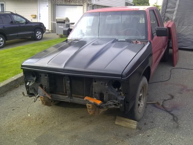

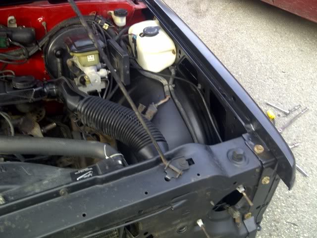

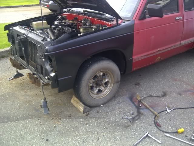

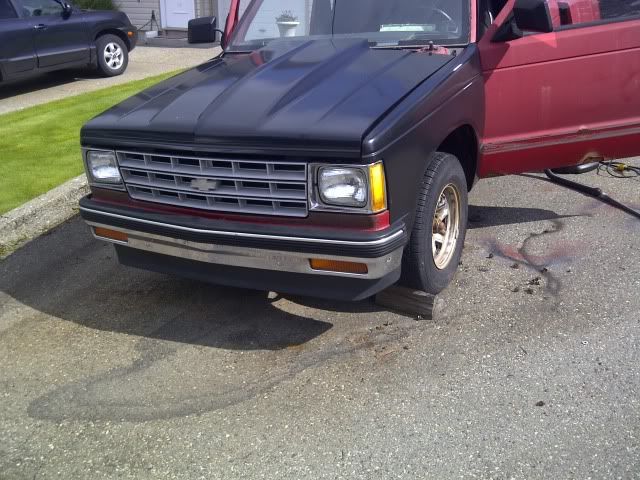

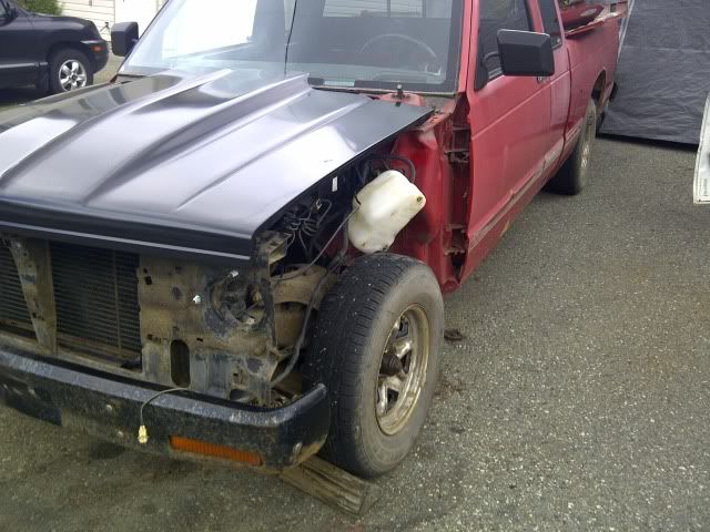

I've got an update! fenders came in, was able to save my inners(was quite pleased on that!)

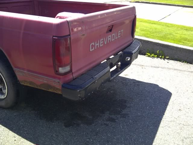

Going to trade bumpers with my dad(bought a new one and new lower air deflector)
Need to buy new bumper bolts though.
Anyhow... Onto the pictures!
And this is what happens when you are not safe with an 80g flap wheel on a grinder.

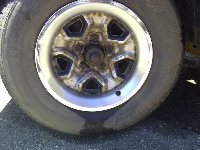

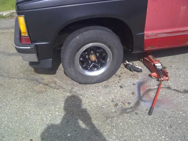

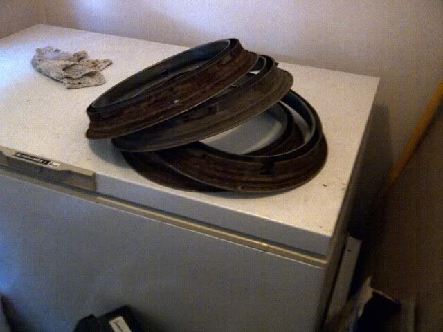

Well, the front end is close to being finished(body wise), need to fix the alignment on the fender(top front[hood] is too low, and bottom rear[door] is too high that it is hitting the door.)
Now, I know the rims need to be dealt with, I will get to it as soon as I get the drills battey charged up.(Have some wire wheels for the drill, just so I don't mess up my tires because they are still in reaaally good condition!)
Beauty rings are going to get polished up(only polished one and it looks a lot better!)

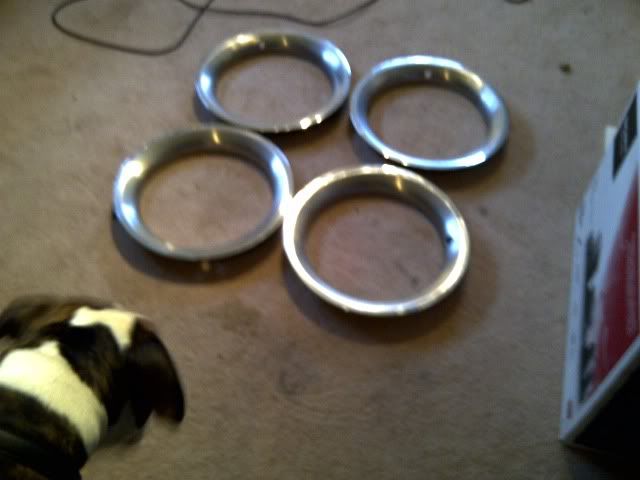

Beauty rings are all shined up. Need to wait until I can keep the rims up, and hit them with some paint to put them back on!

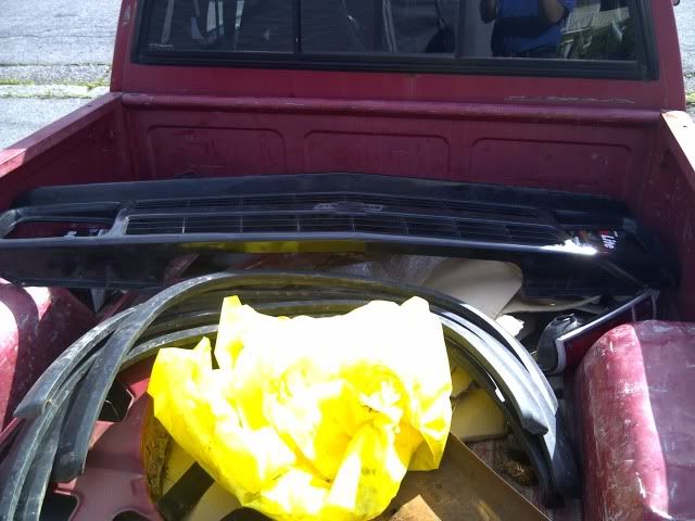

Re: [Project] 1989 Chevrolet S10.
I got a one piece grill for my truck!
Now, my question upon this one is.. Seeing as my truck is an 1989, with a 4-piece grill, do I have to change my core support to have my headlights center in the grill properly, or can I use my current one for the time being? I really want to get this truck out on the streets. So I can get rid of my Camry.
Old 07-28-2011, 11:22 PM   #29
First Gen FTW!
TN-Noma's Avatar
Join Date: Apr 2004
Posts: 1,687
Location: Fayetteville, TN
Yes you will need a 91-93 core support or headlight relocators.

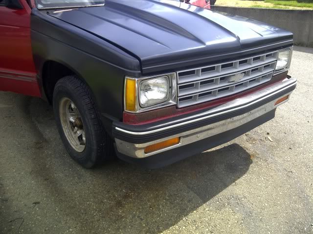

Going to run the 4-piece grille for the time being. Once I find my 91 core support, I will be changing over to the 1-piece grill.

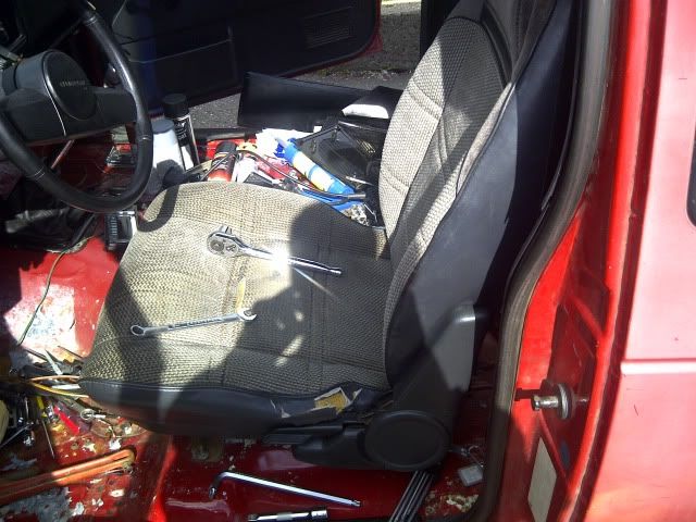

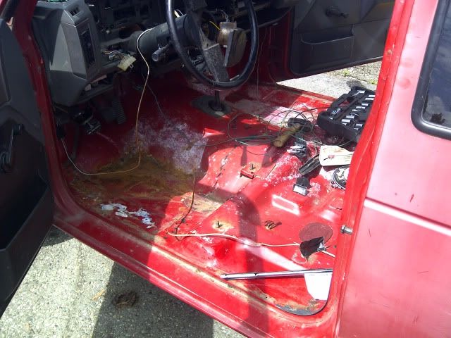

Was raining constantly, on and off all day today. Got a break at around 6pm, so I was working on the truck. The gap between the drivers door and fender is messed, I tighten down the bolt for the bottom of the fender, I can't open the door without having metal to metal contact. I wonder if I need to do some cutting to this fender, it all lines up correctly, the hood - fender gap is fixed and doesn't look like a valley.
Got the wiper motor off, waiting for the new one to get in.
Started to also put the interior back together, until I lost light. So, tomorrow I will hopefully have both seats cleaned up, epoxy all dried up on my light switch housing, and get the dash put back together. No carpet yet, still have yet to order it.
Will be driving the truck around with mis-matched paint colours in the interior(black, dark grey, and grey.. Nothing matches correctly.) no carpet, and a messed up box. The ol' 315K km 2.5L seems to still run pretty well(fired her up today, took awhile. No fuel in the carb.).
Pictures of said work to come tomorrow.
Have yet to put the bumper on, and cowl. Oh, and one trim for the passenger tail light.

Yes, running the 4-piece grill until I get myself a core support, and perhaps a chrome 91 1-piece. The black one I have needs some work done to it, might use it on another S10/Blazer(when I get another one..)
Chrome tail light trim(off a wrecked blazer), shined up beauty rings and gloss black(duplicolor) spray bomb paint on rims. Oh, and put the seats back in.

Quote: Originally Posted by Kiko
Love the hood.
Thanks man! I had a choice of 4 different hoods..
The one I have, 2" which I thought wouldn't of had the spine.($400.00)
2" without the spine, instead it had an inward spine($600.00)
Another 2" instead it didn't have the under-hood ribbing.(Damn near $1,000.00 for this hood.)
And a 4" cowl.($500.00)

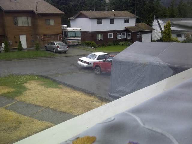

Painted the 4-piece to flow with the front clip(will all be painted red, and it will be a 1-piece instead of a 4-piece.)
I did not prep the 4-piece, I didn't even bother with sanding it/cleaning it properly. All I did was spray it with the hose..
The second pic is to show what I see out of my windshield, at my eye level, so the cowl is at a great height.
The first, well. Dash is coming back together..

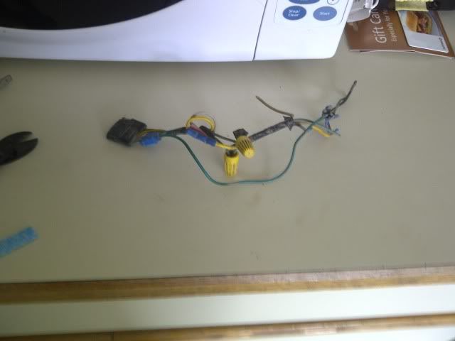

Quote: Originally Posted by Blade.
Previous owner, wired in trailer light harness.
He wired it into the main light wiring harness, and to which he did not do it correctly, nor did he properly cover the wires. The wires were in-fact ONLY covered by black electrical tape, and duct-tape. It has now been fixed properly, using solder, double walled heat shrink, and black electrical tape over that.
As you can see, the trailer harness itself has, yes, house hold electrical end caps on it.
Found in 'most hacked/ugly thread'(above).
Still didn't fix my light problem. Will be replacing my flasher, and other items for the lights.

Take a wild guess on how much the 350, heads, covers, and pistons ran me.

Well, first thing is first, have to get it machined, and have the crank turned. I'm going to look into how much a crate will cost me, as I am looking at around, estimated $2,000.00 in machining alone.
So, with that being said. I might just use this one as a spare, if a crate costs less.
Yet, what I want to do is..
Aluminum heads, 650 CFM carb. square bore, 4-barrel. long tube headers, 2.5" pipes, nothing serious really. It'll move with a stock 350, however I would like to have atleast 350HP. Well, anything more than 300.
Need a rear end, transmission(want a 6-speed if standard, 5-speed if automatic.. Really want to go with a standard though.), 4-link, coil overs(front and rear), 2" drop spindals, bigger brakes(4-wheel disc.)[how big can I go with using stock rims??], fatter rear tires, battery re-location kit, fuel regulator, rad., electric fans, MSD ignition parts, frame items(needle gun her, flap wheel her, box it in, paint it.), bushings, fuel lines, brake lines, mechanical oil gauge, mechanical fuel gauge, mechanical water gauge, mechanical speedometer, etc.
