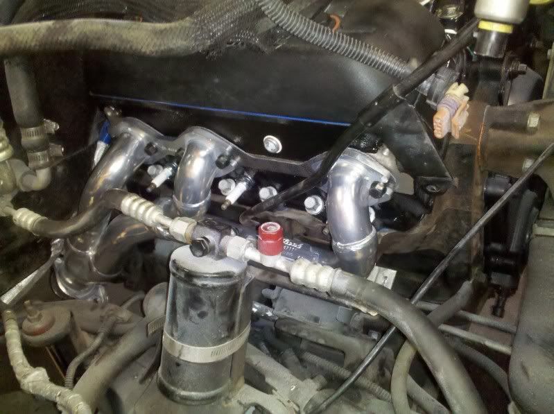

well shit lol
finished the exhaust
some new fall pic's
Old 01-25-2012, 10:51 PM   #55
Mikz86TA's Avatar
Posts: 2,782
Location: Tallahassee, Florida
Re: my 4.3 cam/intake/head build
Tight fit.
Which muffler?
Sound clip?

flowmaster 40 old school
and click on the first pic its a video i dont have any of it on the road yet.

Sounds mean! I had a Super40 but the inside resonance I got tired of. Got a MaxFlow Hooker now. Im not sure I like it tht much.
Old 01-27-2012, 11:24 AM   #60
Mikz86TA's Avatar
Posts: 2,782
Oh and ur running a cat.
I got those same headers, no cat and the Hooker.
Im sure the cam makes a big sound difference too. So did the heads have to be machined at the guides for the lift on the 270 cam?
What did he do to the tune to get the idle smooth and whats the AFR?

yea i have to have a cat here because we have to meet emissions inspections, it's tuned out but is there lol. and you dont have the machine the head at all to run this cam i have, you can run the comp-cams push tubes: 7808-12, comp-cams 787 retainers, comp-cams locks: dont rember the part number but they are 7 degs, and ls6 springs. you dont even have to pull the heads but i did so they could be worked, and different valves were installed, and i dont know on the tune, my buddy builds ls motors for a corvette racing and other other large race groups so he knows his shit, in that video it was just a safe tune so i could work all the bugs out. right now i am driveing at about 14.3 afr and WOT at about 12.5 afr but he was playing it safe till we dyno it, i have been staying out the throttle because it's running so rich. he did a little playing around on it the other day when we were doing data logging on the street and now my idle is at 575 and it sounds mean lol
