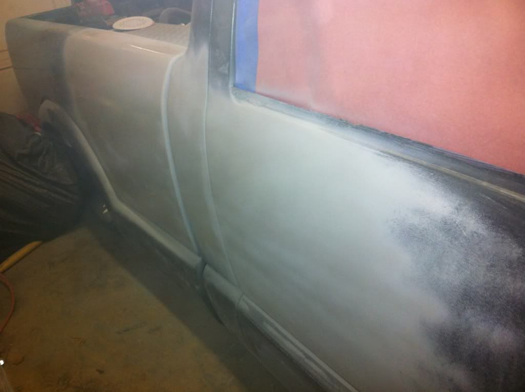

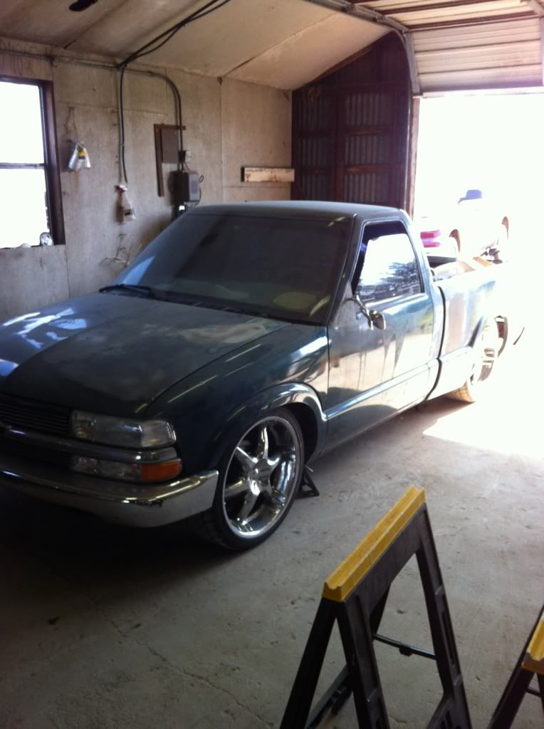

Did a little work on the pass side tonight getting ready for lst

post #104 of 152 Old 02-17-2012, 12:12 AM
I SHIT BRICKS
OneLowSdime's Avatar
Location: Oshkosh WI 54901
Posts: 6,080
User is: OneLowSdime is offline
Send a message via AIM to OneLowSdime Send a message via Yahoo to OneLowSdime
Re: greendime
lookin good bro!

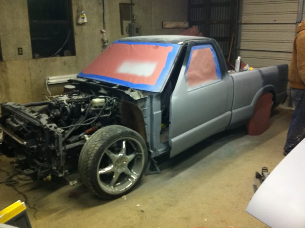

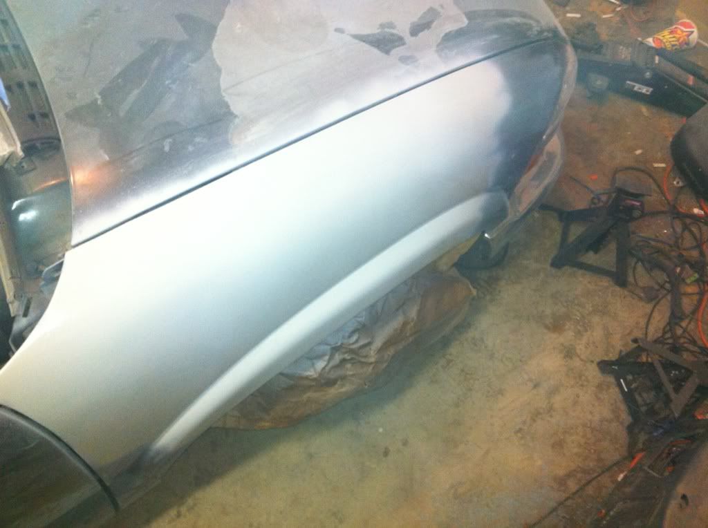

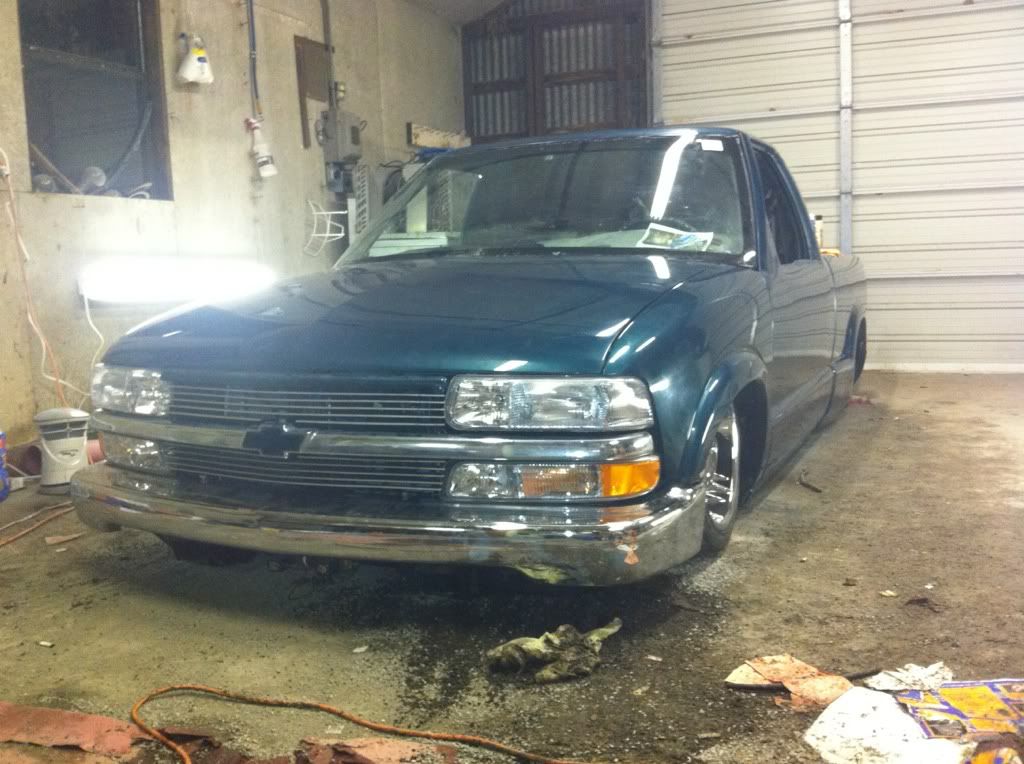

Well got all the paint stripper spots worked out this week and first time to spray primer with a real paint gun going to take it to LST this way, this weekend

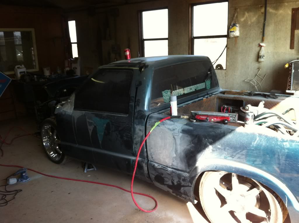

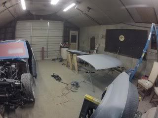

Some pro 2 camera pics my buddy emailed me

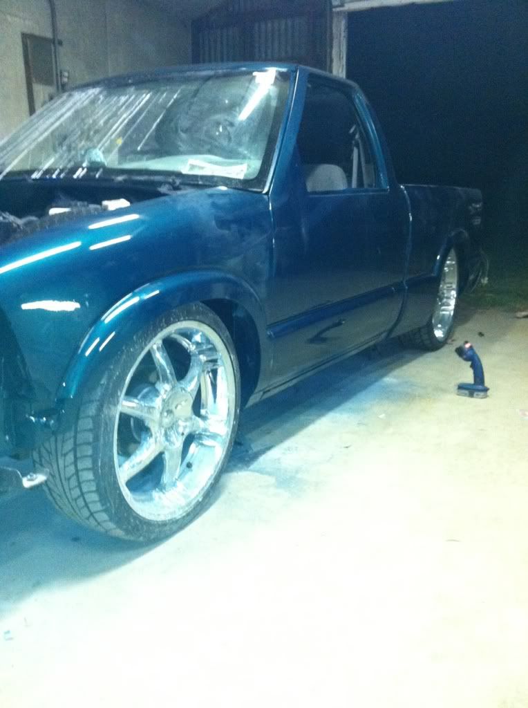

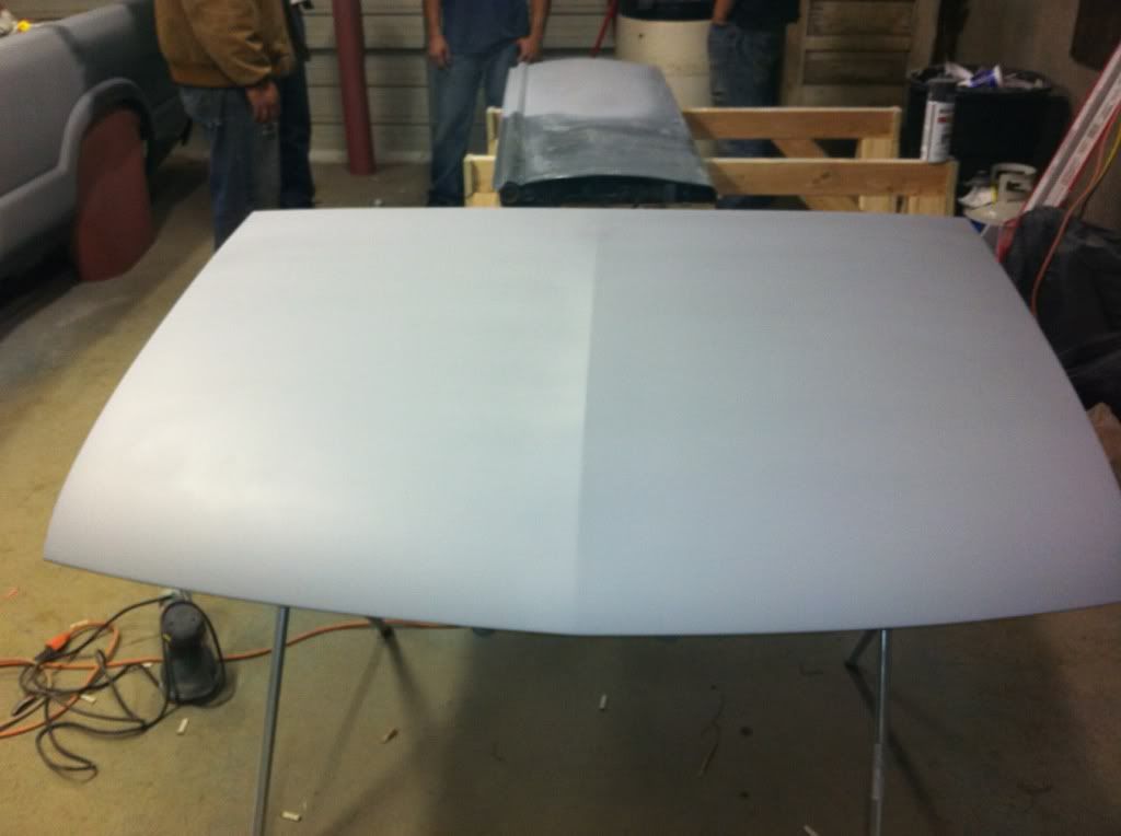

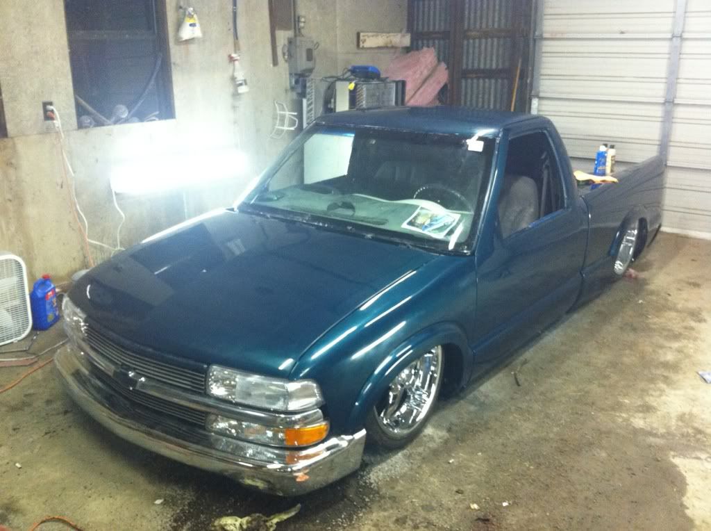

Well my first time doing body work and paint didn't turn out to bad bed liner Tom

Nice work man. Like the color

Thanks man I kinda do to lol. I guess hints the screen name lo

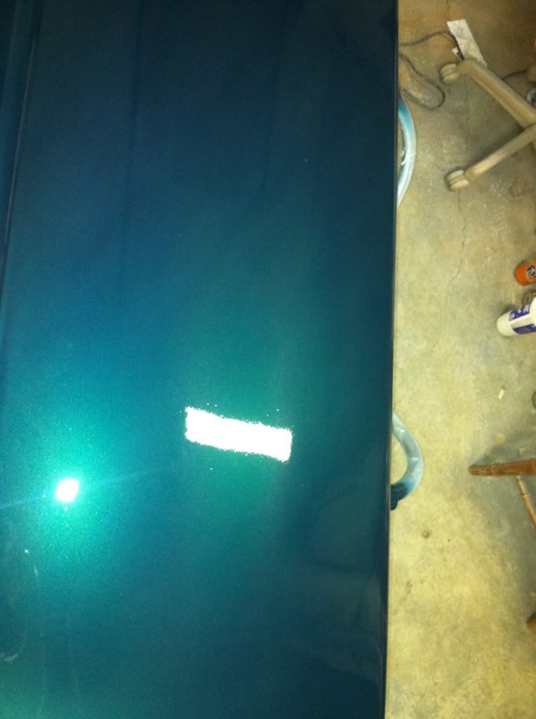

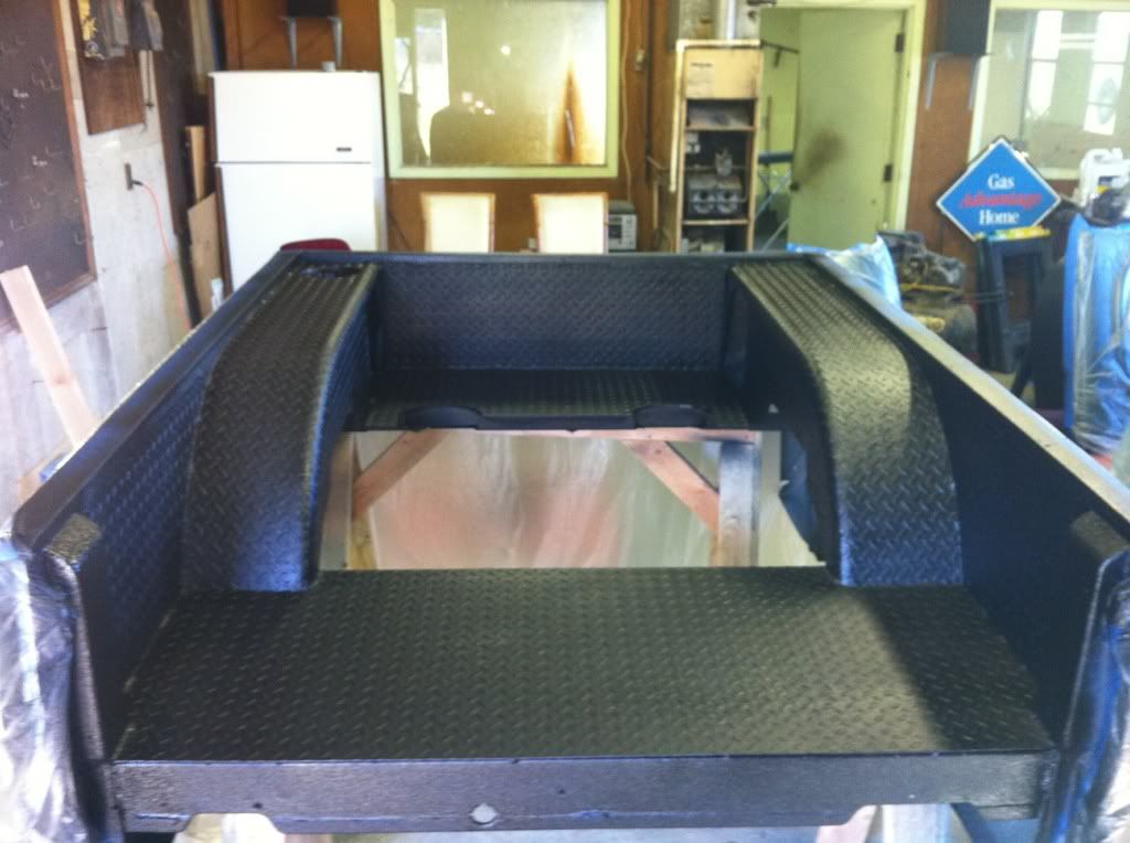

Bedliner
Sand and buff tom

awesome build
Severed TIES <> Ohio | R.I.P. Fred Browne '80-'06 | R.I.P. Grant '82-'02 | R.I.P "Loenuff" '66-'07 | R.I.P. Terryl '57 -'09

Originally Posted by droppedss View Post
awesome build
Thank u sir she's my baby trying to get ready for kicker bash 2012

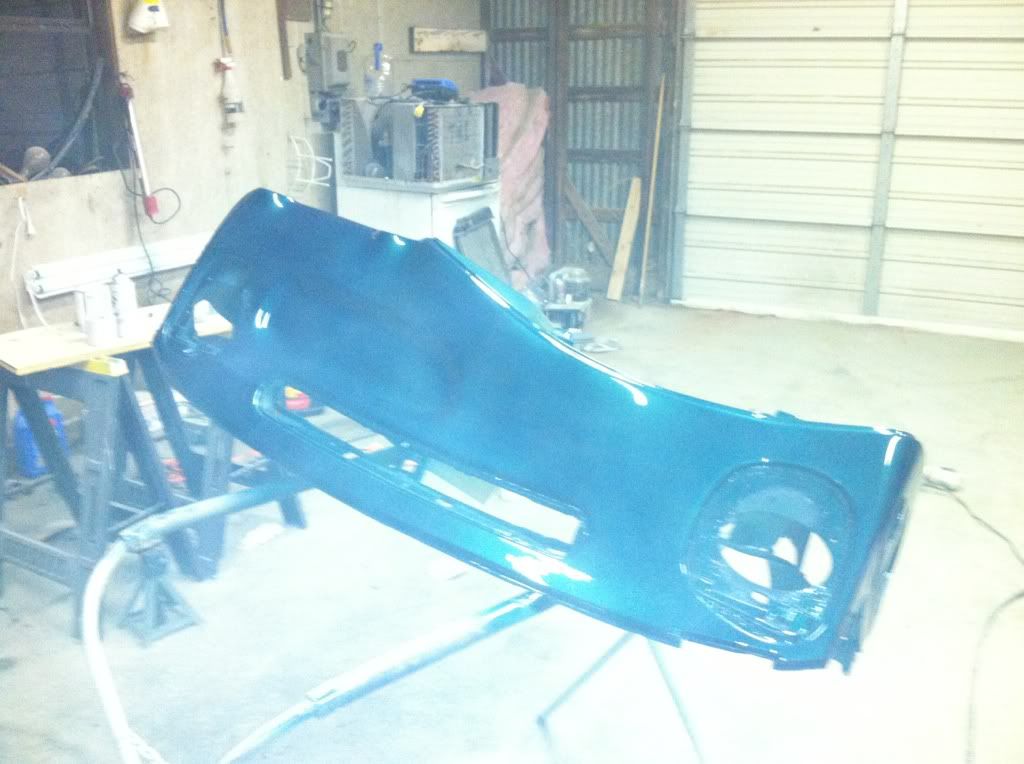

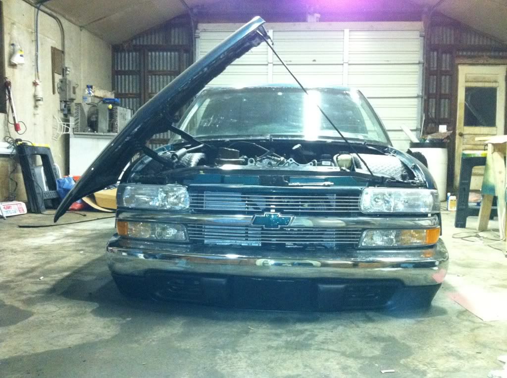

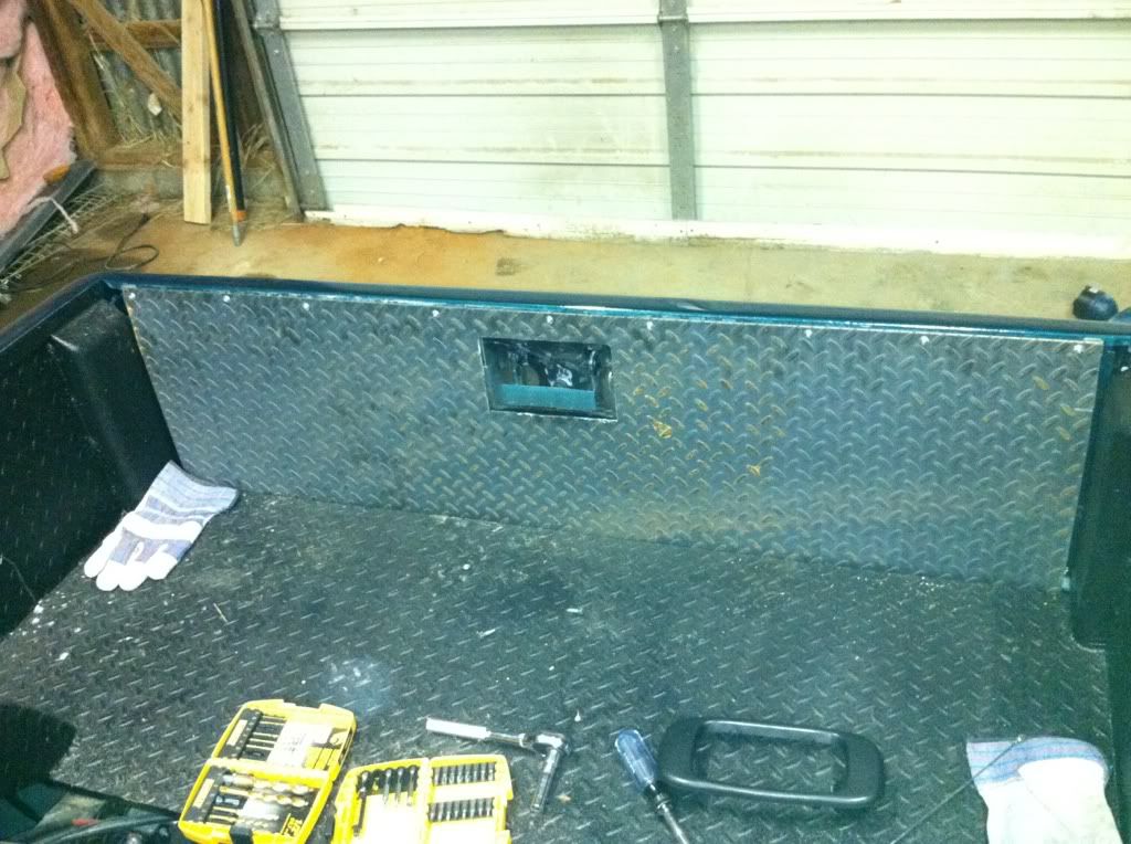

Finally put a new lower valance on

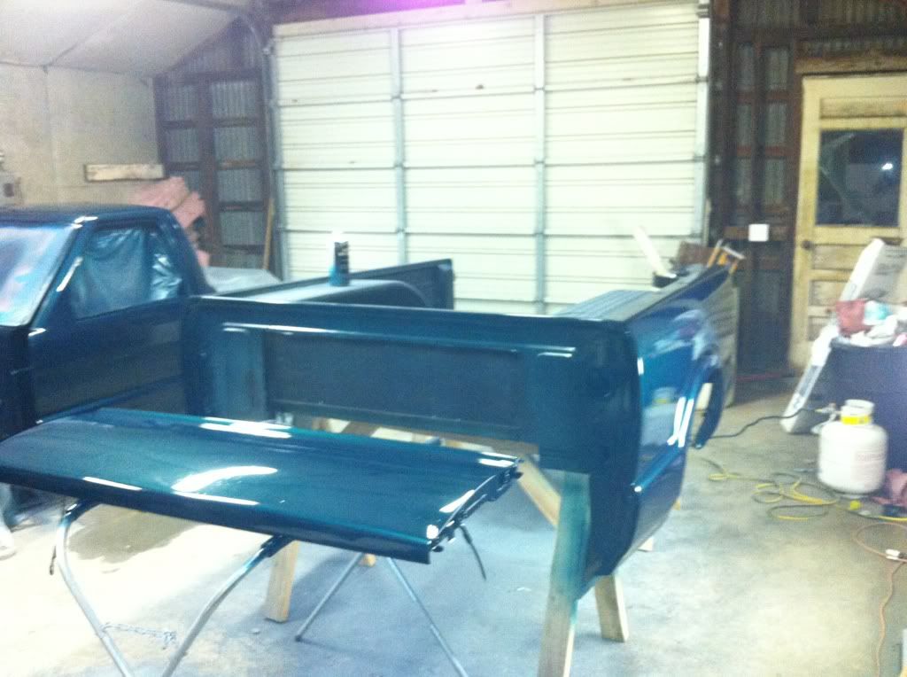

Skinned the tailgate need bezel and bedliner

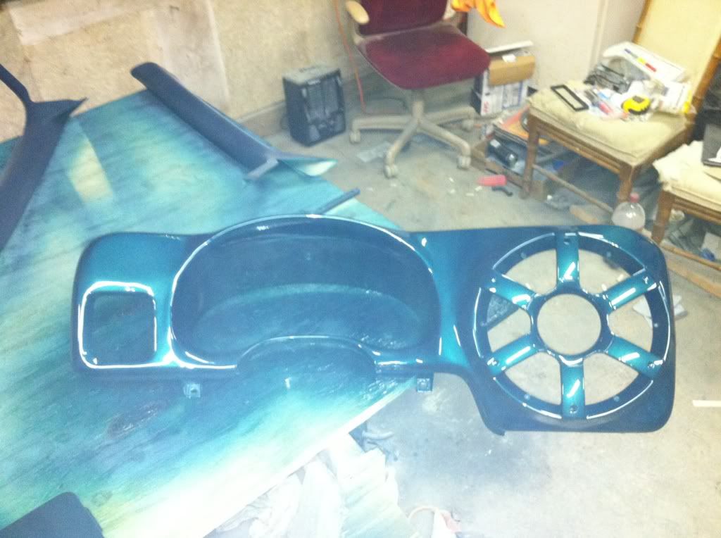

Looking good. What's your process on the dash? I need to do mine because it is cracked from when I pulled it to due it.
Z06killinsbf is offline
post #130 of 152 Old 03-19-2012, 12:50 AM Thread Starter
greendime's Avatar
Join Date: Jun 2003
Location: norman oklahoma
Posts: 180
User is: greendime is offline
Re: greendime
Thanks, I just sanded it with some 220 cleaned it with an automotive wax remover degreaser than an adheasion promoter, about 4 coats of filler primer sanded the texture out with 220 than wetsanded with 400 than shot it.
And fixed any broke or cracked spot with bondo glass filler cause it's stronger I had a few spots cause I threw my original out a long time ago and had 10 mins to get one at pull a part before they closed

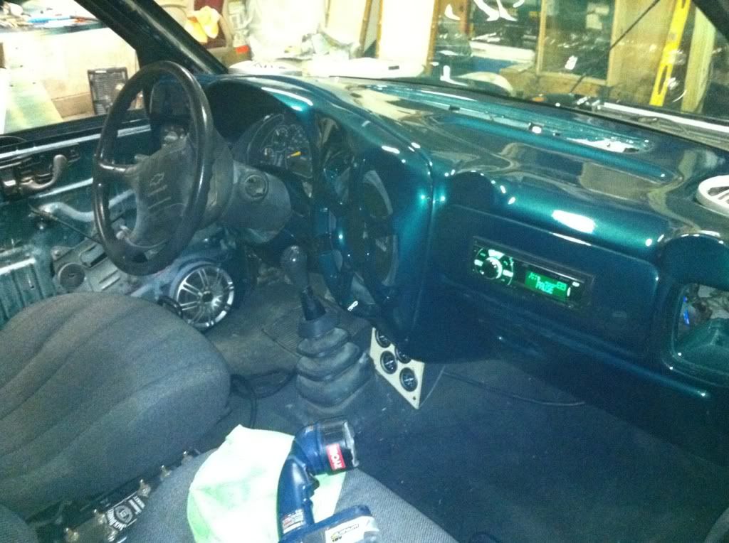

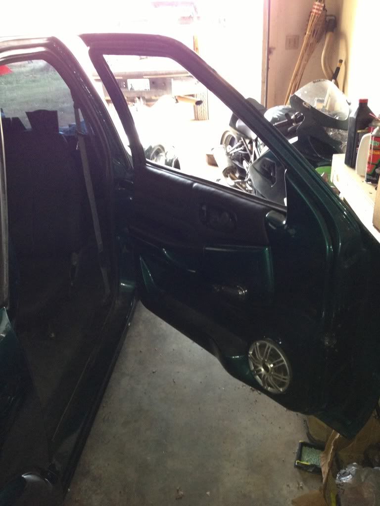

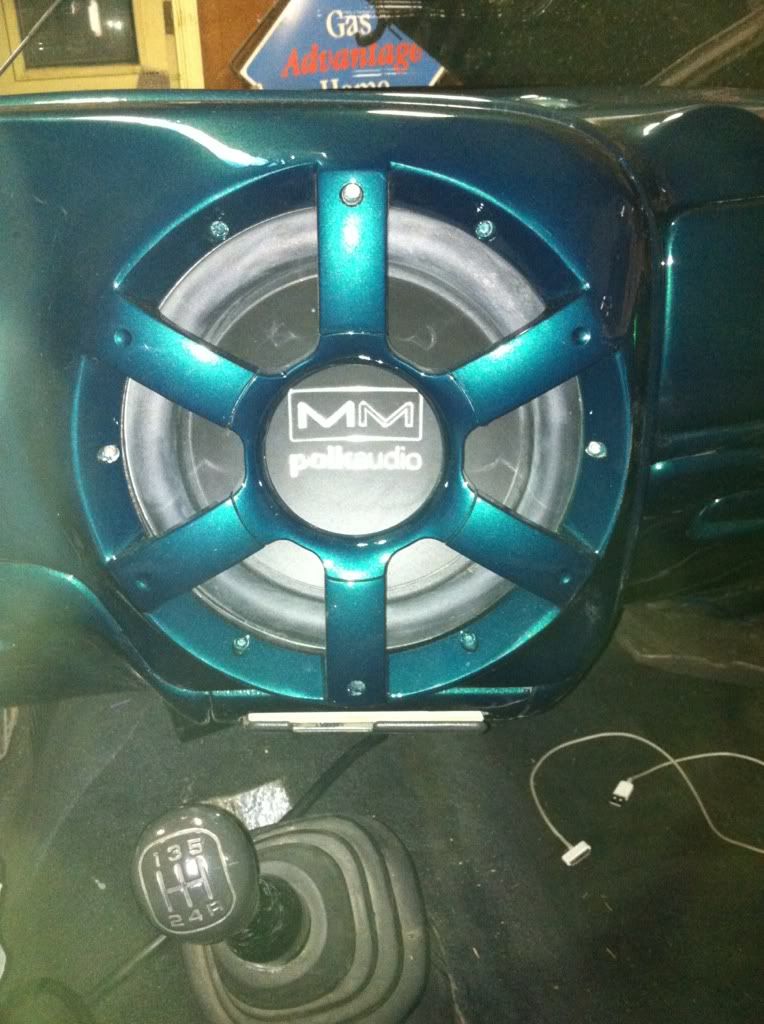

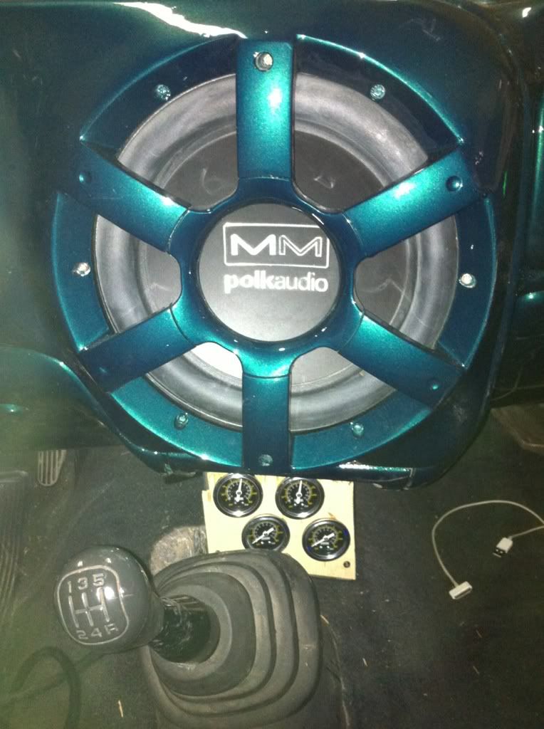

Dash in
Gauges where ashtray was

Looking good. Sub in the dash is something I have not seen before.
ridinlow is offline
post #135 of 152 Old 03-22-2012, 02:27 PM Thread Starter
greendime's Avatar
Join Date: Jun 2003
Posts: 180
Re: greendime
Thank u sir yeah everyone does a double din or a 10" monitor I said screw 10"sub will work. The box was a tight fit but worked and sounds great pretty sure I spent two hours sitting in it ( it was raining out) and just listen to it.

Interesting build, I like it. How is the sub box mounted? I like the look but am curious as to the sound. Also, just noticed you're in Norman. I'm just north of you in Moore haha. Love the truck man!
93_Blaze is offline
post #142 of 152 Old 06-05-2012, 10:33 PM Thread Starter
greendime's Avatar
Join Date: Jun 2003
Posts: 180
Re: greendime
The sub has a box behind it it's .74 cubic feet not super loud but does sound good yeah I'm in Norman out by dirty bird
