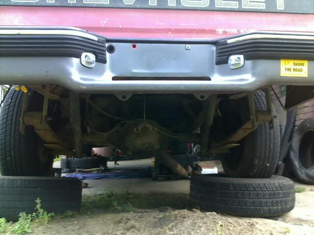

I've never seen adjustable shackles on a first gen..?

Those looks like home-aid shackles...good start tho!

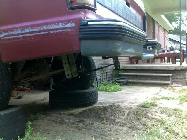

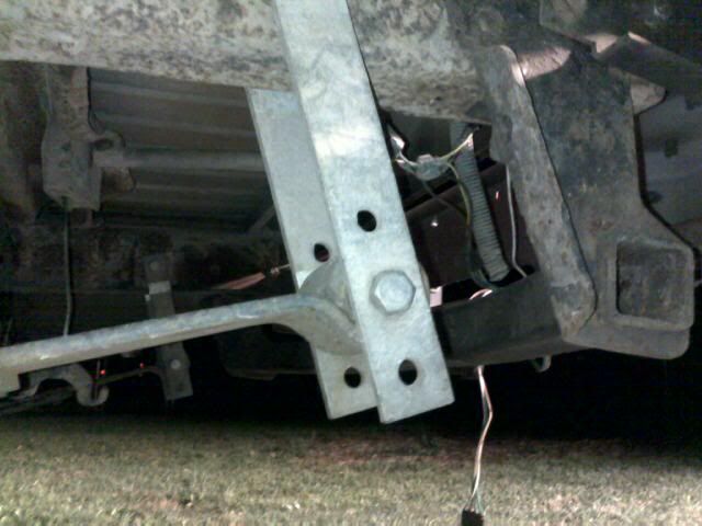

Got this over the weekend and i thought it would be funny. Can't see it on the back,cause of the tint,so for now it's on the front.
Wtf is this on the coils??
Random shots after replacing 3 of the rims/tires with my old stocks,and washing thoroughly

thats a 'lift' aid, basically the WRONG way to get some lift from sagging springs, they ultimately bend the spring, which looks to have happened, so plan on some new springs for that while you are at it. I have a set of springs in my basement you can have for the cost of shipping if you want, they were from my old truck, they are z85s (heavy duty) and were removed at around 88kmi

Thats ok. If i have to pull the coils,i'm going to go ahead and buy a set of lift coils that i've been wanting. I can kill two birds with one stone.

huh. never seen that before. Im digging the adjustable shackles though thats a good idea.

the shackles are a bit shady too, you can pick em up at any parts store, but theyre just two flat plates with nothing holding the two together in shear, which may cause unwanted side to side movement, abnormal bushing wear, etc, id swap them out for a stock set or aftermarket lift shackles

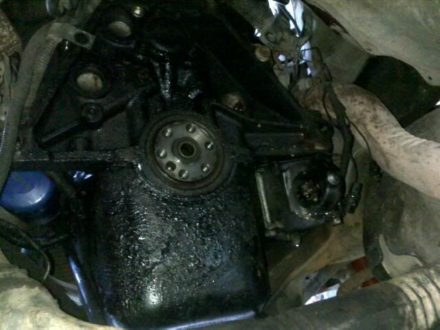

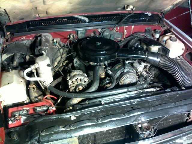

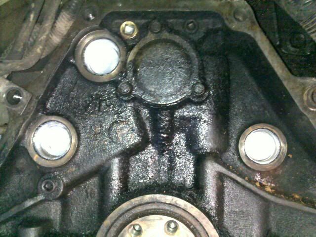

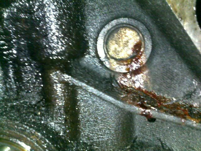

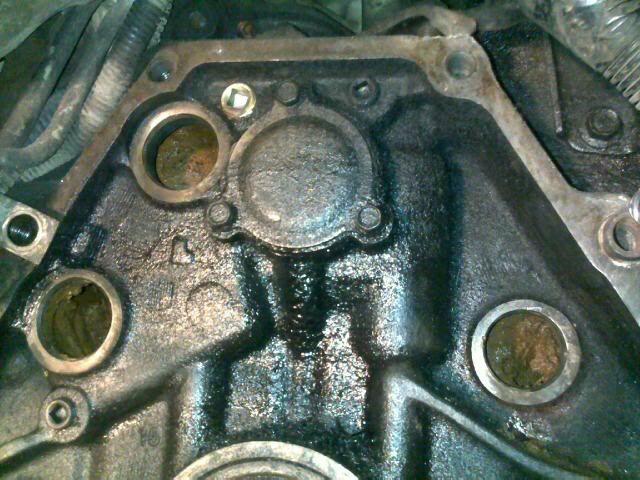

Fixed a leaky radiator cap,but i'm leaking coolant from somewhere around the rear of the engine. I can see it dripping. I looked for a few minutes,but was in church clothes so i couldnt get too into it. Hopefully i'll figure it out tuesday. Any ideas? I can see it dripping by the starter.

Heater core? running down the firewall?

I kneeled down and looked under the truck,and it looked like it was running down the engine where it bolts to the trans.

lol ya man someone already lifted that thing. those are spring spreaders to lift the front like someone else already mentioned. The shackles are advanced auto parts special, $15 jobbers. They are really weak, because they don't have a cross brace. You might look into getting a better set.
EDIT: Driveway Kustoms hit the nail on the head already, guess I shoulda read the whole thread before I posted

Those are some sketchy ass lifts man, get lift shackles, add a leaf, and get lift coils. done. Love the steelies you posted in the first post, are they 15x8? should look great if they're an aggressive offset!

Thought about that earlier. Gonna check today

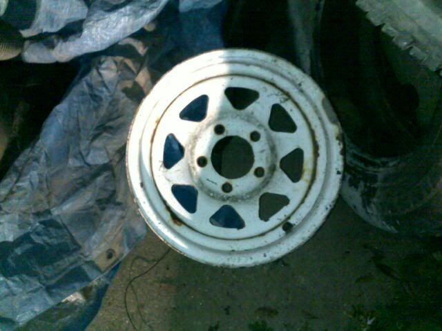

I thought about that, my bagged truck has the plastic on top,but no plastic strips on the backside. I like that,but on this truck i'm not terribly picky. I kinda like the bumper that's on it now,but i thought about painting it black.
Once i fix the coolant leak,i'm going to try and pick up a set of 15" steel rims from the u-pull it,along with a set of black flares like i put on my '91. I'm anxious to get started,but not doing anything until it's actually driveable.

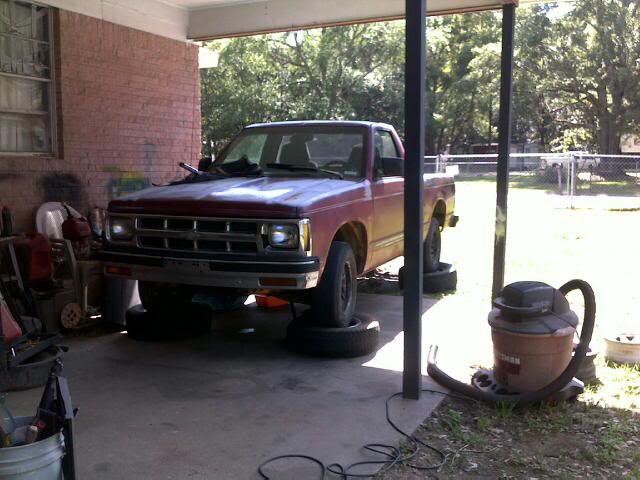

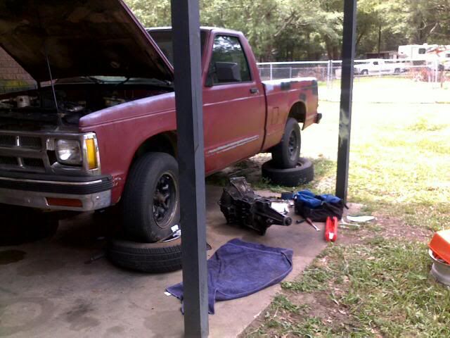

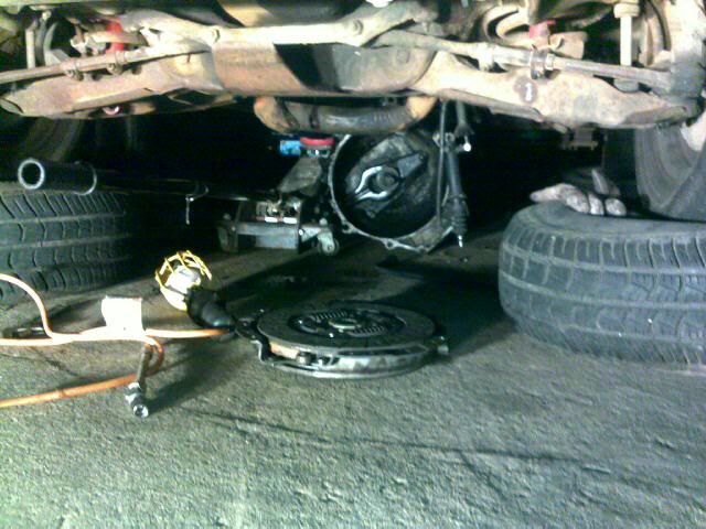

Pulled the slave cylinder,driveshaft,muffler,and drained the transmission. I need to unbolt the y-pipe,remove the crossmember,then unbolt the transmission & clutch/flywheel. I'm headed now to pick up 2 new freeze plugs. Should solve my problem with leaking coolant.
How it's gonna sit for the next couple weeks

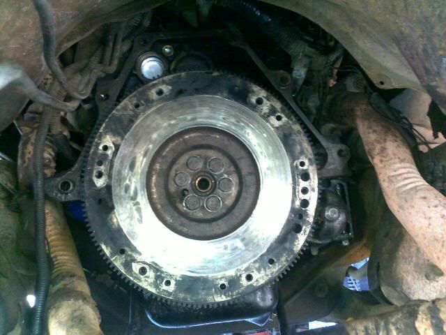

I finally figured out a way to get enough room to reach the top two transmission bolts and..... It's out. I got stopped by the flywheel though. It wanted to spin the crankshaft and i had no-one to help keep it still while i loosened the bolts. I'll most likely do that tommorow afternoon before heading home.
Hopefully once these freezeplugs are in,it will stop leaking and overheating. I'm ready to drive this mofo

Re: Going up?
Why not just use an impact to remove, and re install the fly wheel?
Shouldn't need anyone to hold the crank with an impact haha.

If i had a good one,that would be nice. I got it off this morning,and next time i've over i'll replace the plugs and put it all back together.

by the look of it I would suggest replacing the Rear main Seal if its easy while you are there

glad you found the source of the leak, definitely better to catch that now than later when it blows out and soaks your clutch or something. doesn't look too bad to replace

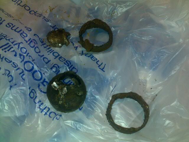

Got the old freezeplugs out. The leaking one actually had a nice sized hole through it. Gotta wire brush the inside of the holes,then get the 3rd plug + some sealant and press them in tommorow. Should be ready for the road shortly.

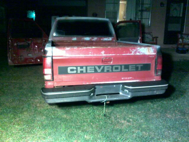

No more ugly hitch reciever & trailer wiring harness

All 3 freezeplugs are done.

I was just looking through your thread here, I like it. As for shackles, those look a little janky to me bro. I picked up new beefy, and I mean you could kill the fat guy next door BEEFY shackles on Ebay for 39 bucks shipped

I will get to replacing them shortly. Just havent had the funds.

All i pretty much do are square bodies. I would like to add a 2 door blazer to my collection,and a chevy luv.
How my day started
How it ended
Cranked it up and didnt see any leakage. I need to get a couple quarts of transmission fluid to replace the old fluid that i drained,but otherwise it's done. Now i need to thoroughly test drive it,then get my title/tag done so i can daily drive this one instead of the bagged s10.
